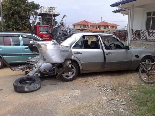

NEVER LAY AN ACETYLENE TANK HORIZONTAL. EVER!!!!
This is what happens:
from: http://slcfireinvestigation.com/?page_id=2
from: http://abdmalik.net46.net/2008/07/th...n-in-malaysia/
If you don't know how acetylene tanks work, you've got no business owning them.
Read this: http://www.airproducts.com/nr/rdonly...fetygram13.pdf
Acetylene tanks have a porous sponge like material in them, filled with acetone. Acetylene is VERY unstable at atmospheric pressures. The acetone helps dissolve the acetylene and stabilize it while under pressure. If you lay the tank on its side, the acetone flows to the valve, dissolves the seals, and acetylene leaks out - and explodes very violently. Thats the pictures you see above.
