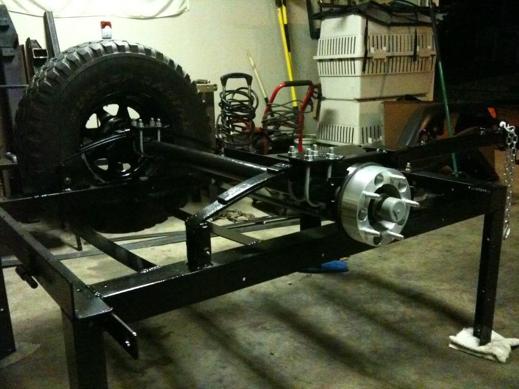

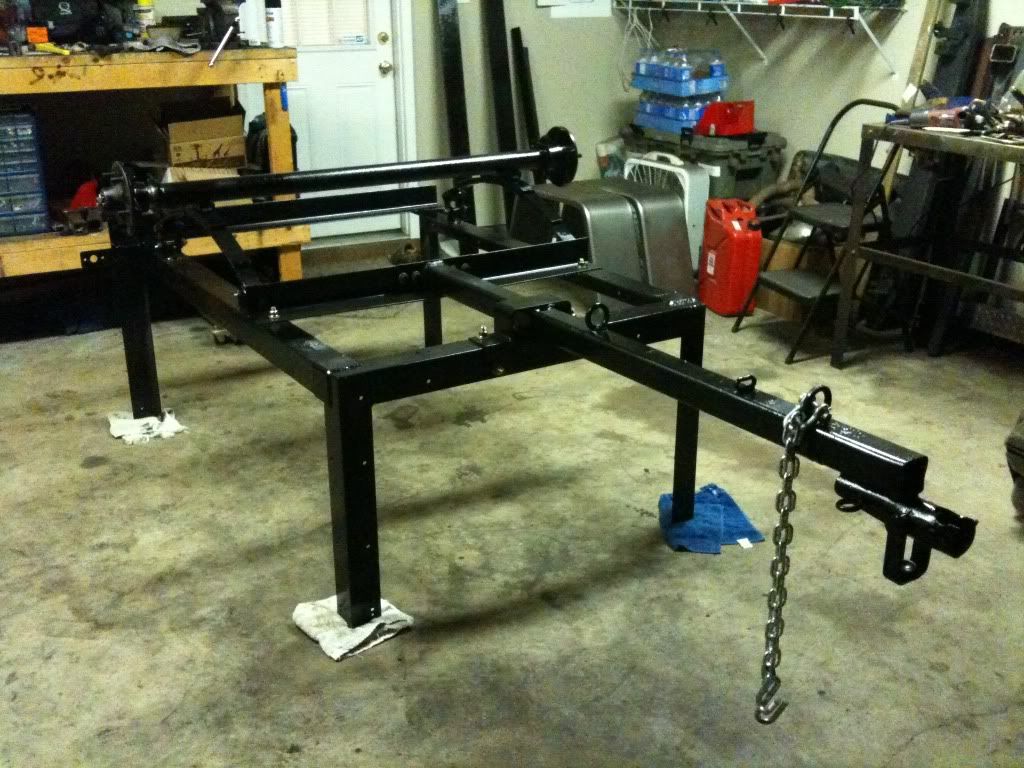

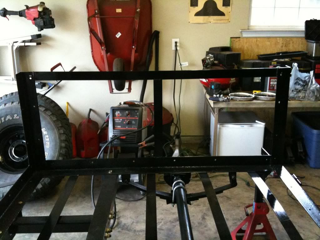

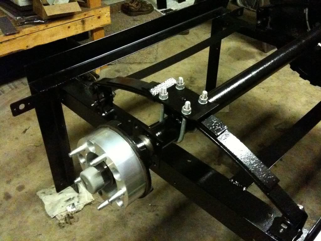

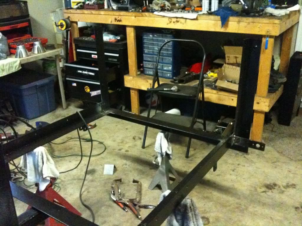

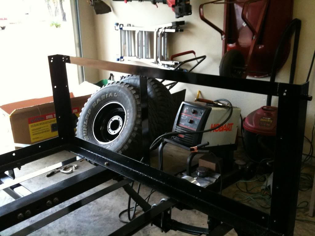

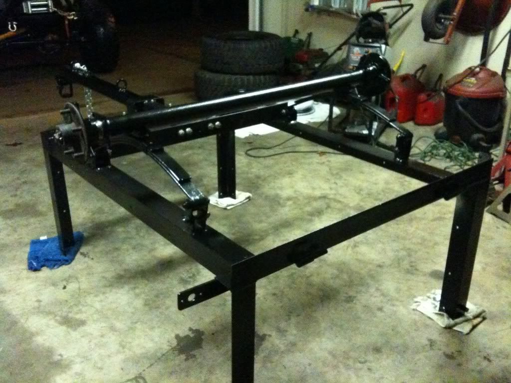

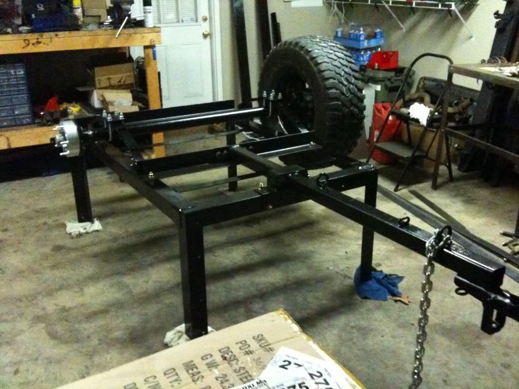

More progress:
Welded the rear face on:
Flipped it to weld in the front "patches." The patches arent the only thing holding the front face on but it seemed sill not to have it attached there. I needed the scrap because there was a gap between the side rail and front face.
Put the axle up on top to make putting the hubs back on easier. Its actually sprung under so its just sitting there right now. I did end up replacing all the bearings and seals.
If my wheel spacers ever get here Ill be able to flip it back over and start adding in some flat stock to brace the wood planks.
What do you guys think about stock TJ shocks? Ive got some extra from my jeep. You think theyd be too much for this light trailer? And Dave, youre right, those 3 leafs are too much. I has trying to bounce on the axle and it wouldnt budge. I dont weigh that much but it should have moved a little. I was thinking of going down to 1 leaf and adding the Jeep shocks.

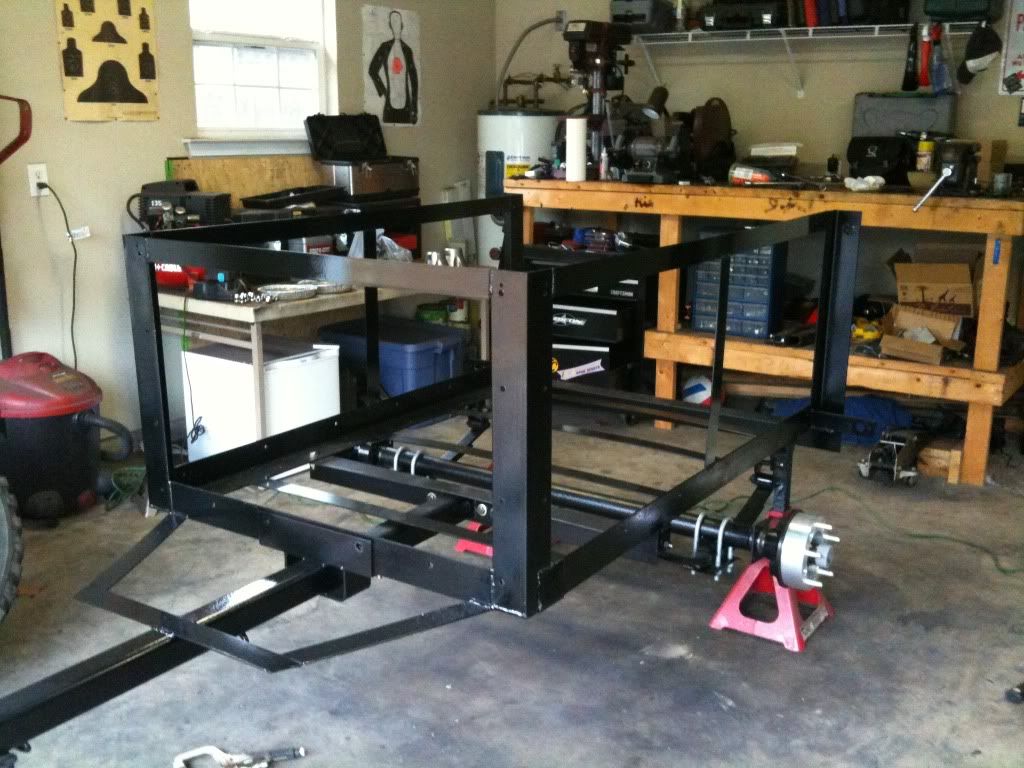

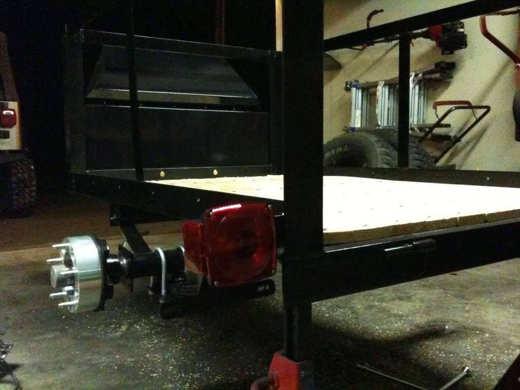

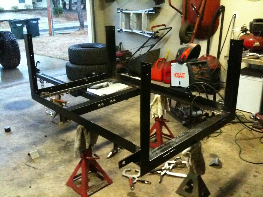

Heres a few more pics. Got the hubs finished and wheel spacers on also welded some slats across the "bed" as supports. Ive got today off and I plan on making a frame and mount for the tongue box, weld in some slats for support on the sides and possibly starting to put the wood in. Not sure though, its nasty cold and raining today, dont know if Ill make it out to Lowes.

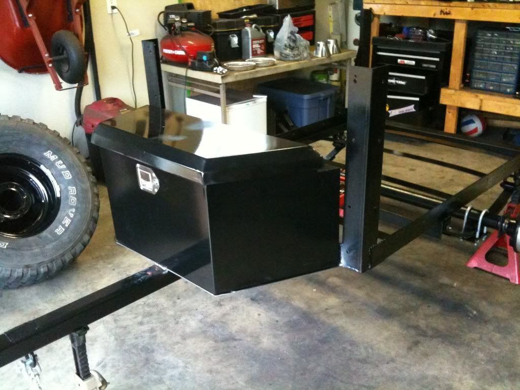

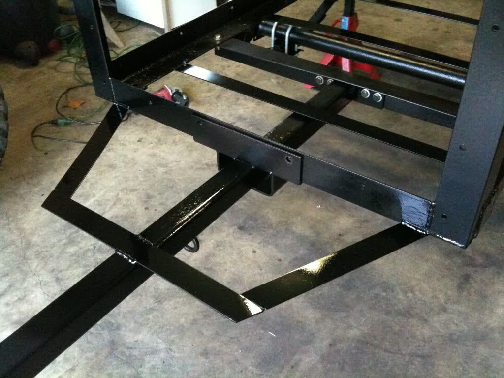

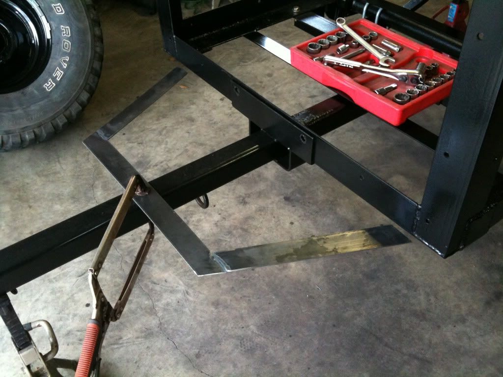

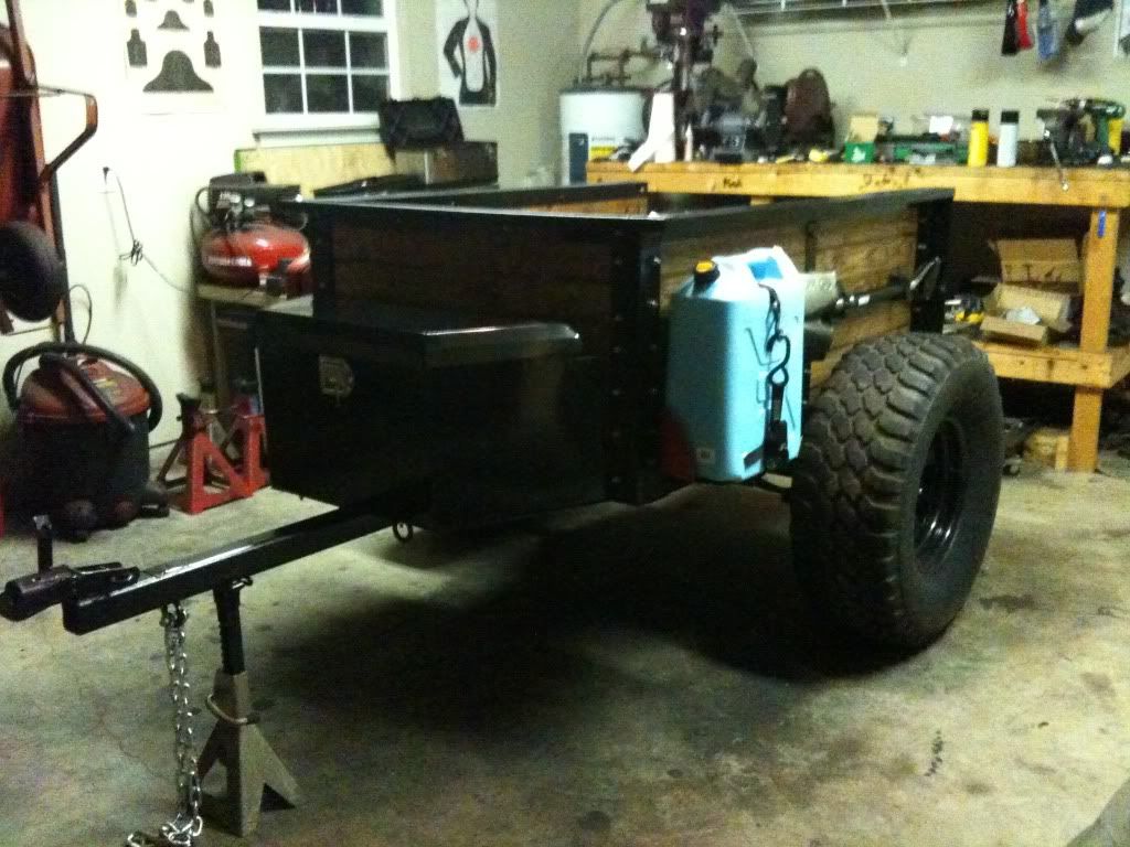

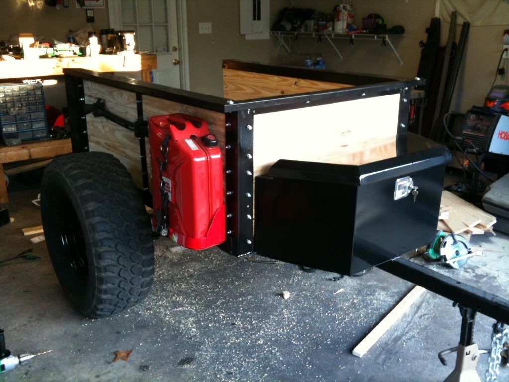

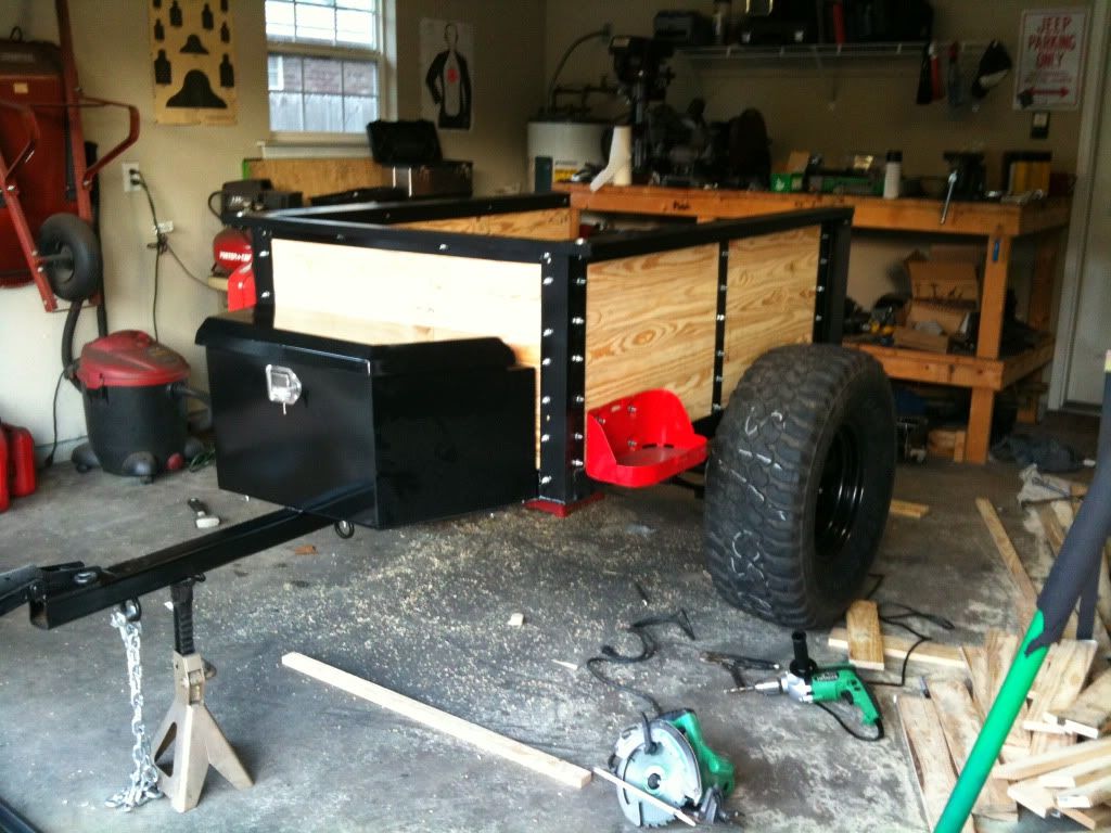

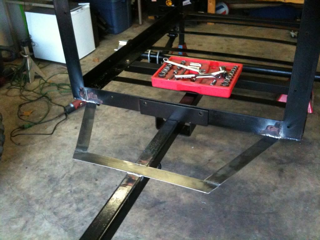

Taking a lunch break so I figured Id upload what Ive done so far today:
Needed to make a mounting point for the tongue box:

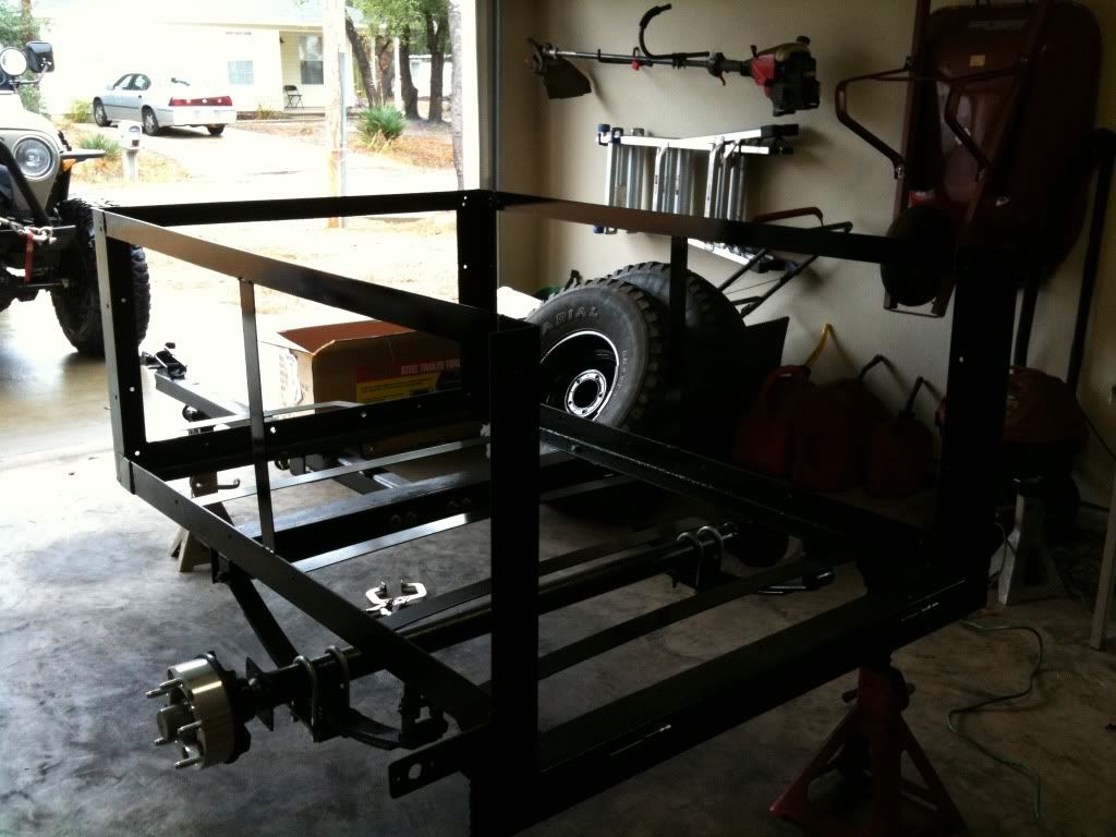

And got the top part of the frame all boxed in:
Now Im pretty much waiting on the paint to dry. Ill probably eat lunch then run up to lowes and grab some lumber and get started on filling it all in. Im getting excited now that its starting to come together.

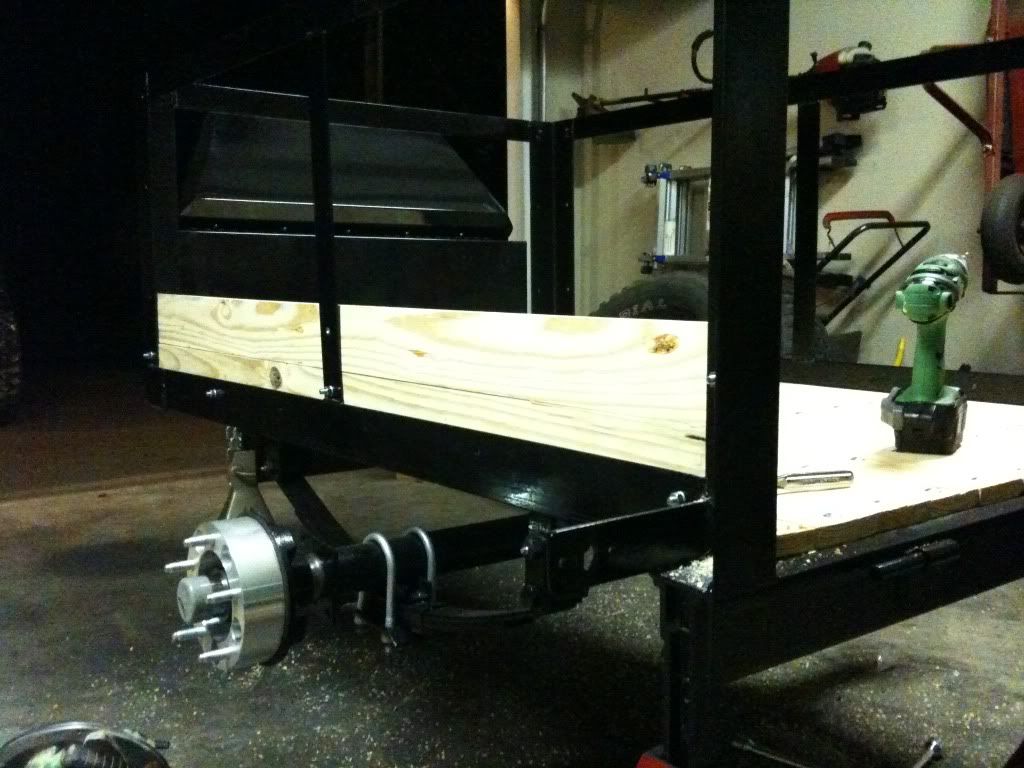

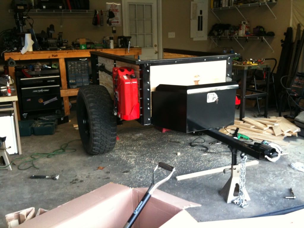

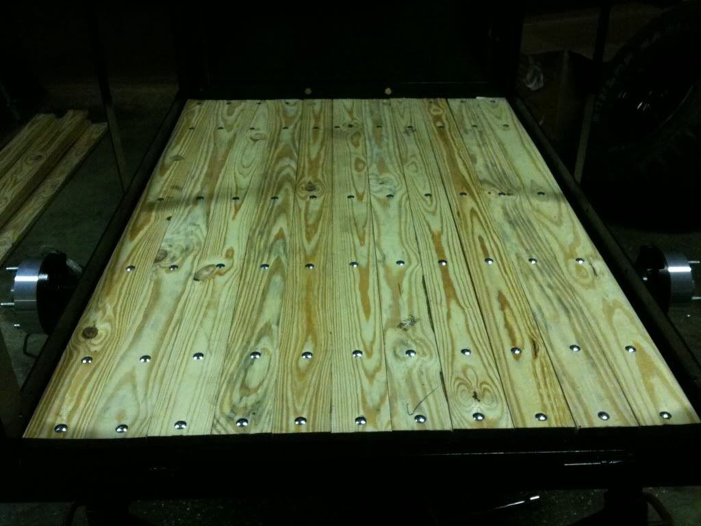

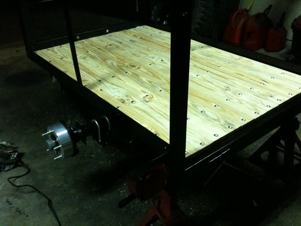

And heres where I finished tonight. I got the bed done. 1x4 slats. That is some back breaking work drilling all those holes. The woods the easy part, each bolt goes through metal too. Lots of bolts.... I started on one side but both my drill batteries were dead. Good time to call it a night.

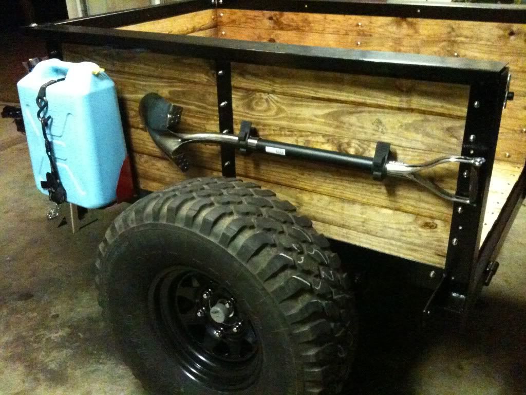

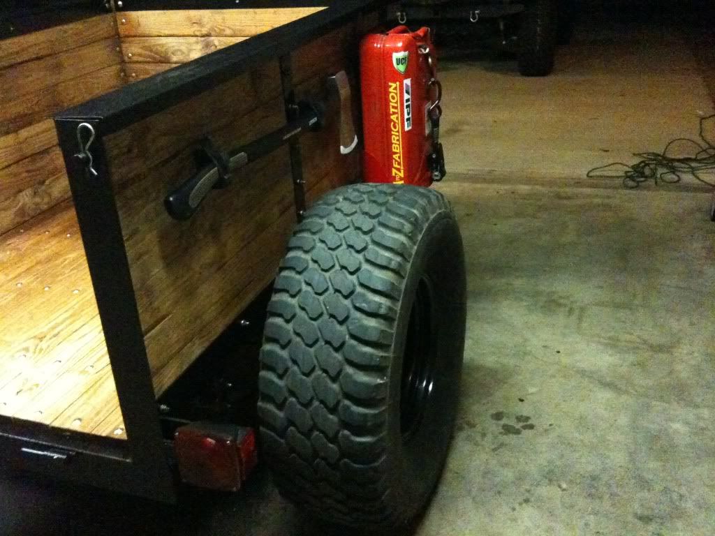

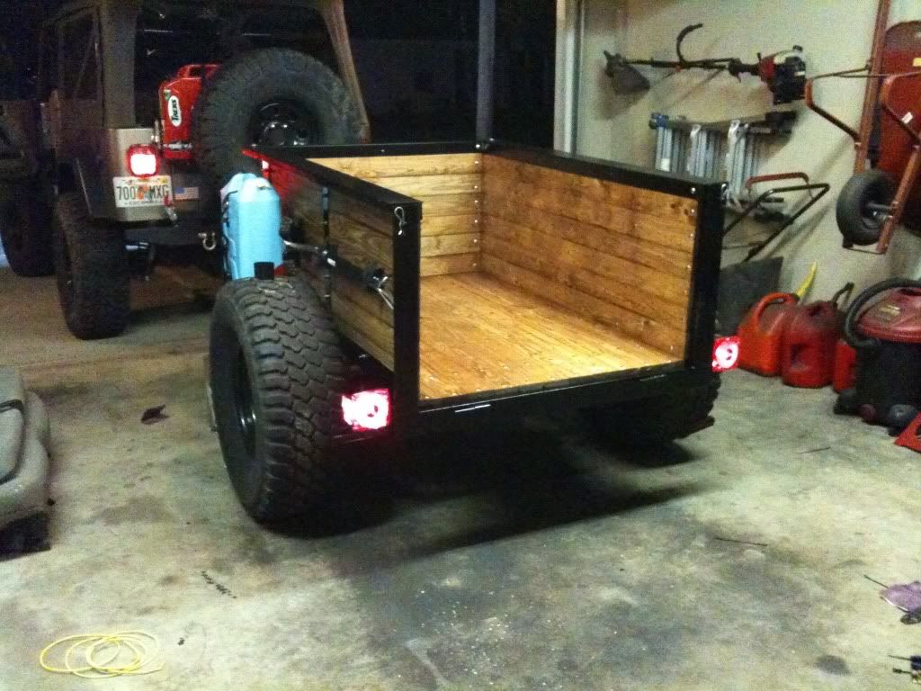

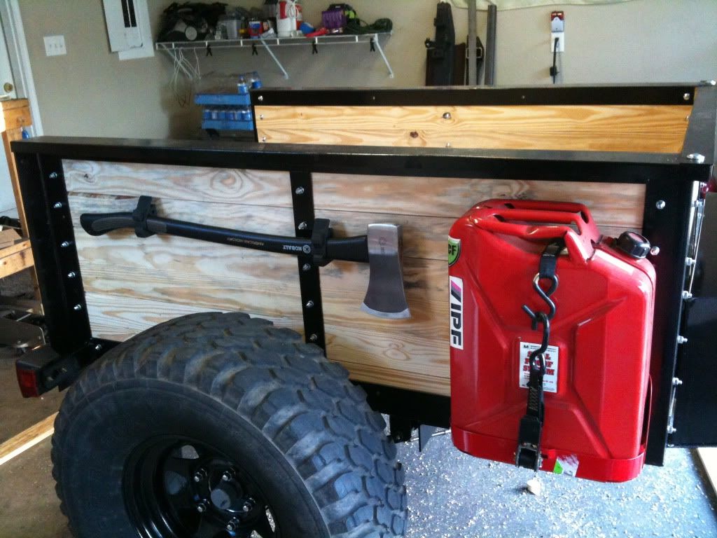

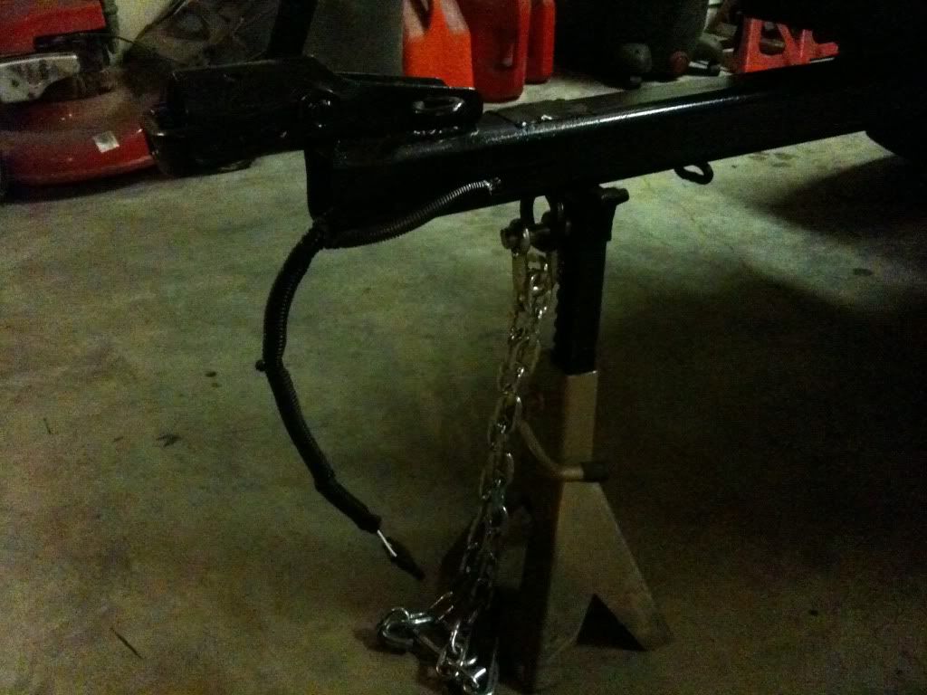

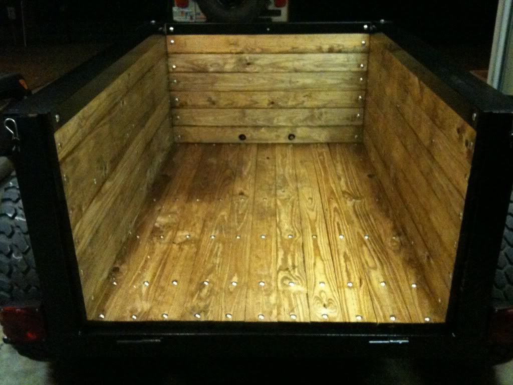

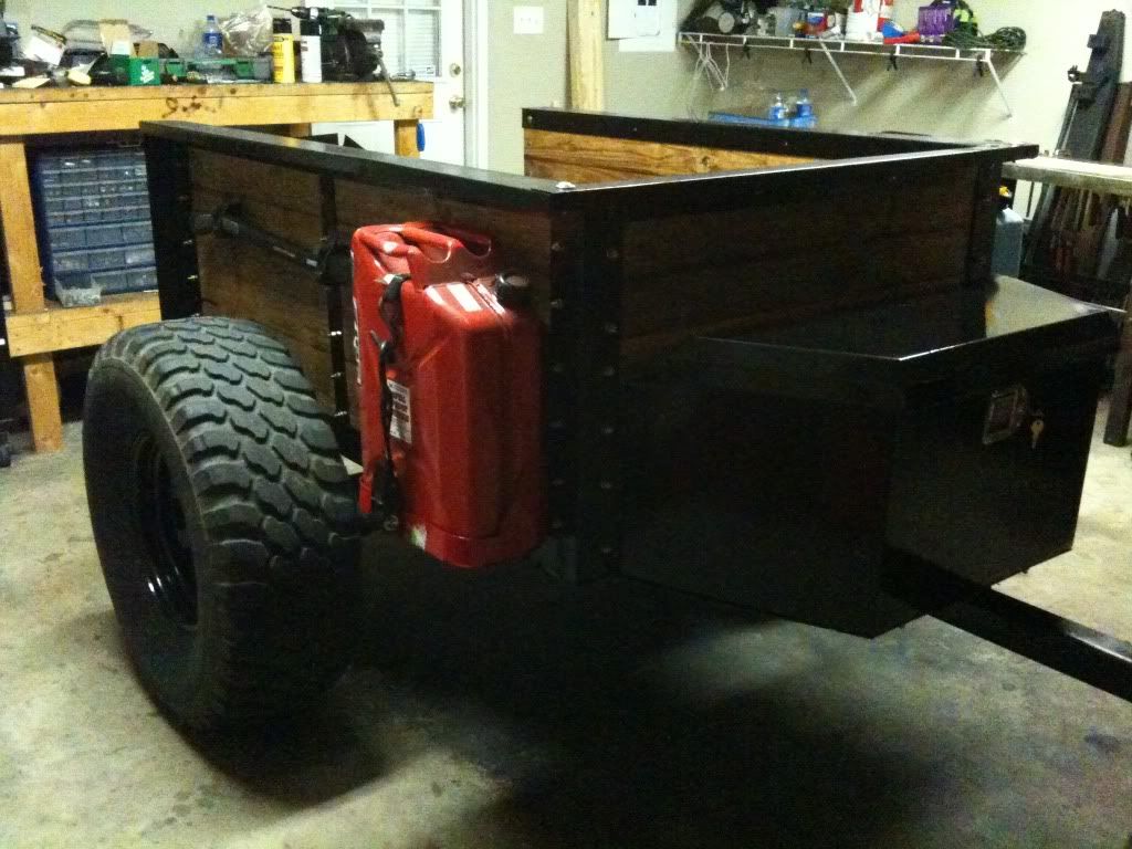

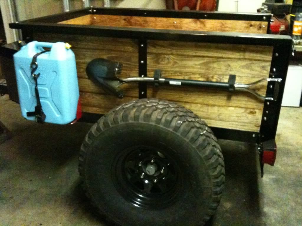

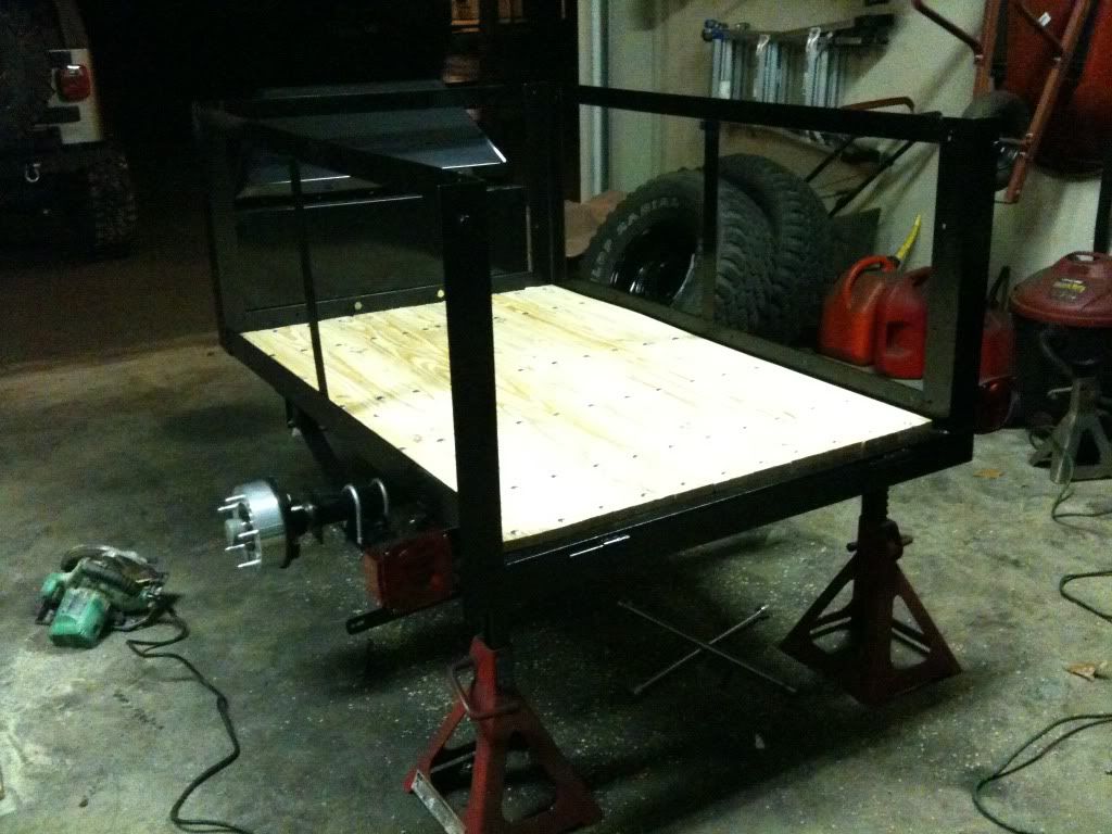

Its a Trailer! Im pretty much finished. The only thing I have left to do is build a tailgate and add a tongue Jack. I sealed all the wood, you should be able to tell by the different colors of the wood as the pictures progress. I think I decided against the fenders. We dont have fender laws down here in MS and I like the look better without them. Plus it made it a lot easier to add the shovel and axe without them. Pics:
Not sure why this pic makes the whole thing look crooked, its not. It might be the light or the jackstands...
