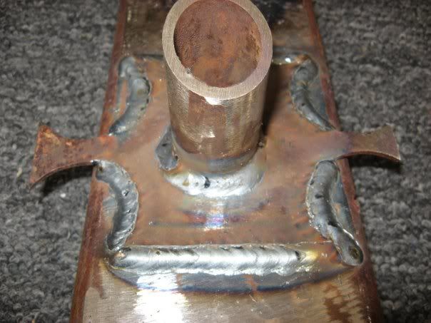

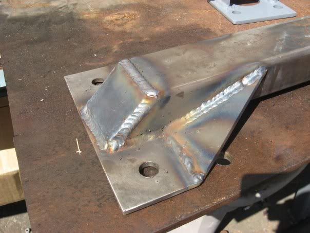

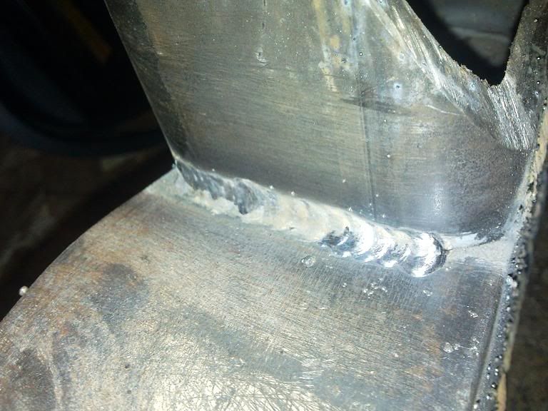

Lets see some more Stick welds!
nothing fancy just a cage mounting point (a little vertical and a little overhead). Welded using an ancient John Deere 200 amp ac machine and 7018 1/8" rods. Don't forget about the axle tubes in my first post too.
In fact thanks to your advice on the 3/32 7018AC rods the rest of my cage is an all stick welded assembly

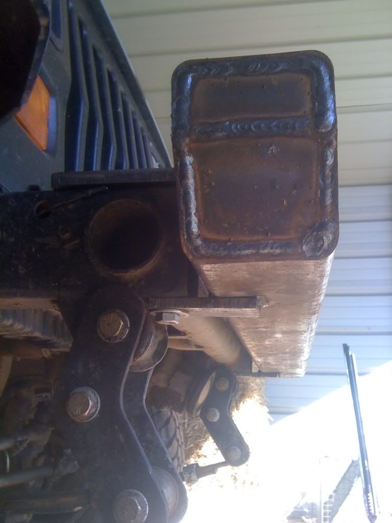

Here's a partial pen stick weld to keep my bumpers end caps stuck in place. I was in a hurry to go get a burger (lunch break) when I made these an knew I was gonna grind em flat so i really didn't care how these looked. 7018 1/8"
I think we all know what this is! 7018 1/8" again. Not really visible but the side gears got two opposing edges flattened with carbon air arc gouging to provide a nice flat spot to weld that prevents them from EVER turning

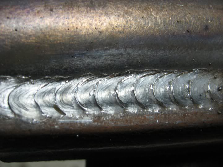

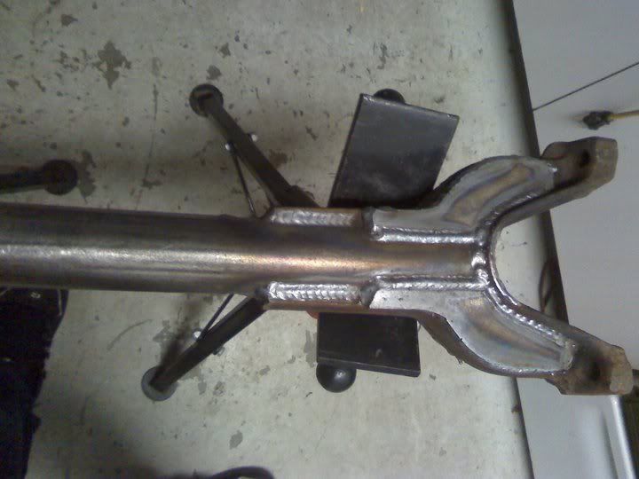

some good lookin welds in here. wish i had some pics of the stainless stuff ive done at work, but i guess ill just have to show my super budget college welding skills. this is 3/8 beveled at a 45 with an 1/8 land on my 8.8, 3 passes with a lincoln 135 HD with .035 FC
doesnt hold a candle to a lot of these higher powered MIGs in this thread but goes to show a little 110 flux core can lay down some pretty good welds

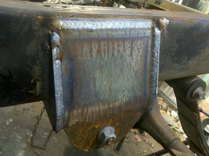

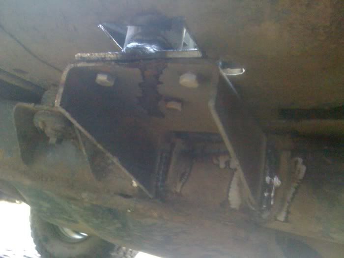

heres the dring mount, 7018 on an old linocln 225
and these are my sliders, old no name 220 mig

It lays a good weld but how deep is the the weld

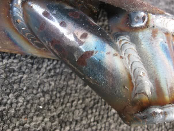

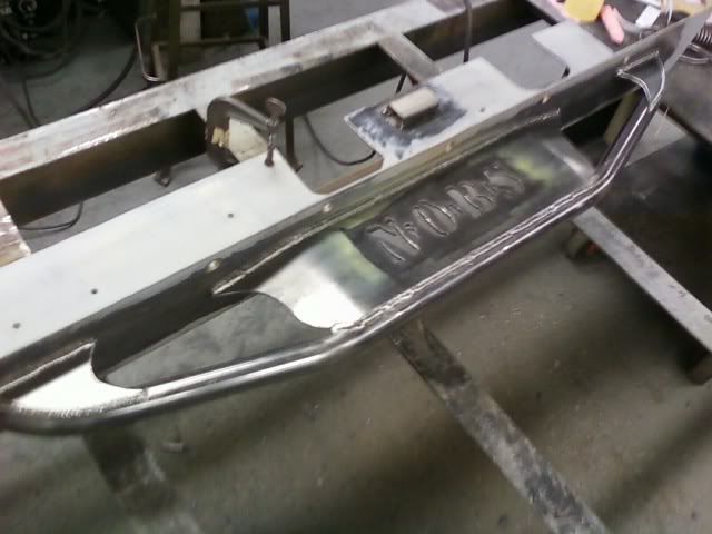

Lincoln Powermig 215.
Forged steel and .250" wall thickness DOM.
.250" thick mild steel plate
.120" wall DOM tubing
.250" and .188" plate and rectangular tube
.100" thick plate and .250" wall tubing.
