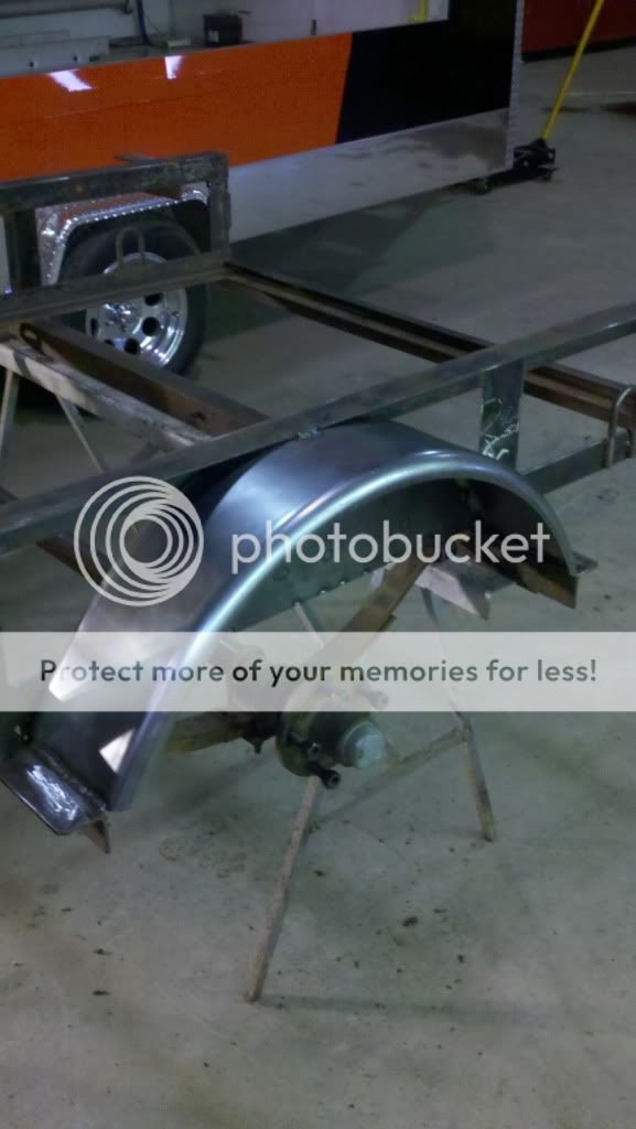

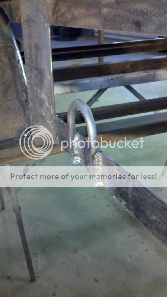

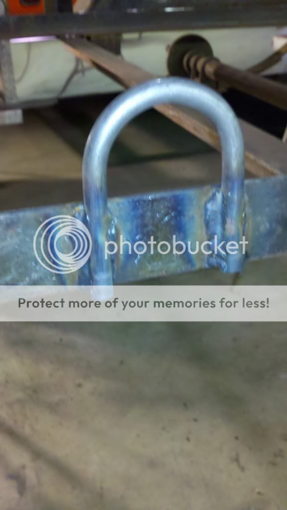

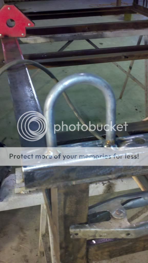

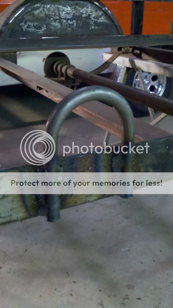

while re-building and upgrading my trailer
dont have any upclose pics of the welds on this fender i fabed

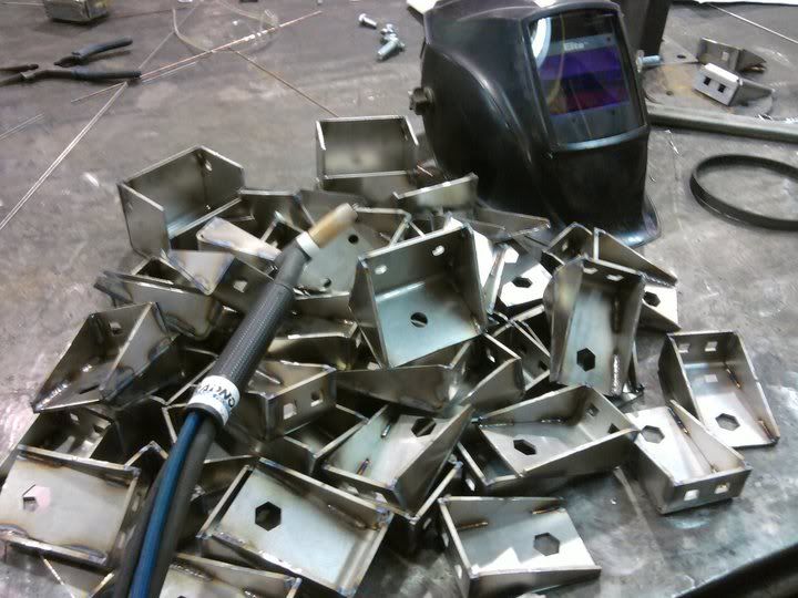

the first is 10g stainless

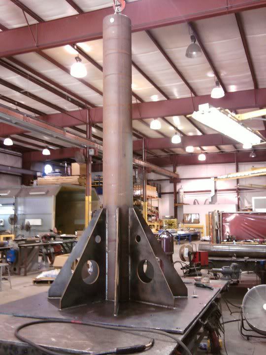

in the second pic the base plate is 3/4, the gussets are 1/2 ", and i beleive that is 13" pipe 10 ft tall.
sorry they aren't up close.
