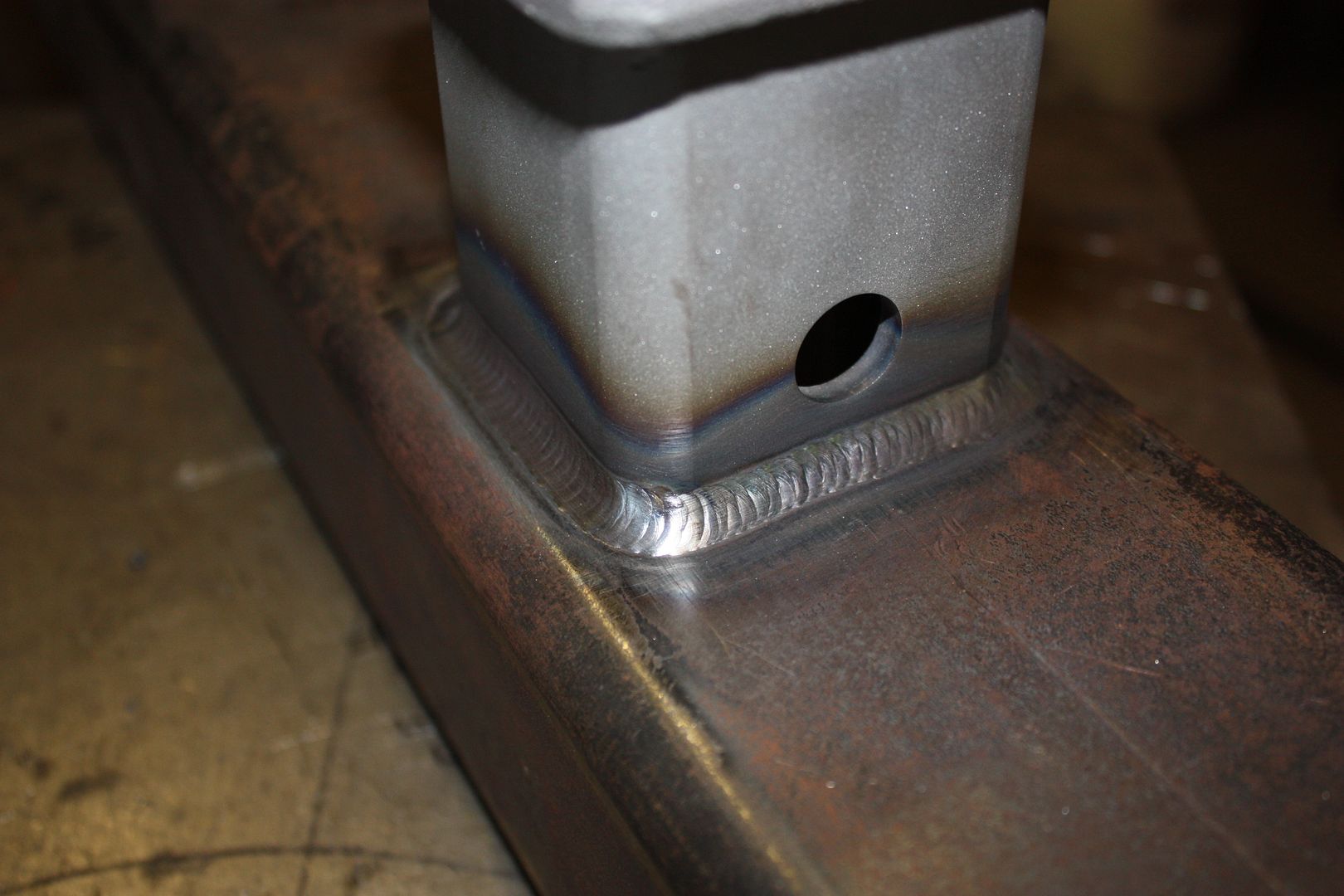

messed with some Stainless TIG today. Very new at TIG still.

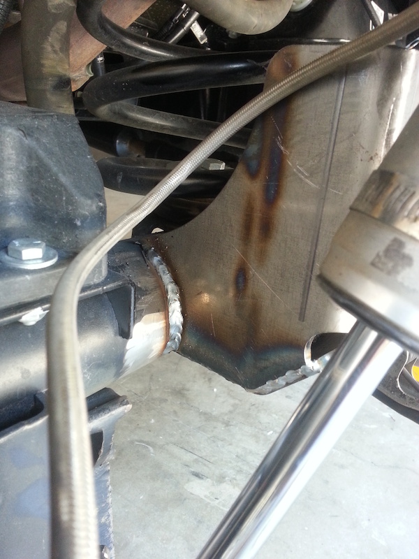

First try at mig welding today, I've only done tig before. 1/4" steel using flux core on a Lincoln 140. What do you guys think?

post #726 of 824 Old 08-16-2014, 11:44 AM
AtTheHelm
Join Date: Nov 2012
Location: South Lake Tahoe
Posts: 860
Not bad for your first shot... Next time clean the rust off and bevel your two pcs so you have a groove to sink the filler wire into. With flux core you actually don't want to do any cursive 'e's or half moon patterns. Just drag with about a 10-15 degree angle. Check out this Steve Bleil instructional vid: http://youtu.be/pVyYvcEqkcQ

I'm new to welding, what am i doing wrong?

post #729 of 824 Old 08-18-2014, 08:20 AM
rixcj
rixcj's Avatar
1979 CJ5
Location: Saunderstown
Posts: 2,360
You've got to keep your weaves tighter together. Also, torch angle appears to be aimed at the flat piece a little too much. Unless it's the camera angle, it looks like you have more weld on the flat piece instead of an equal amount of weld on both pieces.
The weld also looks a little "cold". Try upping your amperage 5 amps at a time, until the metal flows a little better.
To help you understand what I'm saying......

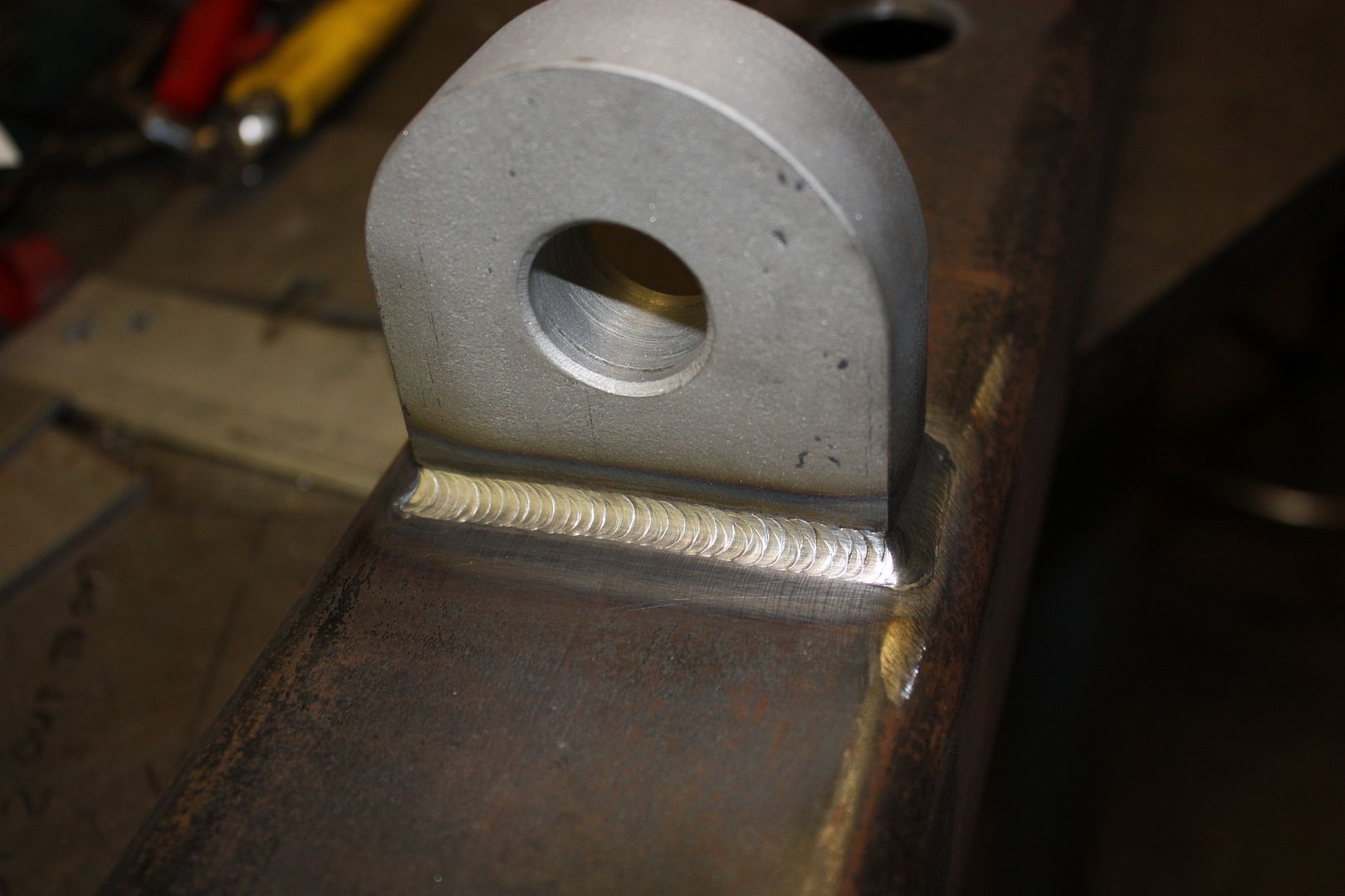

Practicing my heat control, i know the weave needs work still but have heard of people doing this so i figured i'd give it a shot.
1998 ZJ-- lowered a touch
2005 GMC 2500HD 496 C.I.

post #731 of 824 Old 09-19-2014, 08:02 PM
youngjeepr
Location: layton UT
Posts: 2,533
Not bad! You will get better it just takes practice. What size tungsten are you using?

post #732 of 824 Old 09-19-2014, 08:08 PM
youngjeepr
Location: layton UT
Posts: 2,533
3/4" .035 wall 6061

underpowered
Bouncin' on a Budget
underpowered's Avatar
Join Date: Nov 2005
Location: northern kentucky
Posts: 3,051
3/32 2% ceriated on my Hobart EZ-TIG 165 set on its lowest setting of 10 amps.

post #734 of 824 Old 09-19-2014, 08:51 PM
youngjeepr
Location: layton UT
Posts: 2,533
3/32 might be a bit big for that thin of material while you're learning. But it's a good universal size. Im not familiar with that machine but it looks like it does pretty well with thin material. I've used a few Lincoln machines that get crazy arc wander at low amperage.
