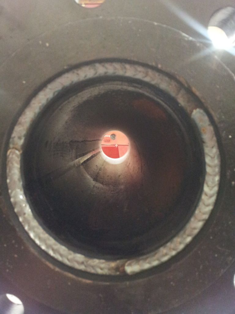

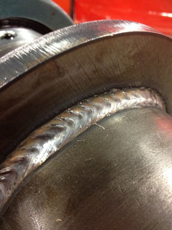

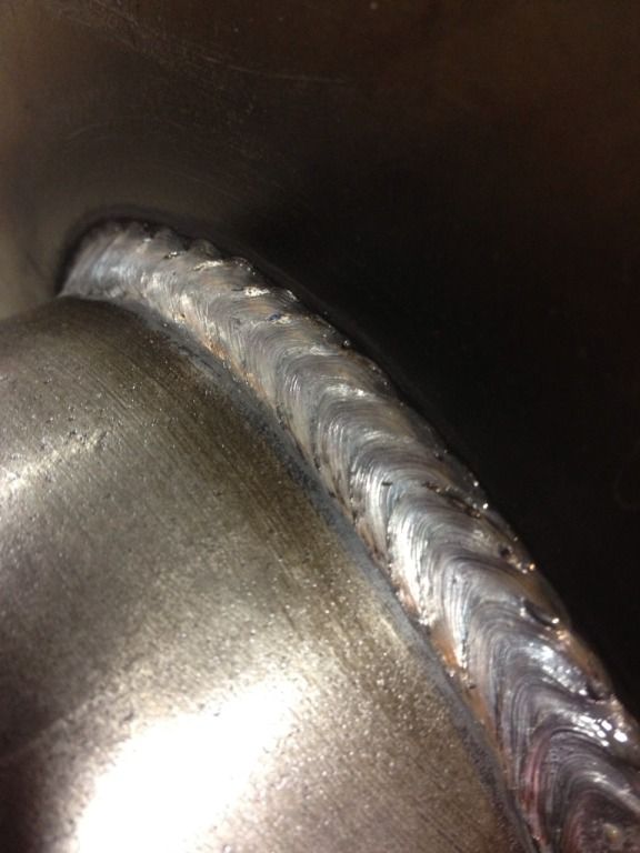

Snapped a couple pictures at work the other day of a few things. Using a Miller CP-302 with a wire feeder using .035 wire 82/18 argon/co2
large rollers i was welding while a guy i work with was turning it.
I do a lot of tig work too but don't have any pictures on my phone. Not my best work, just happened to snap some pics the other day.
