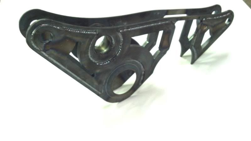

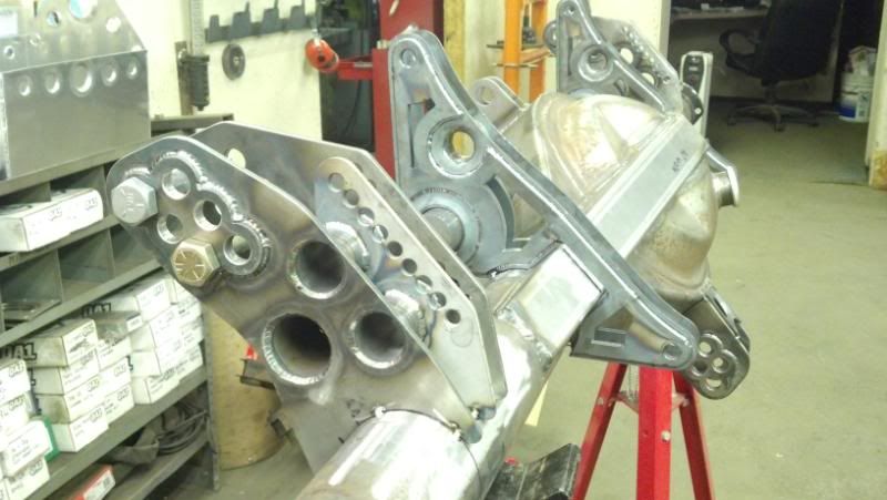

Some recent stuff that I have messed with.

You're getting there! just a bit more practice 13 below!
Loving that jig. Very neat!
