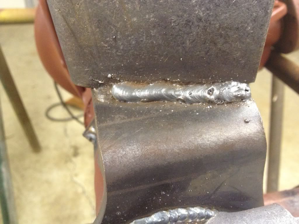

Penetration looks good Keep practicing moving at a consistent speed. You want the bead to remain uniform in width from start to stop. Also you can pause a little at the end of your weld to fill in the tail end. Are you moving in a pattern or just a straight pull? With flux core I normally just run a nice straight stinger to avoid trapping flux in the weld.
Most of them were using the small e pattern. I tried one with just a straight line.

Also, are you pushing or pulling? With fluxed core wire, it's generally recommended to pull.
An old welder told me a catch phrase: "if it's got slag, drag."

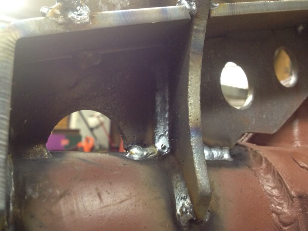

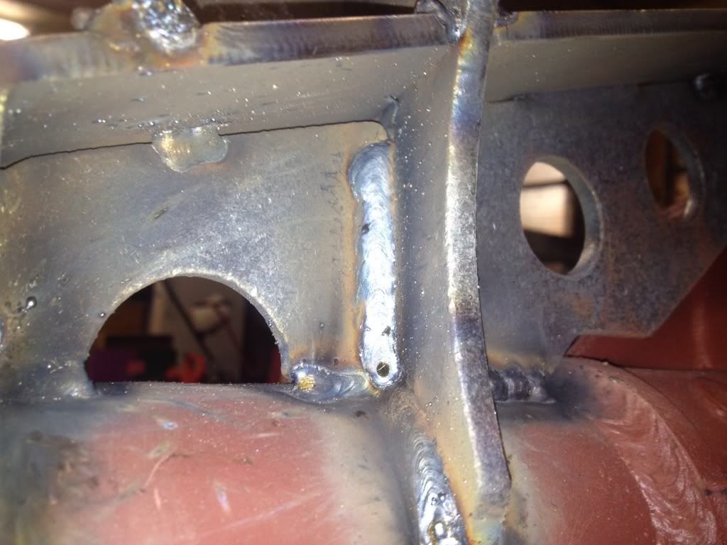

2nd time ever welding and the first time I've ever done more than a few passes on scrap. I did about half the welding on my Artec truss yesterday (not half of the welds overall, just what was welded yesterday). I did mostly straight on, only using a c pattern on small gaps. These were some of my better welds, when we weren't having gas or feed issues. The machine is a Millermatic 185.
