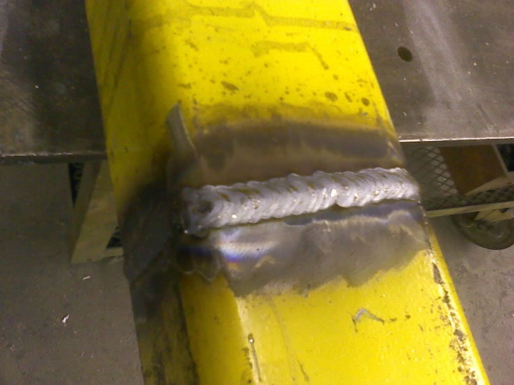

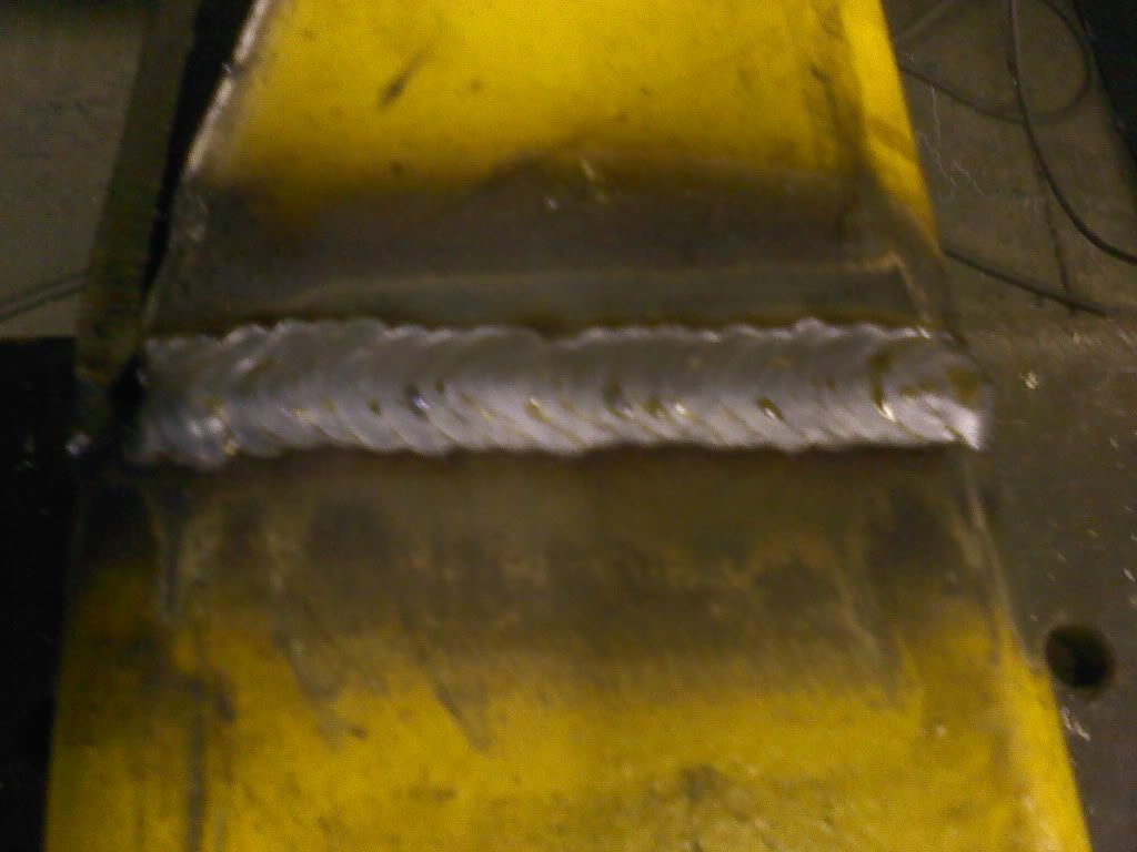

My welds, nor my triceps, are as nice as the OP but here goes.
These are all FCAW, no Gas, .030, often done outside, 1/8 steel. These were all done using a Hobart 125. Now using an Ironman 230, still no gas.
