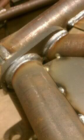

Did some work on the new tire carrier design today and thought these welds looked half decent.
Most the products I do the welds get smoothed but I think this product will have them not smoothed out, just knock the high spots off.

post #310 of 824 Old 02-20-2012, 07:45 PM
cj68
Location: Southold
Posts: 38
I'm finally getting the hang of this welding stuff.

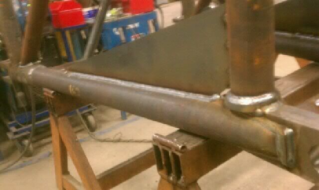

We have to use some thick wall tube on some of our couplers. Since the size is not available in wall thickness and outside dimension, we make our own out of angle and weld the corners.
The material is 6"x6"x3/4" angle.

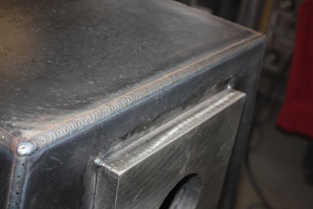

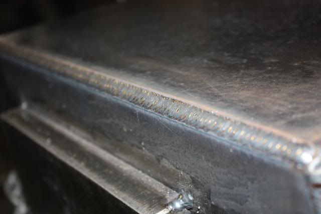

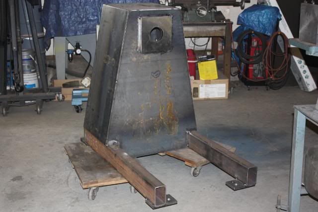

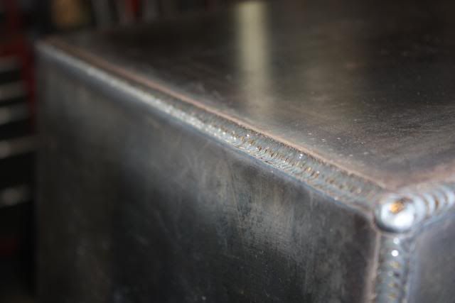

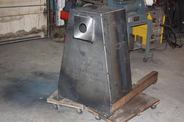

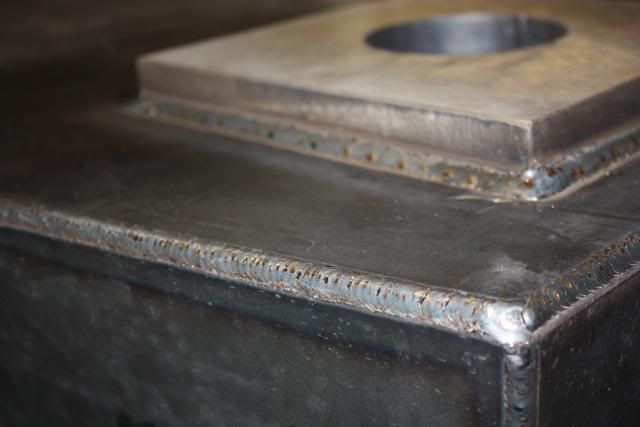

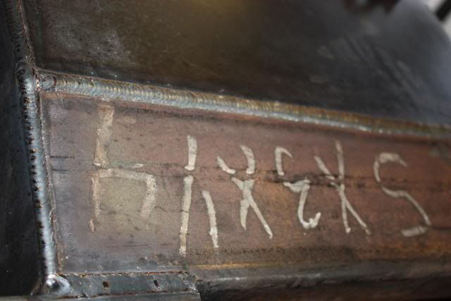

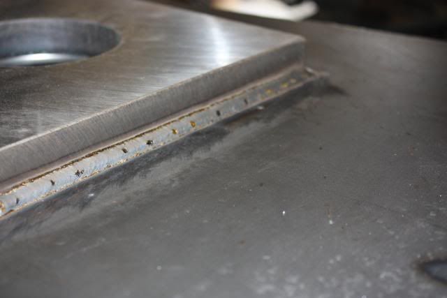

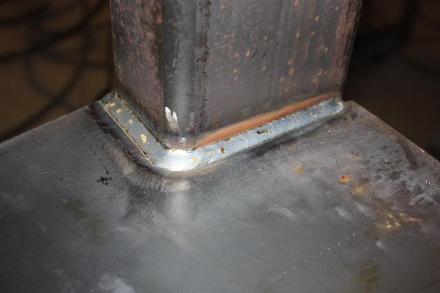

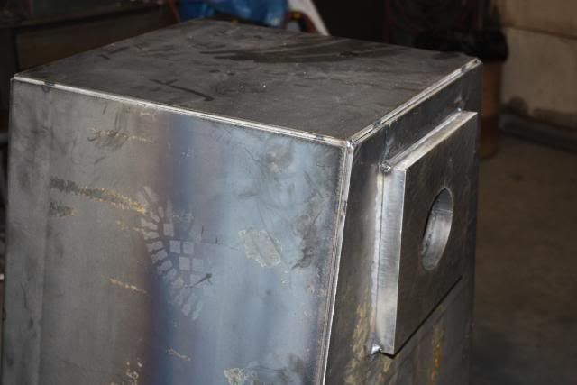

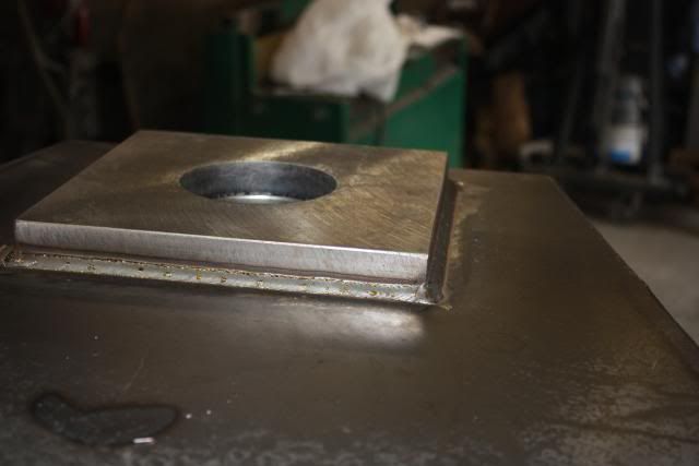

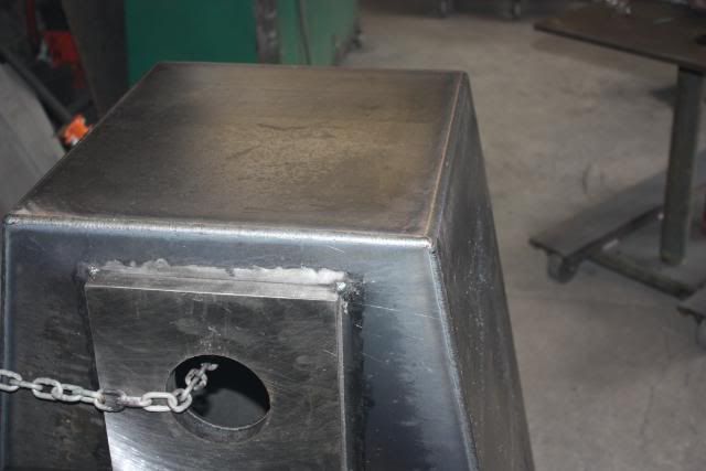

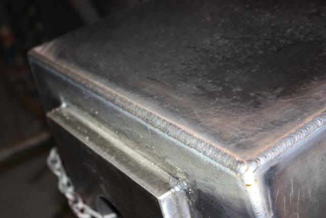

Here are some mig welds from a payoff base that I'm fabricating...
...just tacked together...
...the outer skins are 1/4" thick, the rectangular tube is 5" x 3" x 1/4" wall, and the square plates with the holes in them are 1" thick...
The customer will sand down all the outside corner welds of the base, so that it has the appearance of a cast piece, after it is painted.
