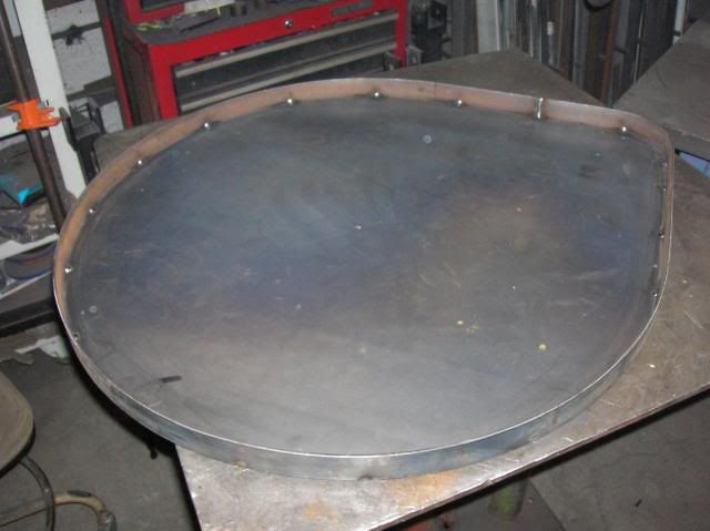

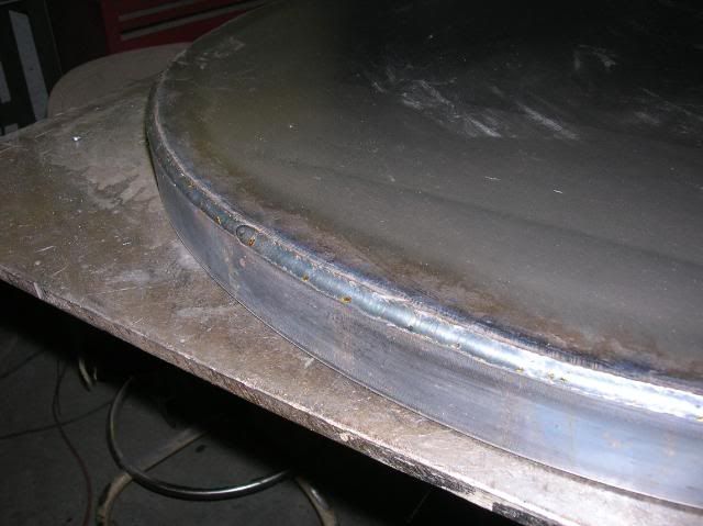

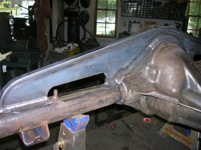

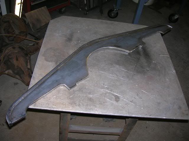

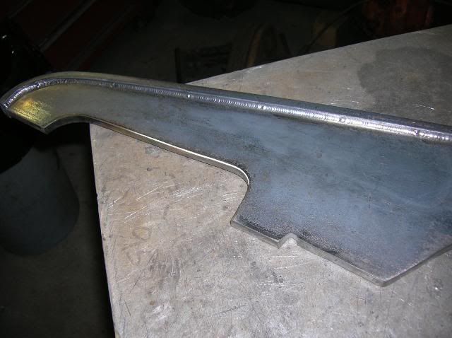

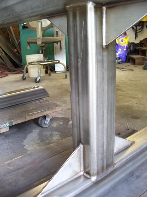

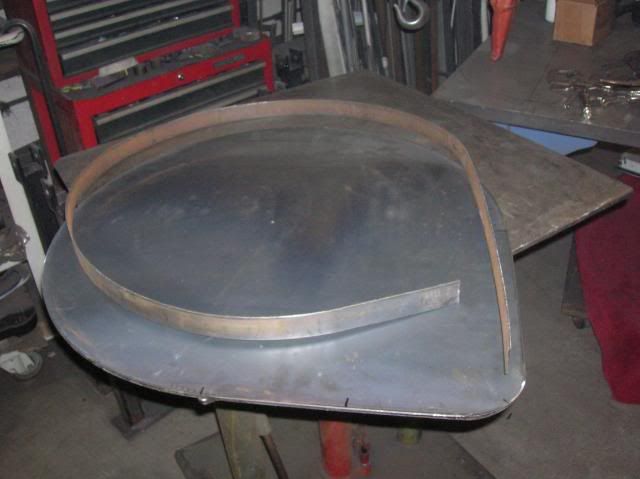

Here are a few more...

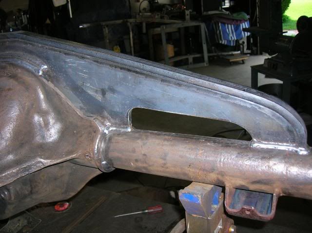

This is a truss that I made for my M20 rear axle..

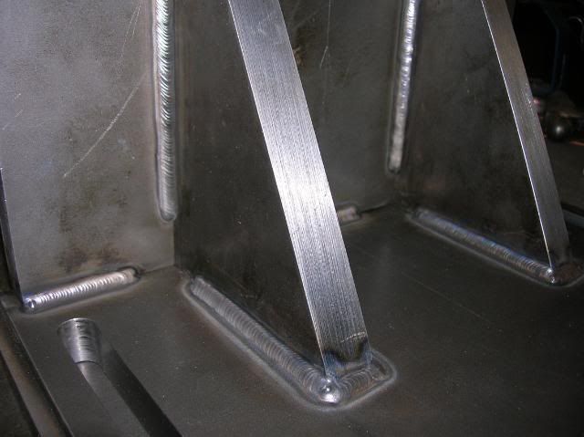

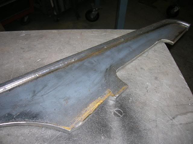

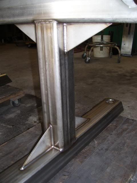

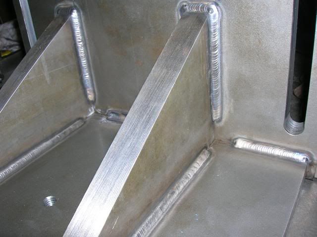

Customers jobs...
Rich

Nice looking welds Rich! What are some of those other jobs you made?
Also, that is one stout looking truss!!
Thanks. They are just customer's jobs, built from drawings that they send me. I build all kinds of different things.
Seriously stout! What is that, 1/2" thick, or are the pics fooling me? It looks huge.
The main web is 3/8" thick, and the top wrap is 3/8" thick x 3/4" wide flatbar.

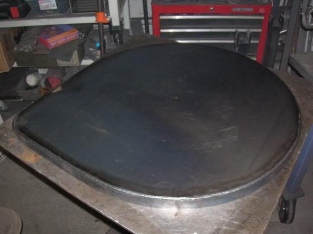

All 1" 316L Stainless I Stick welded for a nuclear power plant project tonight in the outside shop that we go in and start an outage monday night inside.
Crappy Cell phone pics

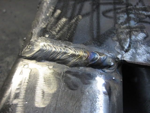

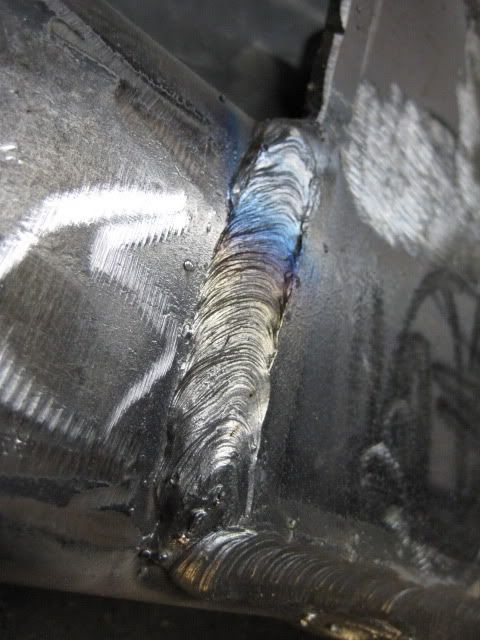

Still getting the hang of TIG welding. Here is the light hoop on my front bumper. Feedback please.

r08ert209cali ->
I believe I see some undercut, you maybe need to lower your amperage or/and decrease your speed so the groove fills properly.
That's really not too bad. It'll probably never break, being that it is a light hoop.
Ideally, a little more weld wire fed into the puddle would give you a "meatier"'(thicker) bead.
What are you using for amperage control, a foot pedal, a thumbswitch, etc.?

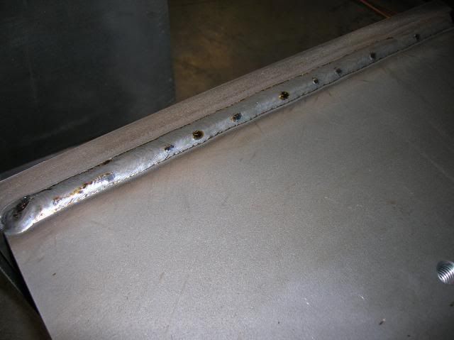

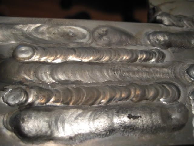

Messing with Tig welding aluminum
I hadn't messed with a stick welder for a long time before I did this. I recently picked up a Dialarc 250 for TIG but it will also stick weld. I haven't stick welded at all in about 3 years. Before that, I mainly MIG welded stuff. I only used the stick for heavy plate and structural tubing. I didn't do to bad but I figure I could always improve some. Any good tips or things you guys can tell I'm doing wrong? I know the first one is slightly undercut. I turned the amperage down slightly after that one.
Rich
it is just a scratch start thermal arc 95s, only control is on the machine. I had it set a little high.
