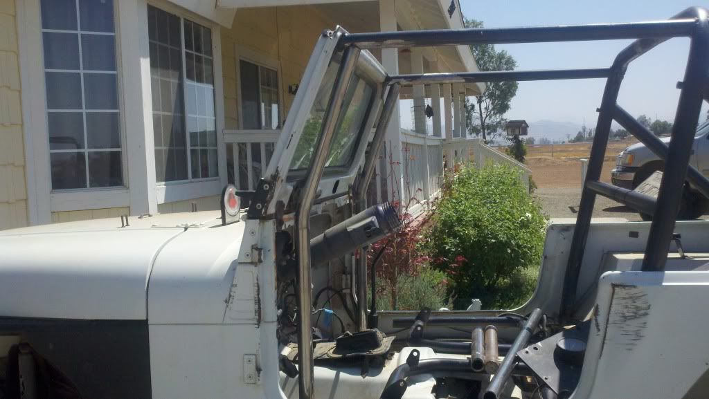

Rebuilt my brothers cage in his YJ.

YJ cage into a CJ5. It can be done. I will keep you all updated

Originally Posted by jkoz79 View Post
Attachment 268480
YJ cage into a CJ5.
It can be done.
Meh, that seems like more work than it is worth.
Wouldn't it be more cost effective (if thats what you're after) to build off of the factory CJ-5 roll bar?
I dont have a factory bar. It is a fiberglass tub and the steel tub didn't have one to begin with
jkoz79 is offline

Does anyone have an accurate degree angle of the main hoop?
The degree its leaning back? I will try to get one tomorrow morning
Exactly. Thank you in advance

No problem I got 15 degrees on my angle finder
