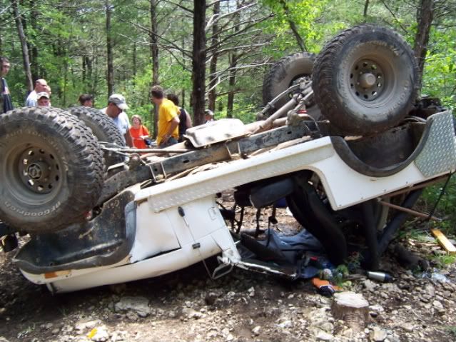

ya i gotto agree, theres no need to tig a cage. plus all our fits are not perfect, so i would rather fill some small gaps or bevels with mig than sit there and over heat the joint trying to fill it tig wire.
man that is a scary picture, even the simplest jeeps need a cage. even if its tied into the frame on the front and use's the factory cage in the rear.
