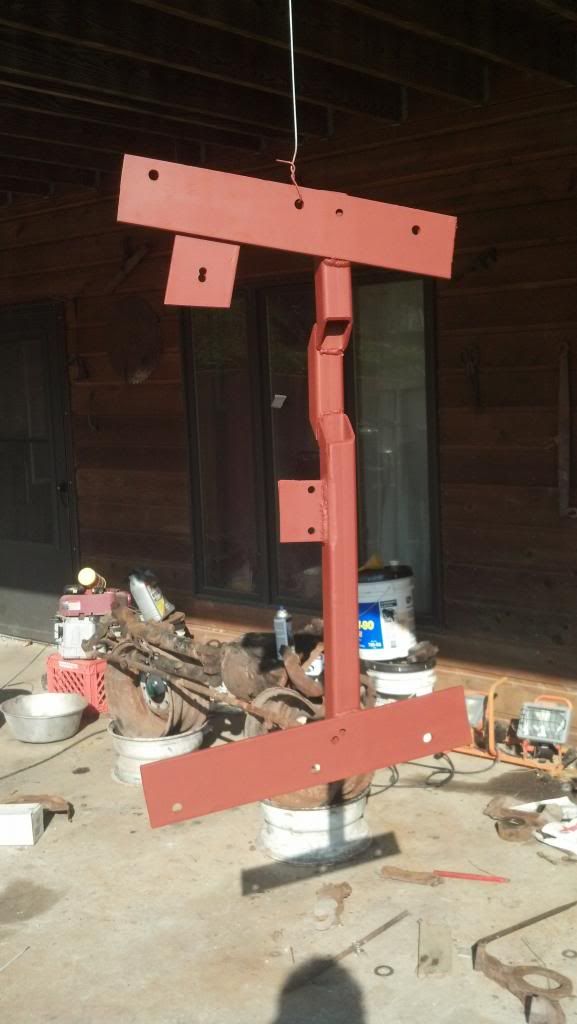

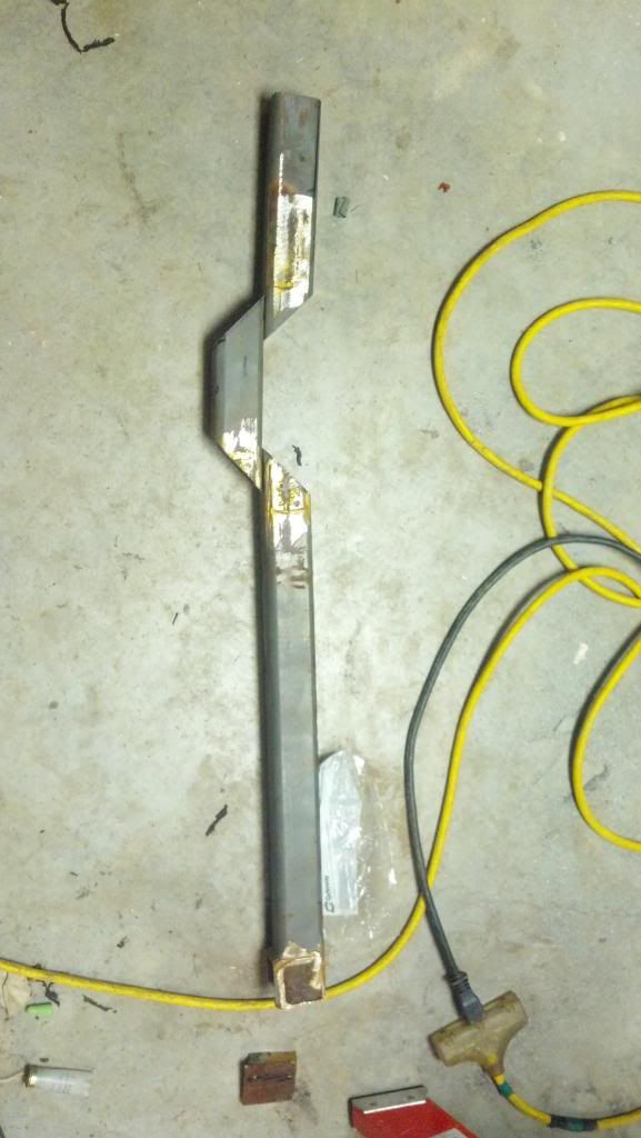

Well im terrible at in-between pictures, but here it is my take on it. i used 2in square tubing that was 1/4in walled then used pieces of 1/4in plate as, mounts to the factory holes on the frame, mounts for the transmission, and for the torque arrest-er on the NP205

Idea for missing the driveline
and skip some welding then in primer
