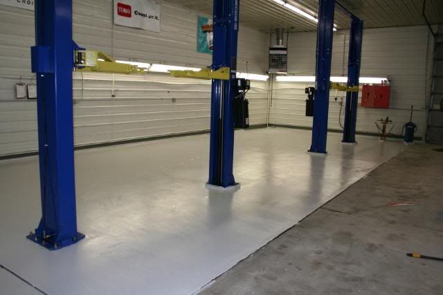

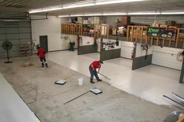

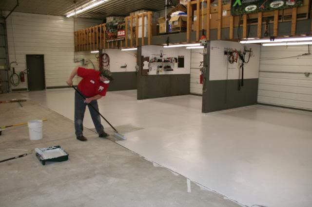

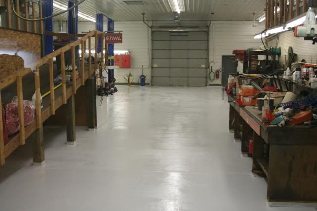

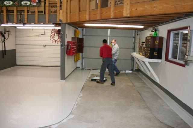

We did the floor, in a shop I used to work in, with 2 part. That floor held up very well. There was some chipping of the paint where the arms of the lift slid back & forth. We did tractor & lawnmower repair in there, and that floor took alot of abuse. Also there were a few small burn holes where guys had used the torch, the glowing slag pieces will burn through it when they fall off. The acid etching made a huge difference, you could tell when we missed an area. Maybe it's different with new concrete though.
We slid all kinds of metal tractor crates & pallets over it everyday, never did any damage to it with that stuff. It also made sweeping & cleaning faster, as well. The next week after we painted, we replaced every bulb in the shop. For a week or so all of the guys wore sunglasses instead of clear safety glasses!
Good luck, very nice space you have coming together. I am jealous!

Thanks for the pics and info. Do you know what brand of 2 part epoxy was used? Sunglasses, exactly what I'm looking for- literally... If I drop that cotter pin I'll find it on a white floor!

It came from the local Sherwin Williams, I believe. Don't remember the name on it. I know there were 2 price options and we used the cheap stuff on part of the showroom. It was user friendly enough that we did not need the masks & stuff. However, it was peeling & cracking, with just foot traffic, in a couple of months. When we decided to do the shop, we went with the more expensive option. That stuff had us all really loopy after applying it & we had to kill the heaters & pilot lights in the building for 24 hours, because of the fumes.

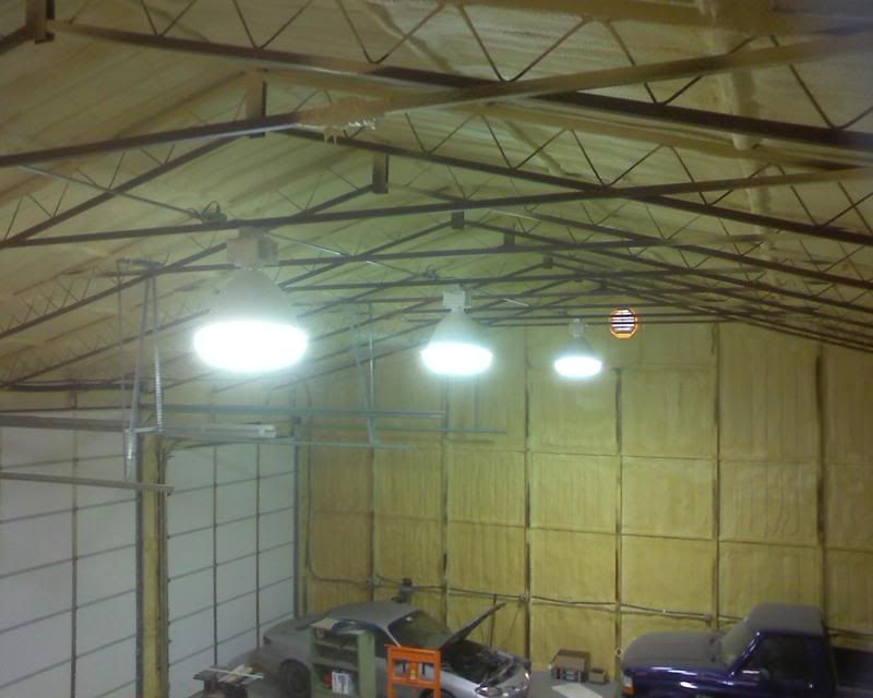

these lights work pretty good in the shop my family built. They were kind of expensive but only needed three above the bays. I dont remember the price but they were several hundred each

Awesome- exactly what I was thinking- but they may be too powerful... can that ever be the case? Maybe only two? My space is only 22x22.
I'm getting a nose bleed and vertigo looking at your shop pic!! Talk about tall!
