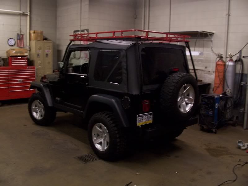

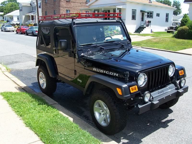

I bought a wilderness roof rack for a good price from the sale section here. It needed paint and a good cleaning. I had no instructions, so I searched the web and found a site where a guy did an install and showed the original instructions. Then I realized the instructions said I had to drill 6 holes in the body. I really didn't want to do that, so I made this. Pretty simple, just figured I'd share... In the future when I build my rear bumper I'll make a bolt on receiver, which will end up looking a lot better.

Nice.. how much weight do those things hold?

Not sure, but the thing is pretty damn sturdy. I'll check the instructions and see if they have a load limit. The thing complete weighs close to 100 lbs., so it seems it will hold a decent amount.

Is there room to drop the soft top with it on there?

I'm guessing no.

The uprights are mounted tightly, to drop the top I need to remove 2 of the 4 bolts. (There are 4 bolts holding the red section on, 1 over each upright.) The rack came with props to hold the upper section, so I can lower the top. It takes an extra few minutes to do and isn't too bad to do alone. I may modify it later with hinges or something, kind make it lie the Dave rack thing...

This is how the rack will lift if you drill through the body, the instructions state that you need to drill 3 3/8" holes on each side, 6 all together.
I fabricate my own mounting bracket to avoid drilling through the body. So in order for me to lower the top I need to remove the 2 front bolts, like in this picture below.
With the way I mounted it, I am able to adjust the height. M60-E4 asked what the height in the rear was, for me to clear the top at the center bow I am about 50 & 1/2" from the top of the factory bumper. I would assume it would be around the same height if you did the drill and the install as per the instructions. The height in the front is around 4", give or take a little. The rack isn't exactly level, the *** of my Rubicon sits higher, so I adjusted the rear so it's at around the same pitch as the rig. I wasn't able to find a load rating, but I feel it would be more then what I'll be putting up there. The rack feels very strong, and I've only mounted the rear with 1 bolt per side. I plan on adding an additional bolt per side when I fab my new rear bumper and tire swing. Here are some more pics, if someone could click free them for me, that would be great.
