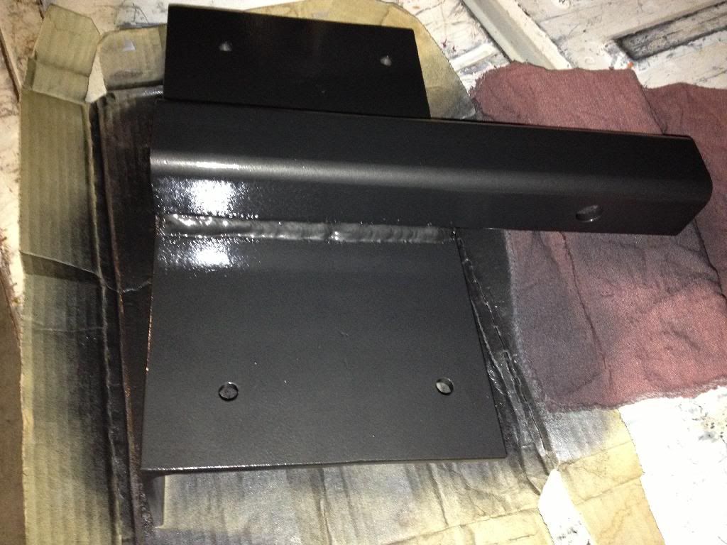

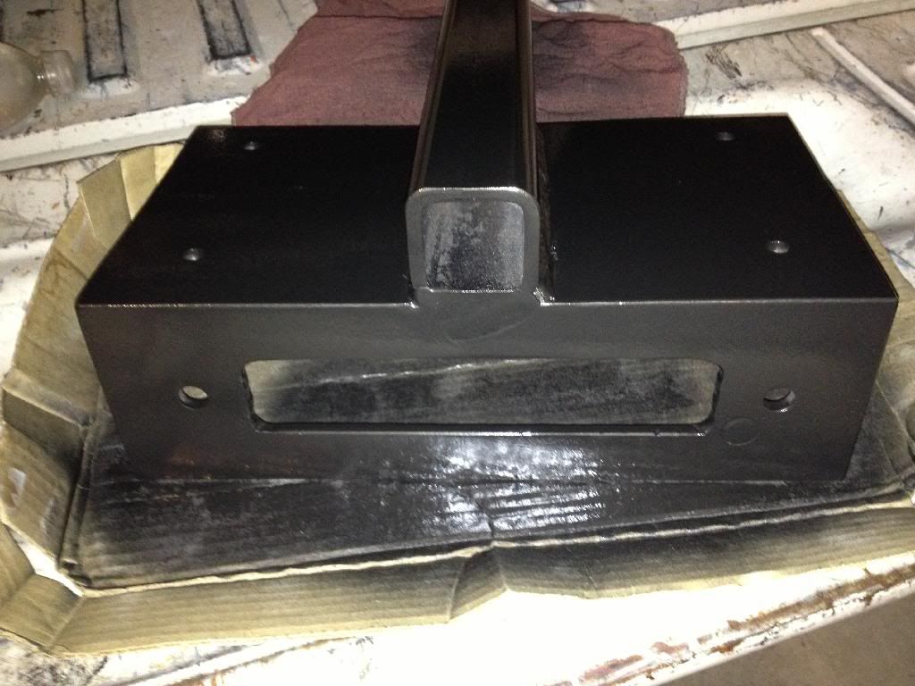

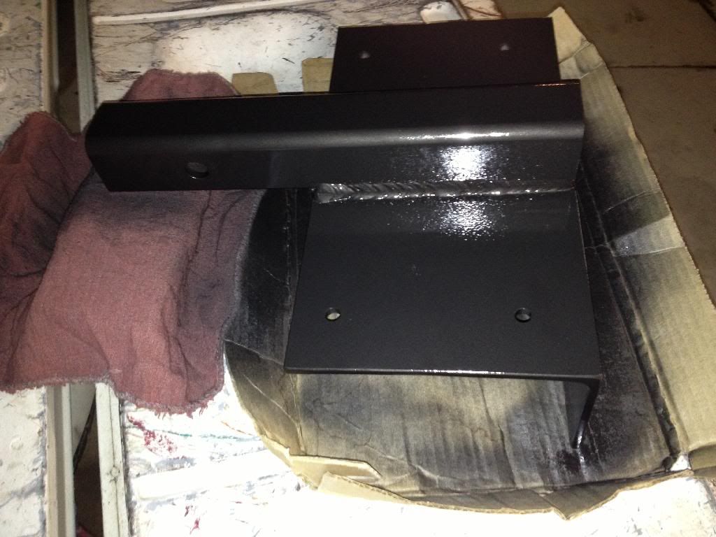

Next project
Receiver winch mount
Guess I didn't take any build pics of the plate
Took a piece of 4x4 angle & welded some 3" flat bar to it. Then welded a chunk of receiver tube to it.

All built just add paint.
Painted
