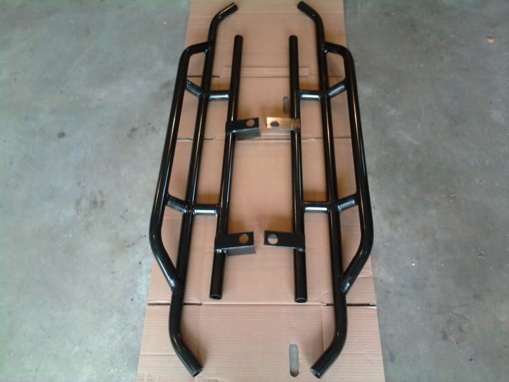

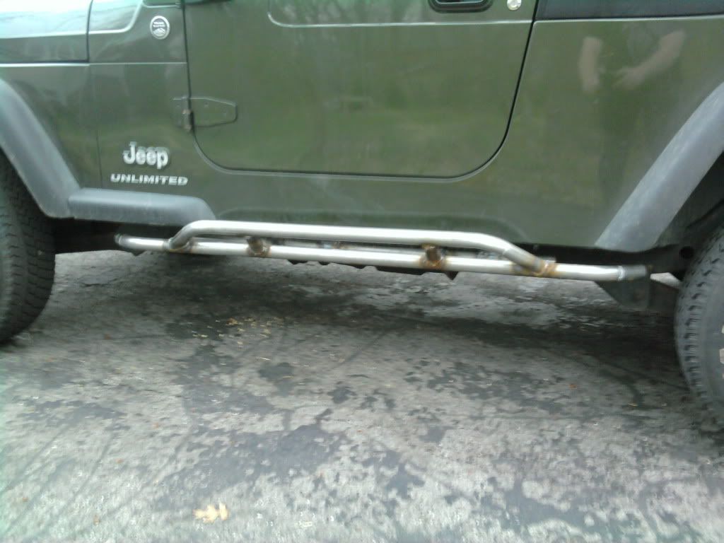

Playing in the garage, I came up with these. They are 1.5" .120 wall tube. Now they need some grinding and paint. Let me know what you think or if you have any ideas to make them better, I'm always up for improving my custom projects.

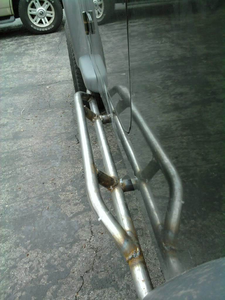

how are they attached? i would add some kind of another brace at the end pieces. or have those too go all the way to the frame. i know its hard to bend .120 but it seems if you hit it right its going straight up into your rocker

They are currently attached to 2 body mount ears off of the frame. I'm not real sure of the strength at that mount locations, but I like the idea of being able to remove them if need be.

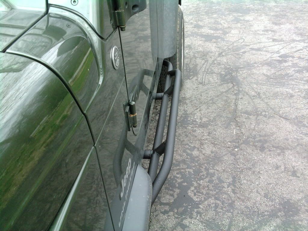

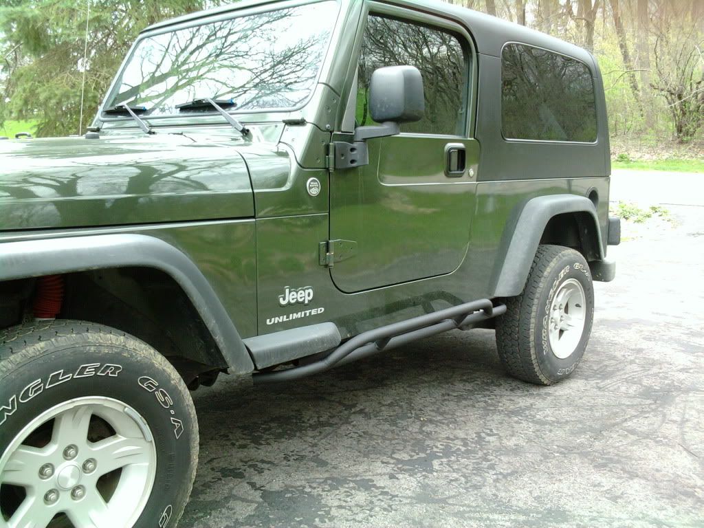

Coated with 3M rubberized undercoating spray.
