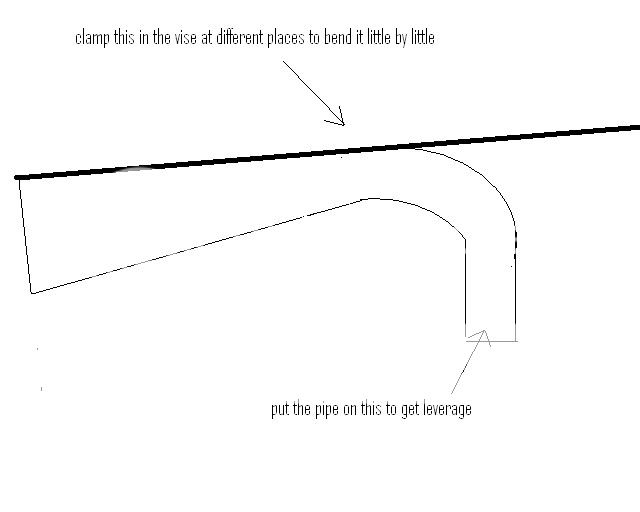

Go out and buy a bench vise. clamp it/weld it on your bench. Clamp the peice you need to bend. Use a pipe to bend it around little by little. each time you bend it a little, weld it up, repeat until done. Like in the pic if you can understand it. No heat required, just a little muscle.
Nevermind, I thought you had an XJ and had a different bumper
