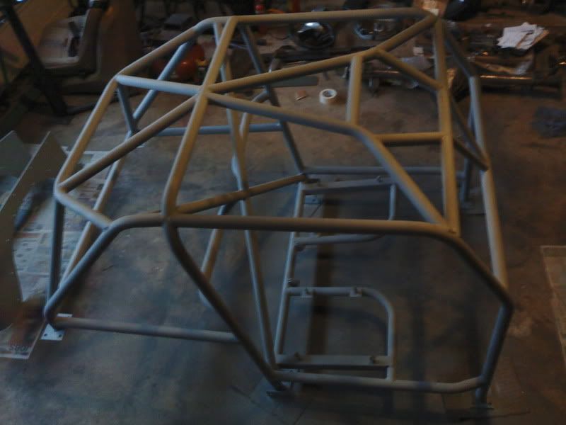

I have a little over 100 ft in mine. I was surprised how quickly the tube disappeared as the cage came together but it really depends on how elaborate and "complete" your cage is going to be. If you just add on to the stock cage it could be significantly less tube as a full cage with seat mounts, harness mounts, etc.
Mine has A-to-B, B-to-C, and C-to-C bars, as well as an X and integrated seat/harness mounts. I bought 110 ft of tube and should only have a couple of feet left in scraps when it's all done. Couldn't have done it without Bend-tech
*Edited with some mostly finished pictures*

That looks great. Lots of triangulation.

Thanks, that was the goal
