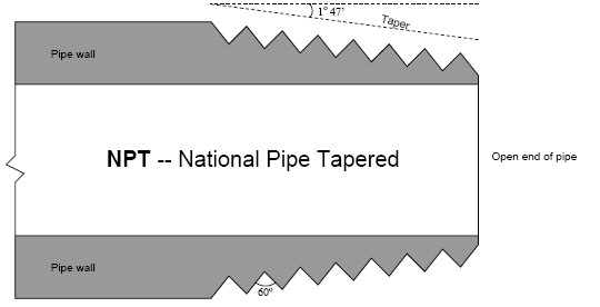

I don't agree that the pipe will bottom out, NPT threads are tapered, meaning the threads are of a different diameter on either ends of the die. Thus you tap until the pipe gets to the back side of the die. ANy further and the first threads won't taper and you might not be able to properly tighten the joint.
Now you can still use the pins to center the pipe, but don't think they were in the way before.

kettles, i didn't know that.
so whatever the depth of the die is is the max depth you'd want to cut a pipe?

Here is a good illustration
They taper so it will become tight and provide a fluid seal. If it had no taper pipes would thread until they bottom out on something, and it wouldn't seal.
