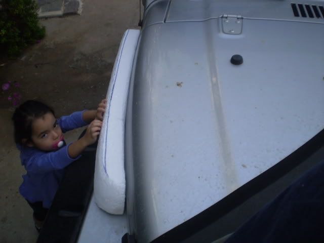

Had some time to play with some foam tha t i had lying around...
The snorkel comes out of the bonnet right next to the stock filter box of
my 2.4(pretty convinient)

Well...if it's me you're asking, i gave up working with foam and going for a
better quality wood template...
Pics soon(Xmas=free time,he,he)
