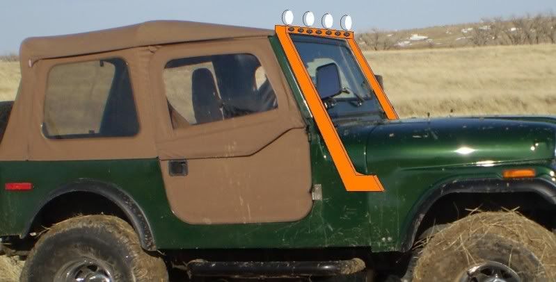

I like the idea of using fiberglass a lot... My thoughts were leaning towards a 2" thin wall tube steel(square or round) up both sides of the windshield with a smaller tube connecting the two to hold lights and/or kayak, with the both of them meeting up under the hood via flex to a factory air cleaner. 3 or 4 breather holes in the front that crosses the top of the windshield.
With fiberglass you can make any shape you like! Lightweight and strong...
This is a rough sketch on paint. I want the top to fold back easily and no interference with the windshield to fold down. I will attach to lower windshield mount and cowl.
