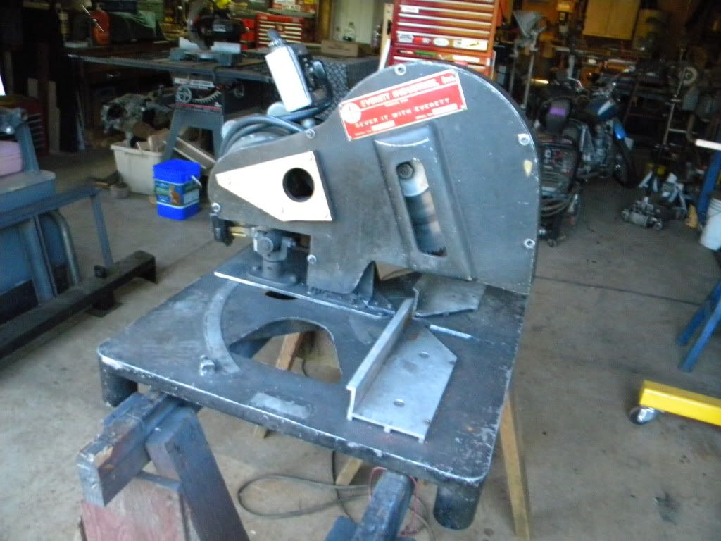

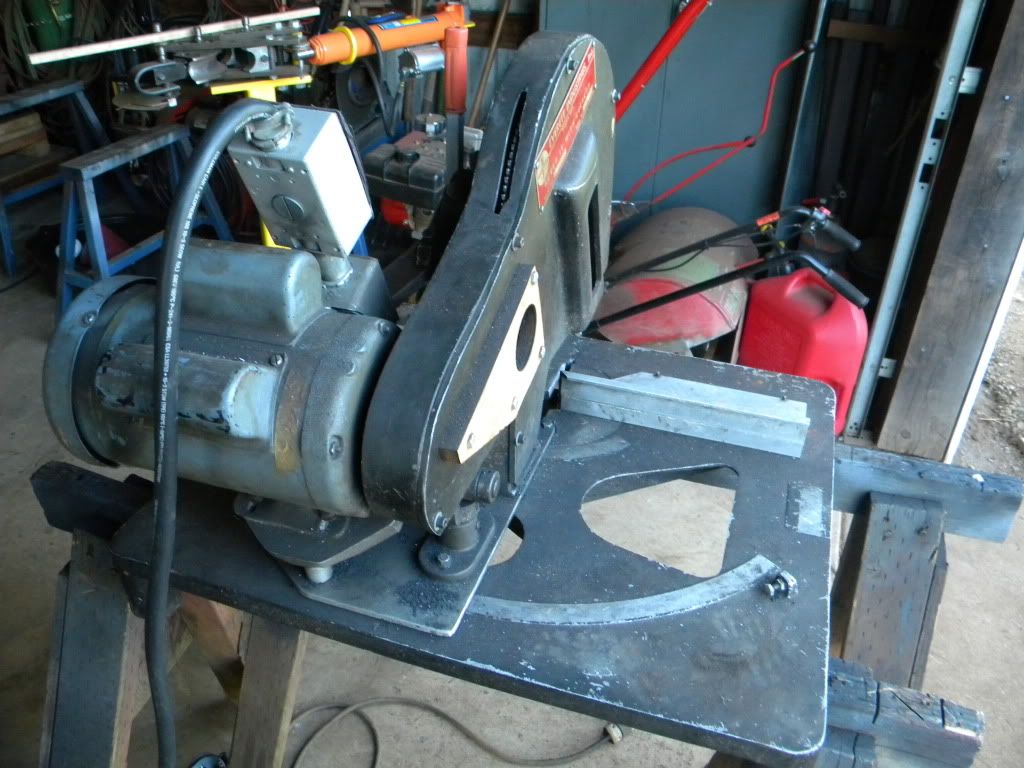

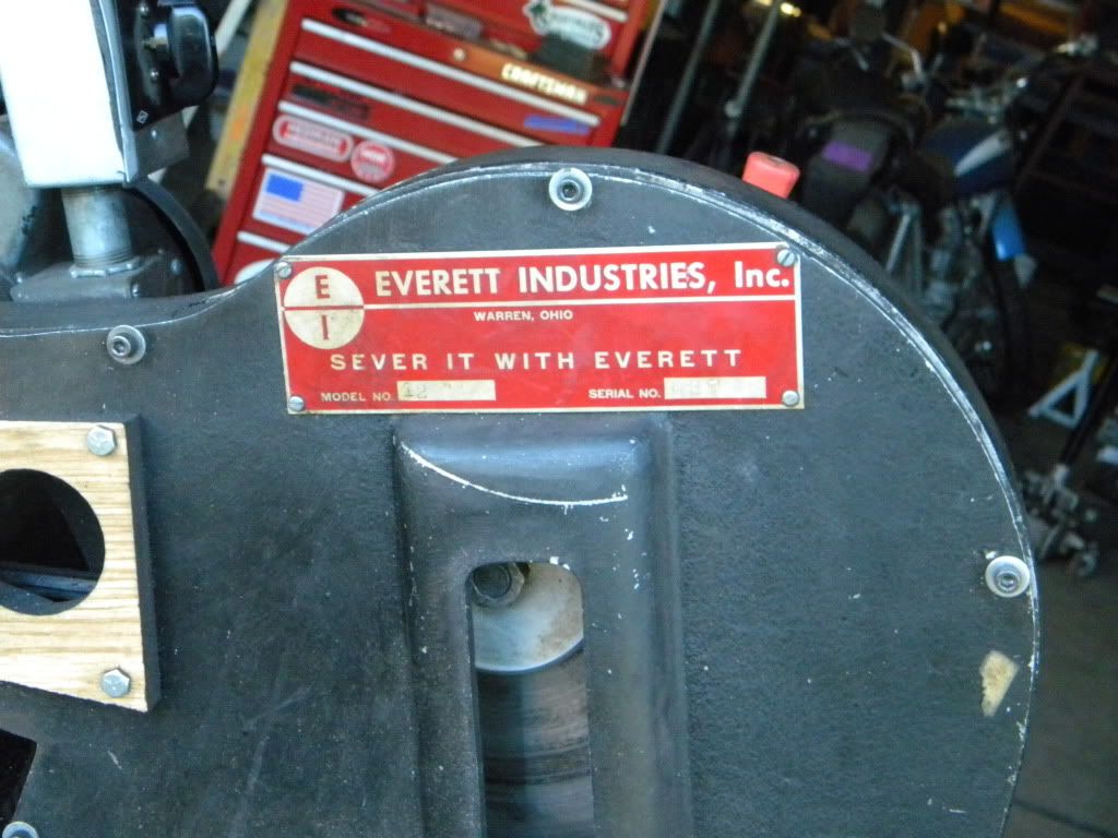

One of the things i did get done this weekend was digging out an old saw from my storage unit, heres some pictures of it. i got it for free from an old local buisness going out of buisness. its an everret industries chop saw set up for cutting aluminum framing for store fronts and what not in commercial buildings i used it to cut steel tho and it worked fine but i would much prefer just my 14" chop saw. plus this saw was 220 so it was kind of a hassle to use it. But i traded it to my step dad for a 4'x8' sheet of quarter inch with a 6"x6" sqaure cut out of one corner and also 3 4'x8' sheets of 11 gauge (1/8") plus i will still be able to use the saw whenever i want so i feel im the big winner, even though the material was free to him from his work, but regardless it was a good score for something i rarely ever use.
