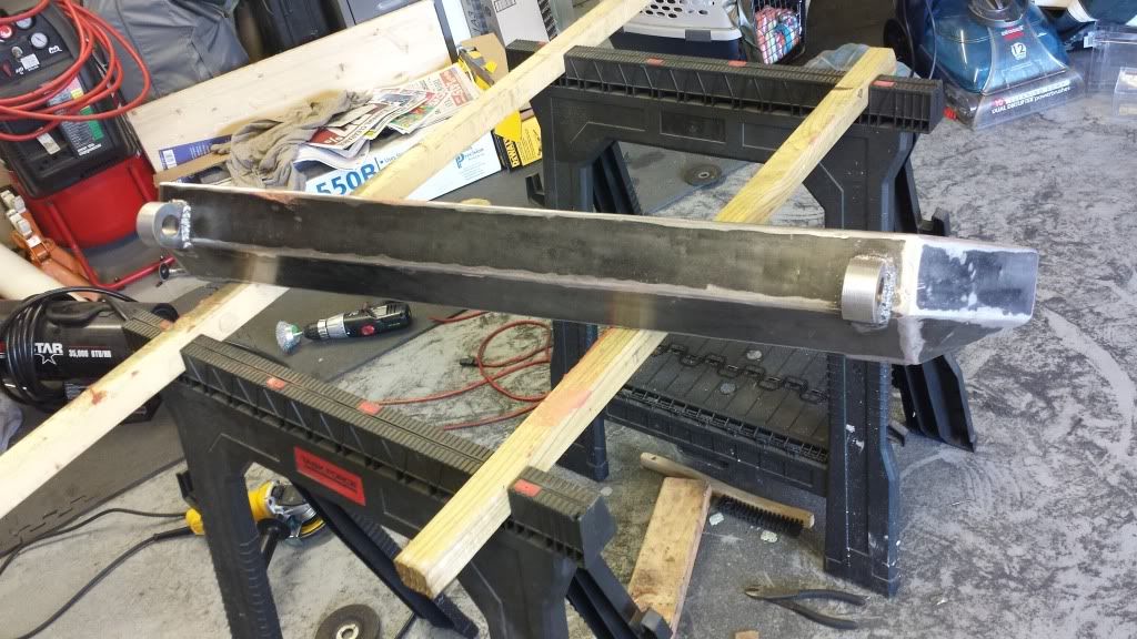

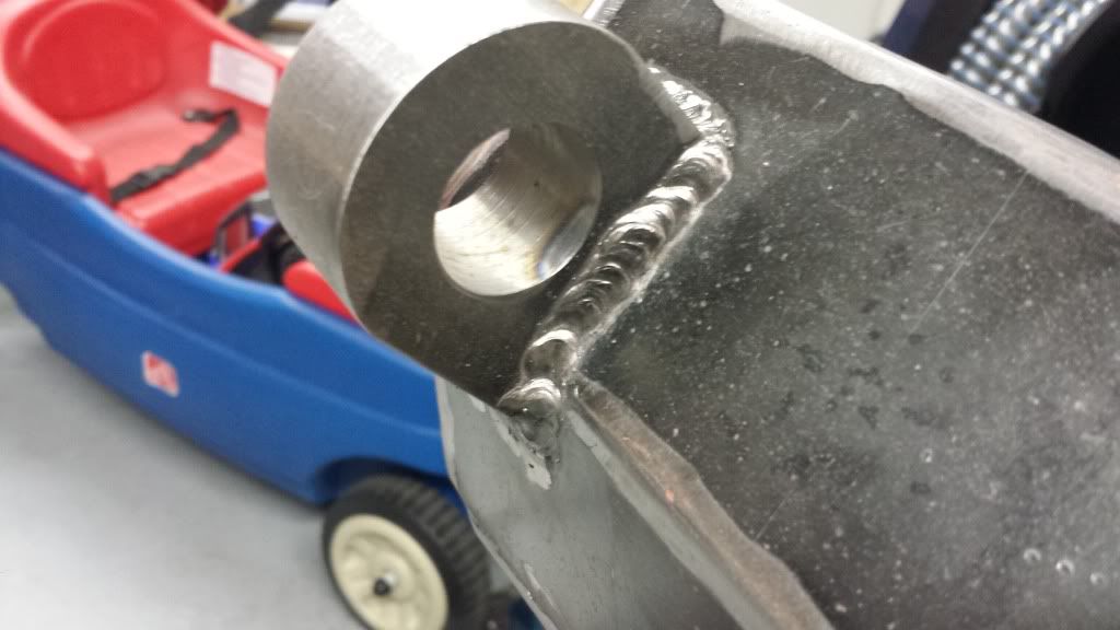

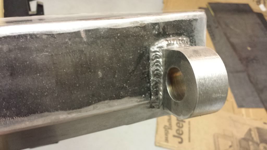

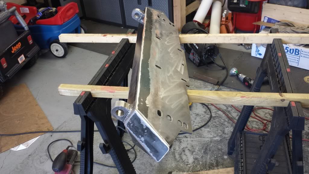

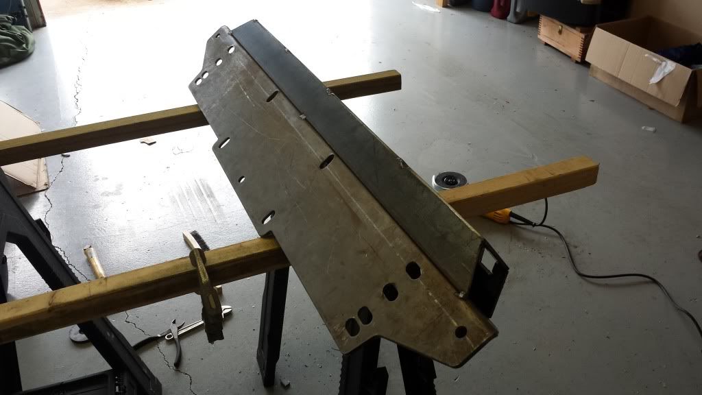

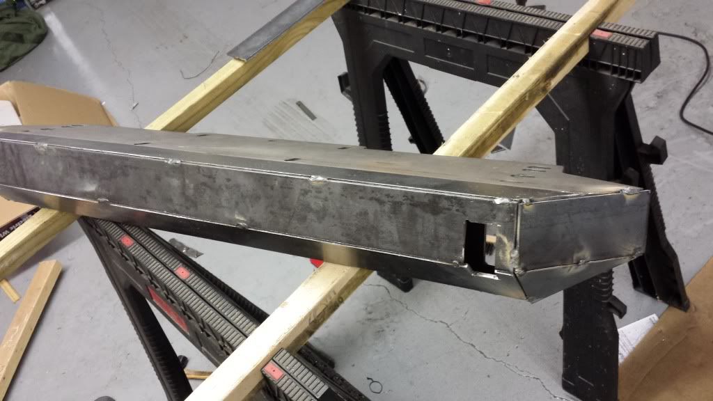

Well i started w/ a little flux core 110 welder and an A to Z fabrication bumper plate. A little in progress pictures because its still hanging in my garage waiting on the bed coating to dry. Ill post up when i get it installed. Suggestion or comments on the clevis welds? Most welds are doubled up on the back at least a few on the front are. Dont mind the mess my garage ended up as a disaster during this.

I would definately test out those recovery points before you need them. It's not so much that the weld looks good, it's the penetration into the material. 110v even with flux core is going to have a hard time digging into 1" steel, if at all. Just my .02

I know that worried me too. When I was welding into the recovery mounts I was trying to put a lot of heat into the clevis mount to get as much penetration as I could. Then welded on top of that first weld back into the clevis mount. I kinda wish I coulda welded front and back of the back but I just didn't plan it out well enough.
