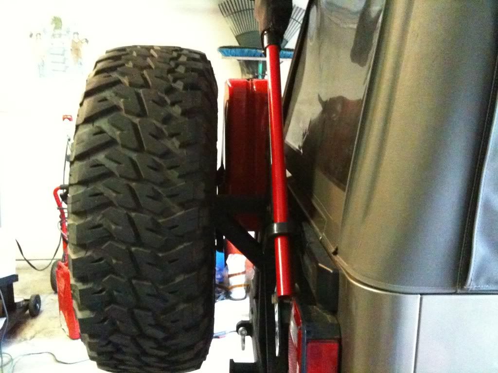

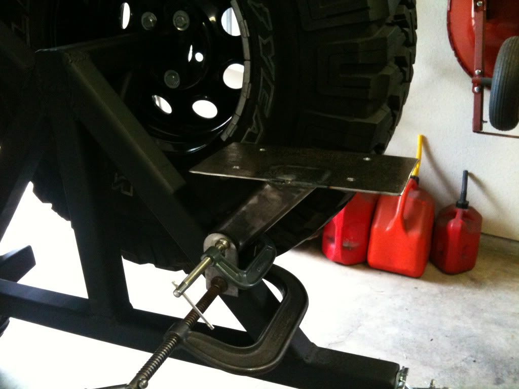

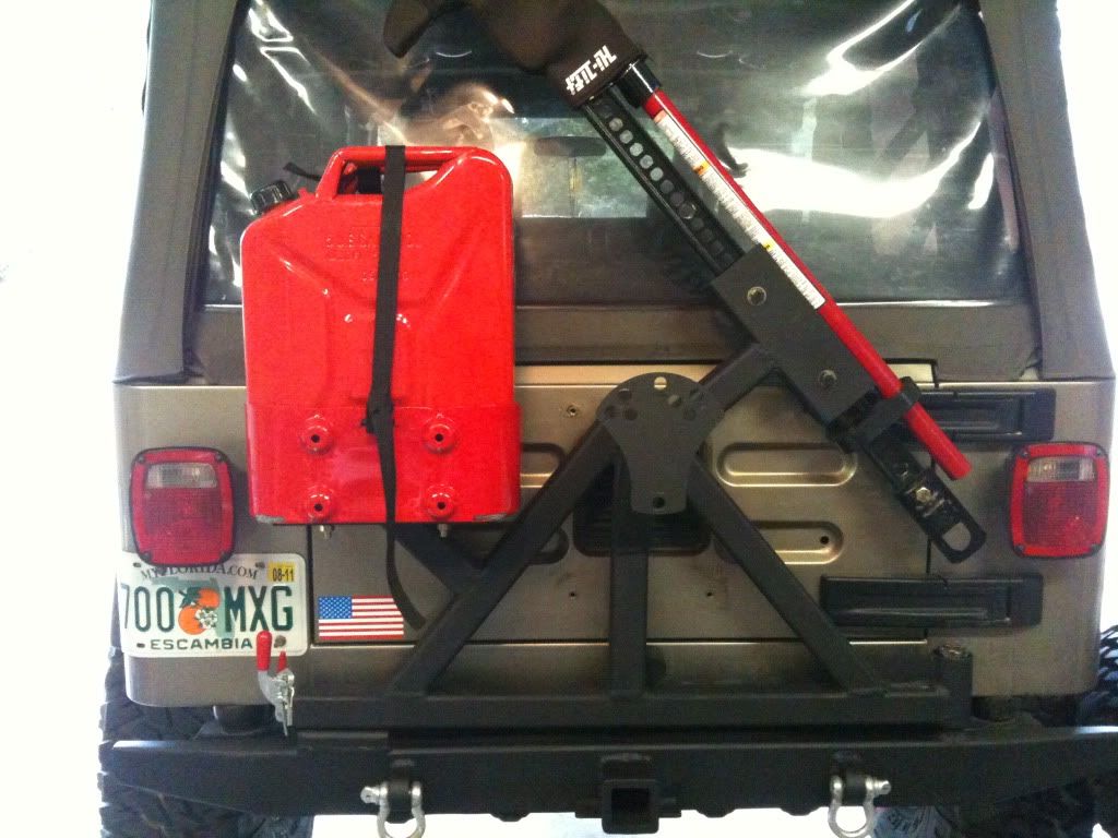

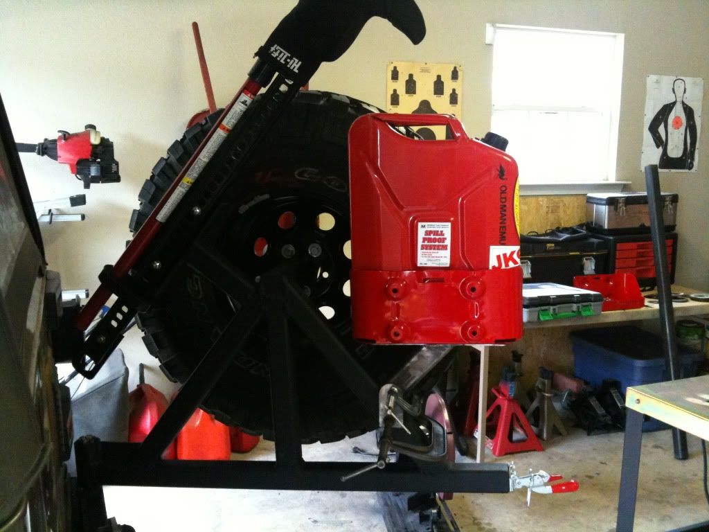

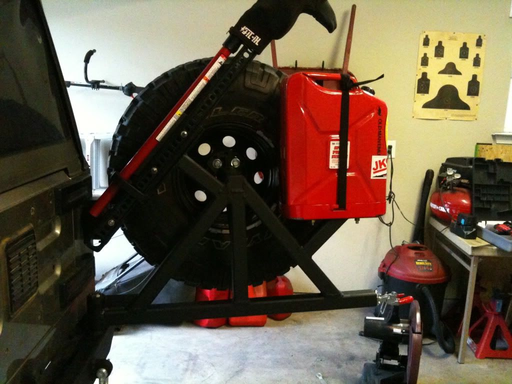

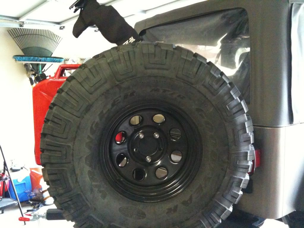

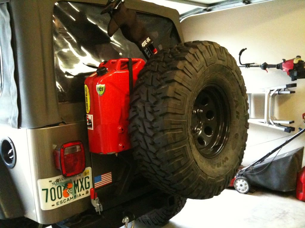

Thanks everyone for all the compliments. My gas can mounts finally came in. So I spent a couple hours adding it to the carrier:
Only thing I have left now is a spring latch that Ill weld onto the spindle. It keeps the carrier locked open or closed.
For anyone that got to see it up close, I originally had a small oversite where the tailgate would touch the spindle when it was half way open. I fixed that by shaving about 1/16" off of one side of the castlated nut. Now it opens all the way as it should. I also had an issue where the hi-lift would hit the tail light if the carrier was opened all the way, I just flipped the hi-lift to the inside of the mount and no more problems.
