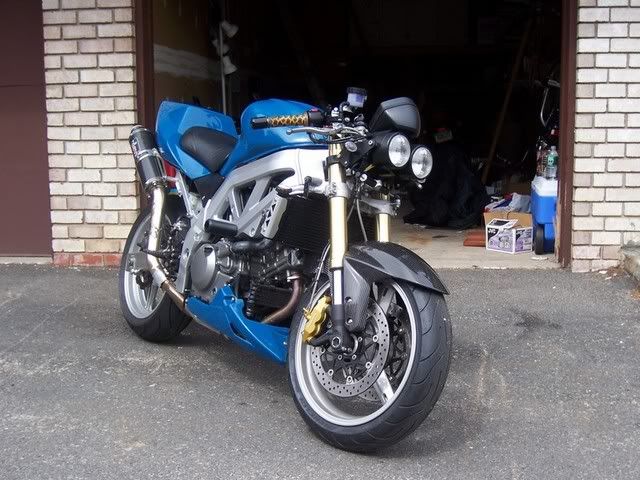

Here's mine, minus the Poly26 chin:
So...do you guys see any major flaws in my design?
