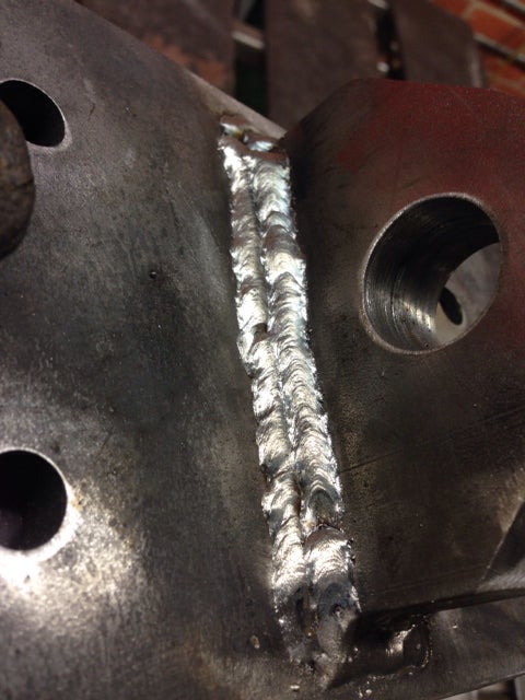

For the recovery points, I decided to try my hand at a little multi pass welding. Cut and drilled some 1/2" baseplates, and cut the tabs out of 1"x4" cold roll.
Used a 1" hole saw and a TON of cutting fluid, they turned out better than expected. And the three passes burned in great...minus one small issue. (See other thread &#128541
Painted, grabbed some 1/2" grade 8 bolts, and boom! Doneskies.
Overall I'm real happy. I do plan to remake this someday, probably will make it lighter. But for now, bumped!

Now that I'm finished, I find myself paranoid about my recovery points. I laid multiple fat passes on them, but only welded the front side. Given that these, if the welds failed, become highly lethal projectiles during a recovery, should I remake them welding the tabs through the base plates? Or is this just neurosis?

I was thinking it would be a good idea to cut a slot in each of those bolt on plates so you could also weld the backside..
AtTheHelm is offline
post #24 of 33 Old 02-08-2014, 09:59 AM Thread Starter
Dumpsterfish
Location: Los Angeles
Posts: 1,028
Me too...problem is making that cut. Our plasma can't go that thick.

Me too...problem is making that cut. Our plasma can't go that thick. Sent from my iPhone using JeepForum
You could drill two 1/2" holes in each one and cut the slot with a grinder.
Thought about that. Sounds like a pita. But I shall check it out.

probably not a bad idea, you don't know how much force is going to be put onto them, best make them as solid as you can right?
