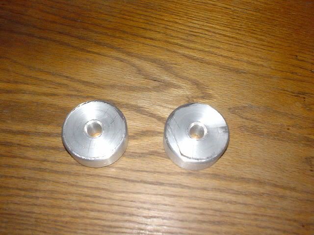

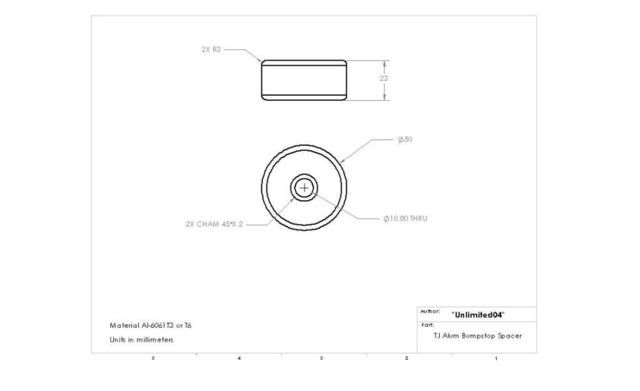

made some TJ aluminum bumpstop spacers with coconut oil (basically copied my OME's). can show CAD drawings if anyone is interested.
im interested. where can i get a program so i could put some of my own ideas "on paper". and how much would it cost me?
