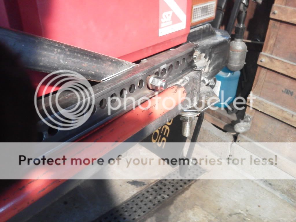

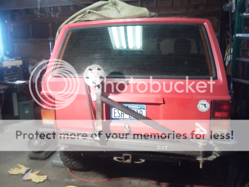

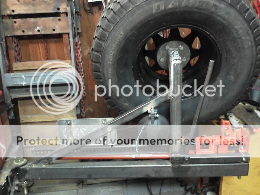

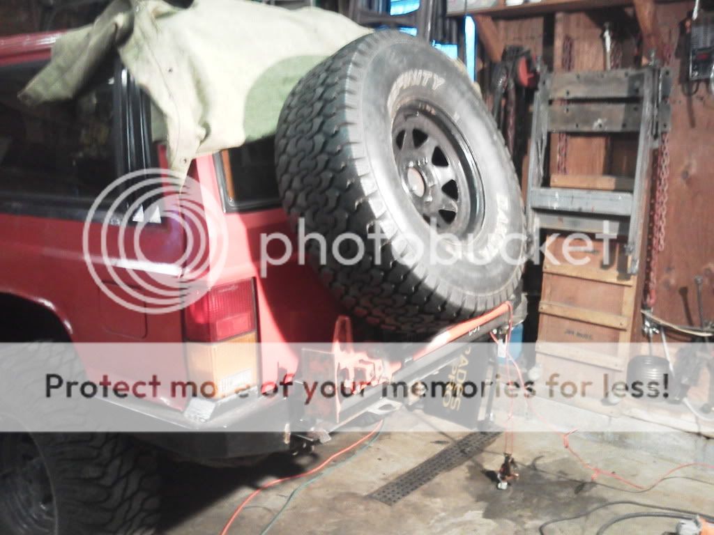

Got a fair amount done today. Arm triangulated.
Everything back on.

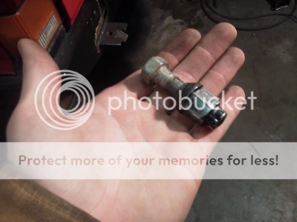

Decided to use a lug nut to hold the other end of the Jack, this way I can use one the stock lug nut wrench to remove the jack.

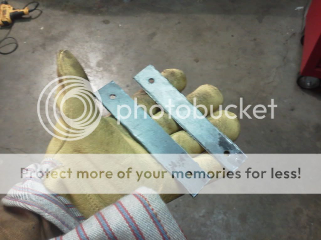

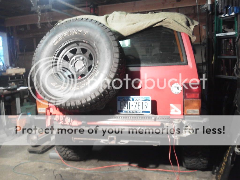

Made some liecense plate brackets.
Welded on a back up light tab too.

look great!
Isn't not having your license plate illuminated illegal?
what is you bumper made out of? does it flex because of the weight at all?

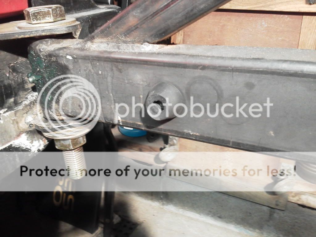

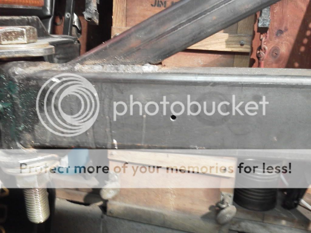

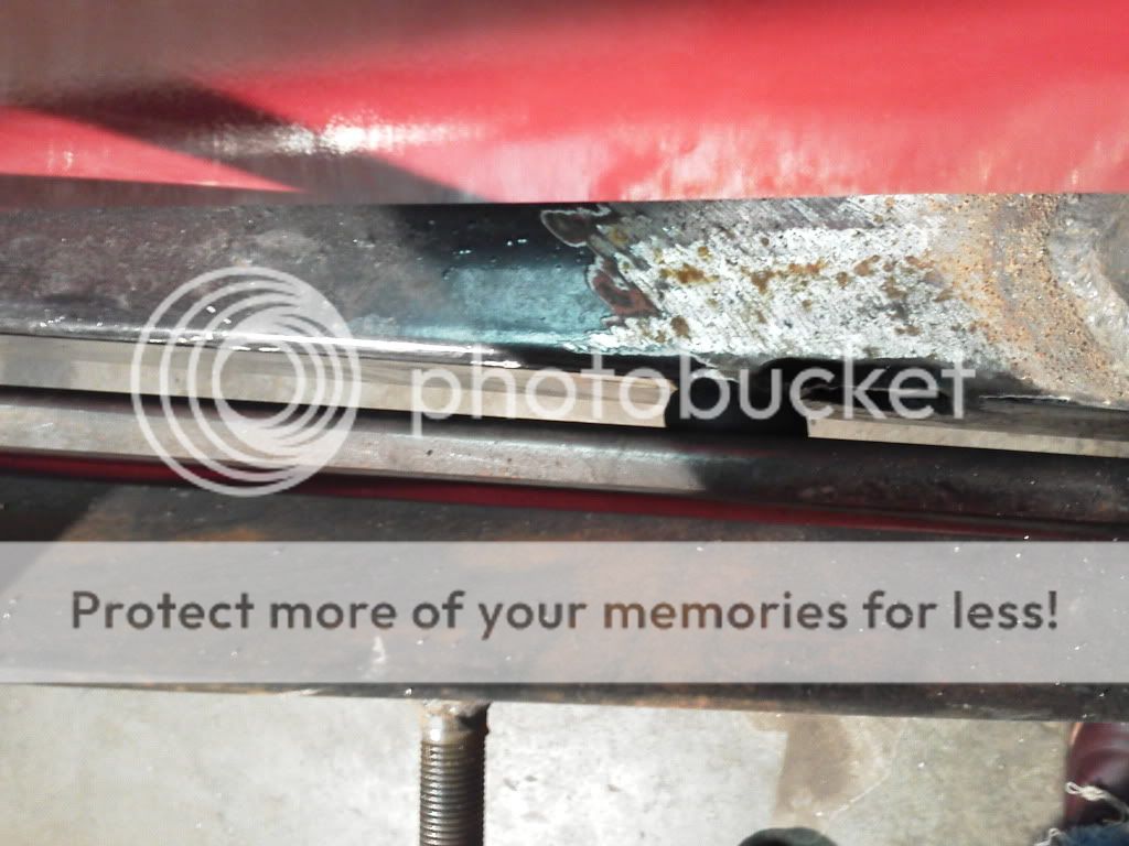

Also got some little rubber bump stops.
Tapped a hole.
Cut down the bumpstop, recessed a washer and bolted in with a 1/4" bolt, this will work nicely! This will make up for any changes in latch/hinge tolerance.
