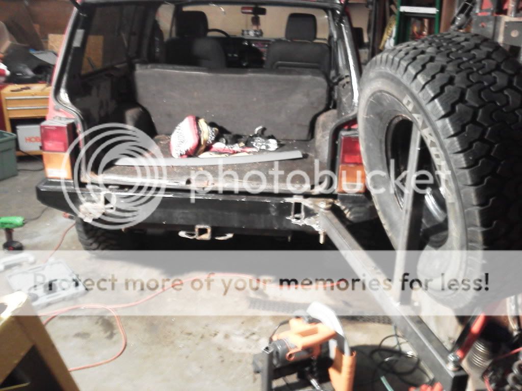

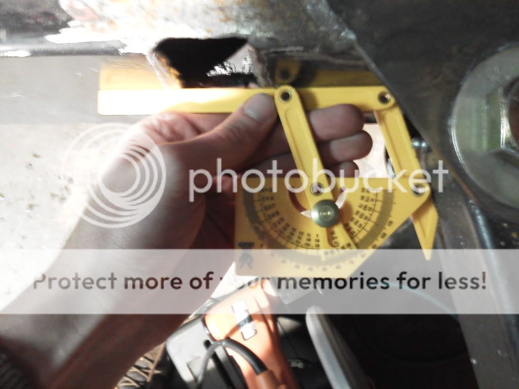

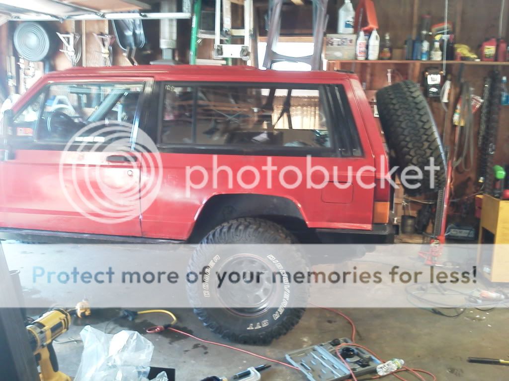

So, how far do u have to open the tire carrier to clear the hatch? 90 degrees? 120?
I do like some of your ideas. designing my own, just checking hinge location on yours.

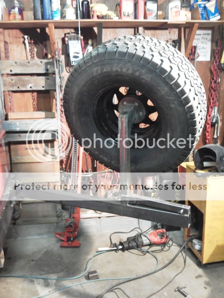

post #32 of 251 Old 02-25-2012, 10:16 PM Thread Starter
Hussler
1992 XJ Cherokee
Location: utica, new york
Posts: 5,292

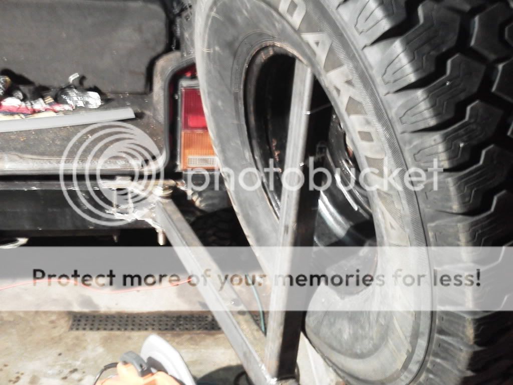

105 degrees until I could open it
It will be closer or less than 90 once the tire is mounted proper. I just set it on the post for effect.

Thank you very much! Pictures in the garage, worth a 1000 words. thanks!
I have limited clearance, on the passenger side at times when parked.

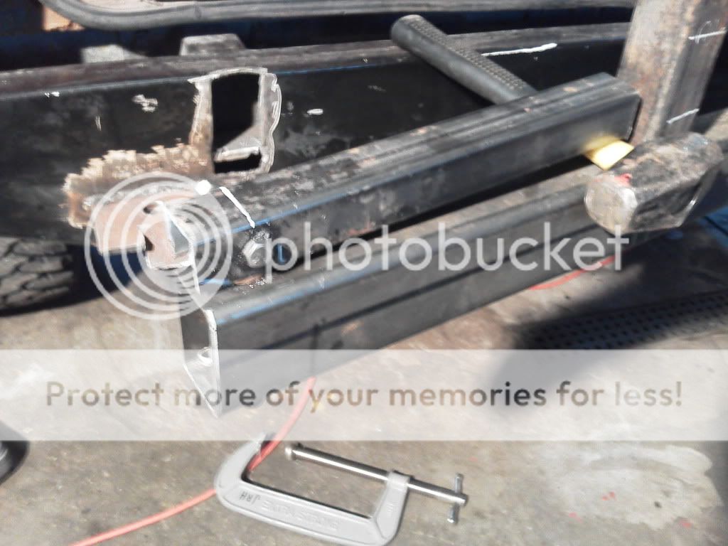

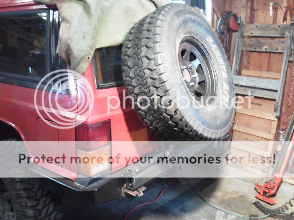

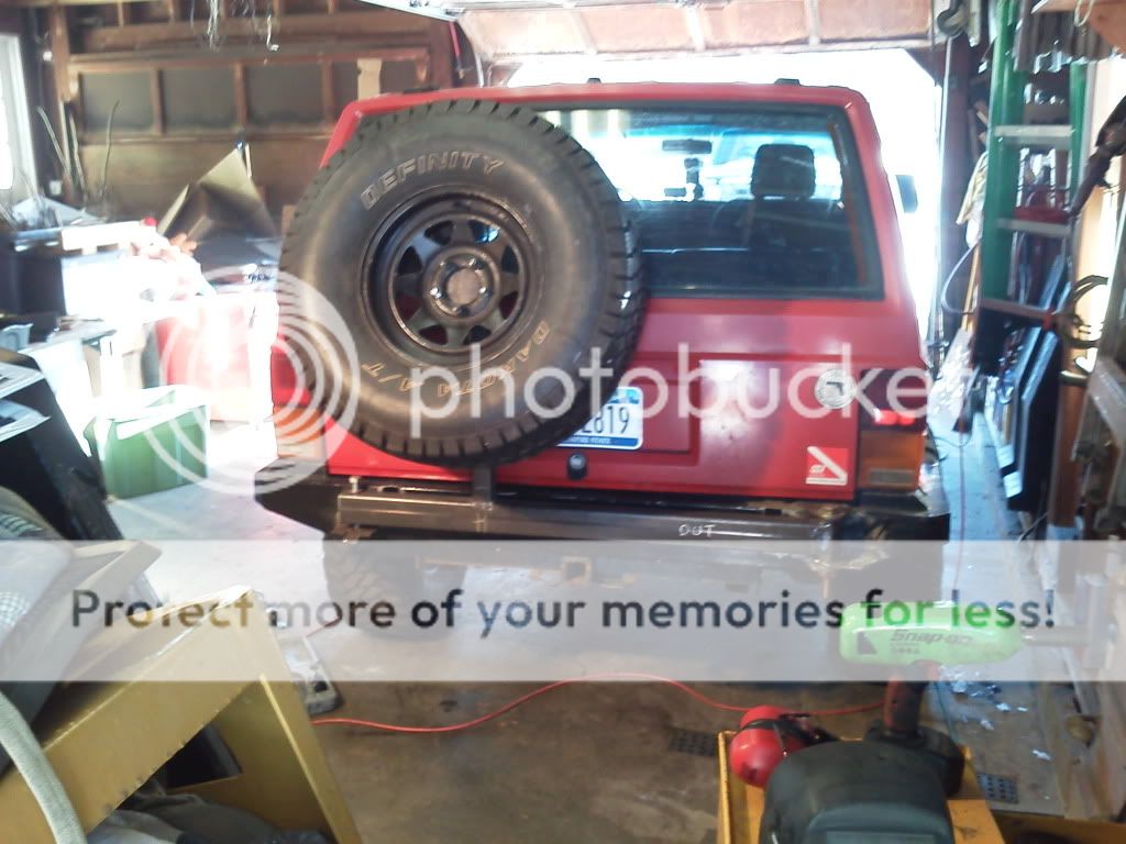

Got quite a bit done toady. Probably 30% done overall, I have a LOT to go.

post #35 of 251 Old 02-26-2012, 06:05 PM Thread Starter
Hussler
1992 XJ Cherokee
Posts: 5,292
105degrees until the tire clears.

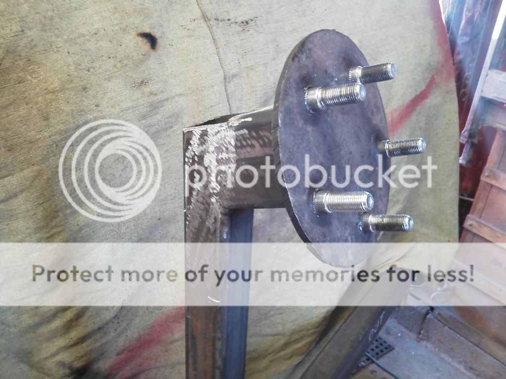

Final mounting location
Hussler is offline

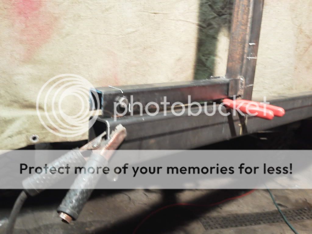

post #36 of 251 Old 02-26-2012, 06:08 PM Thread Starter
Hussler

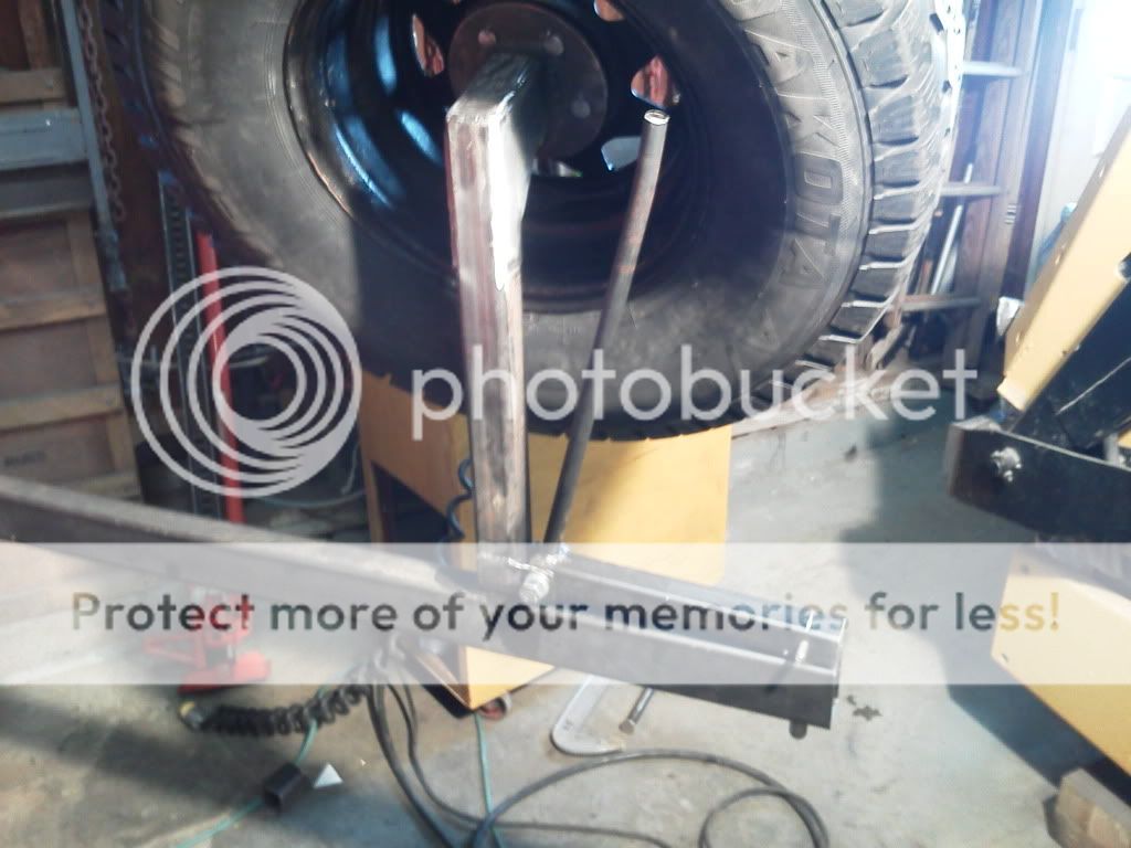

1992 XJ Cherokee
Posts: 5,292

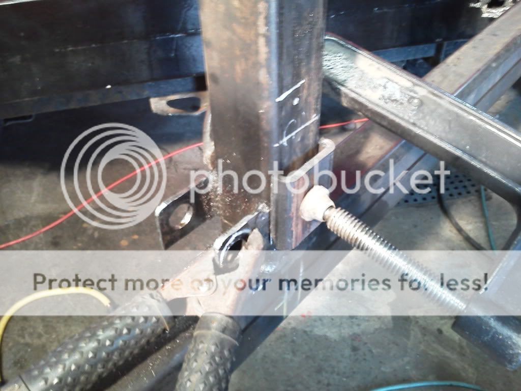

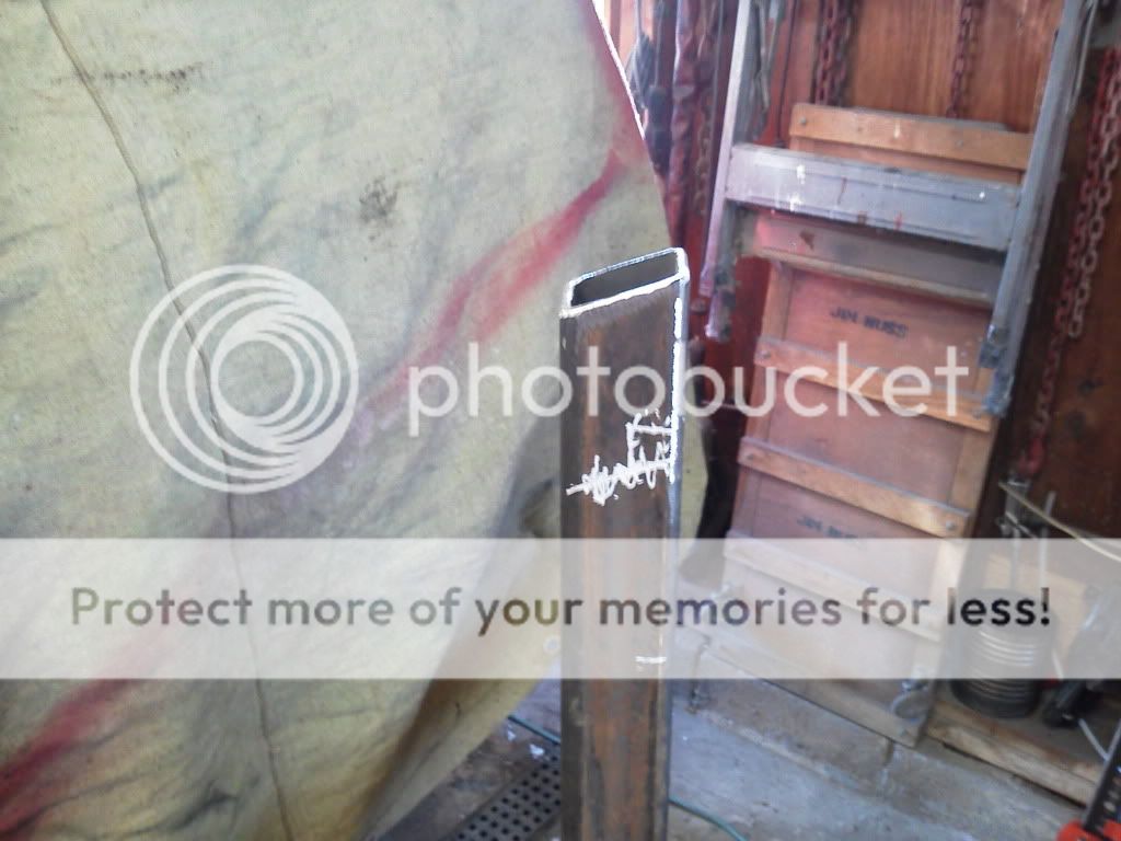

Added gusset to the top
Also added a sleeve to the receiver
Added the lever
Hussler is offline

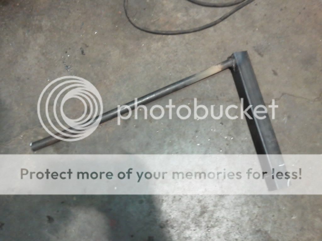

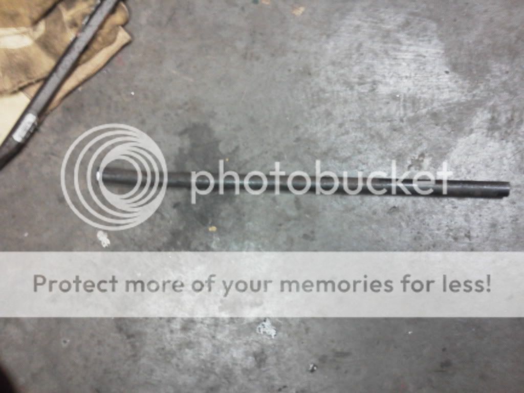

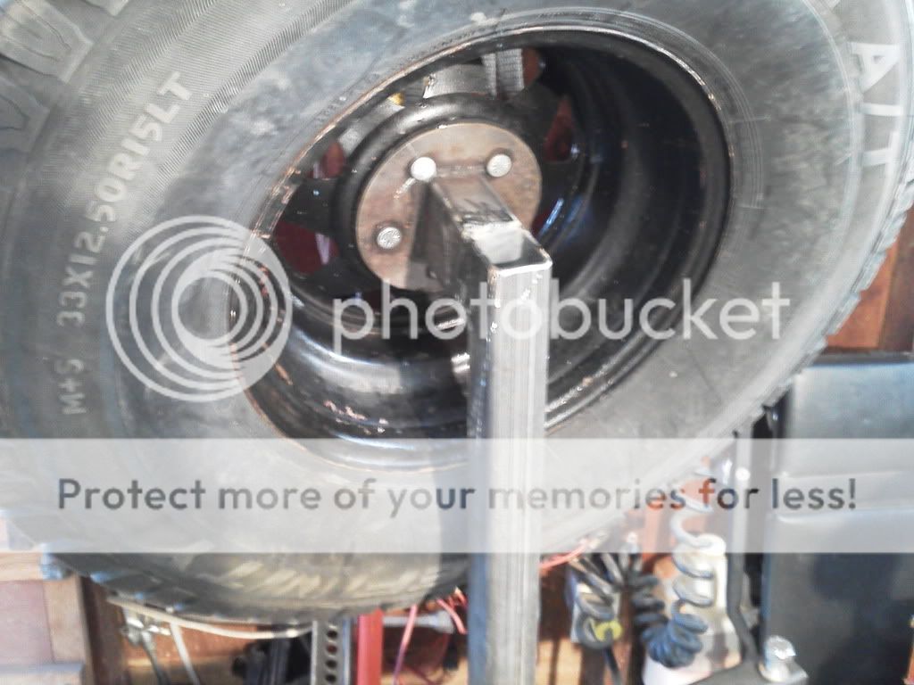

post #41 of 251 Old 02-27-2012, 09:37 AM Thread Starter
Hussler
1992 XJ Cherokee
Posts: 5,292

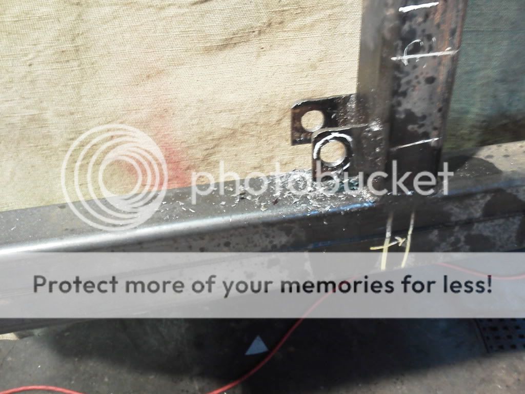

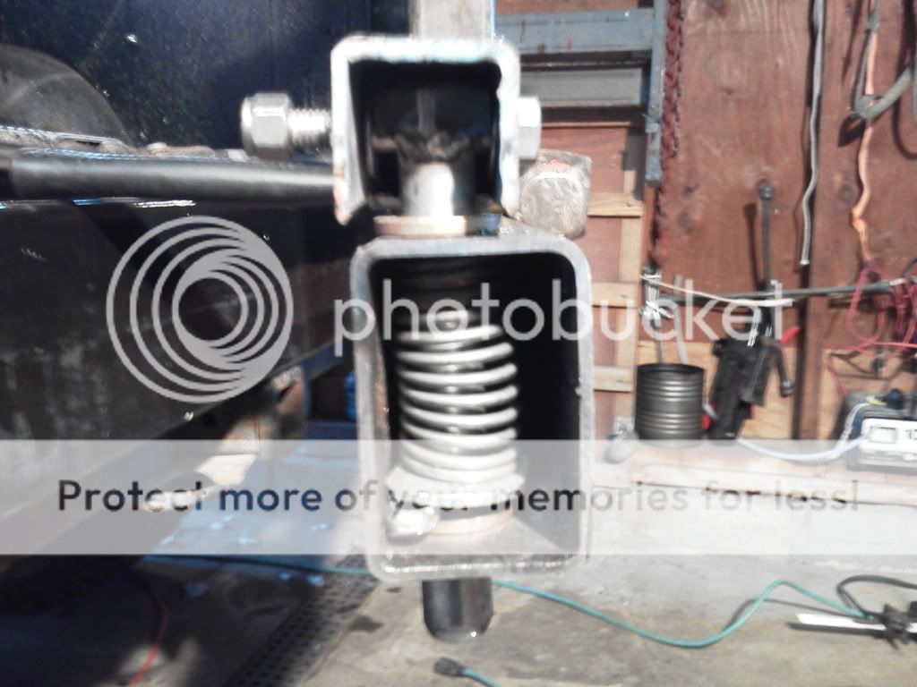

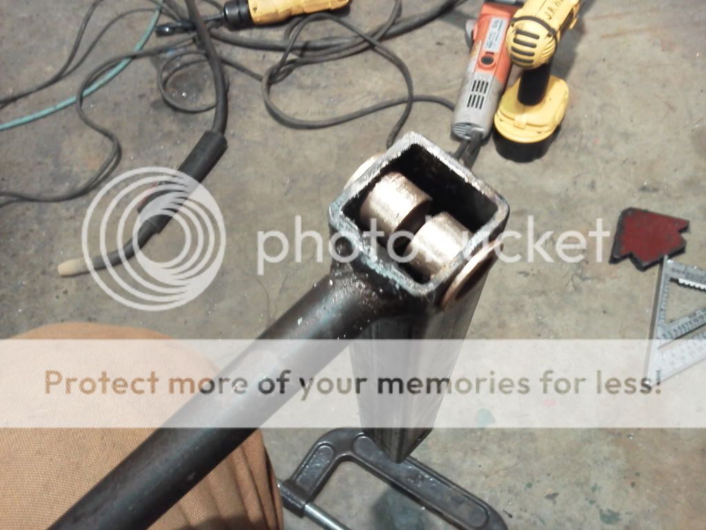

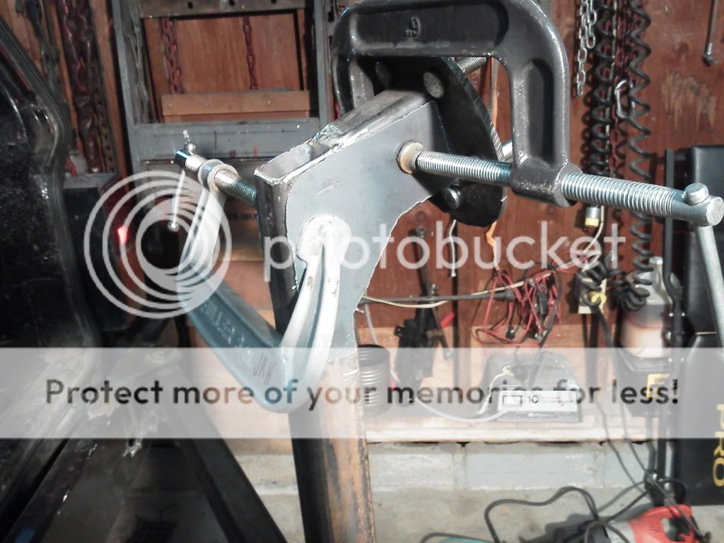

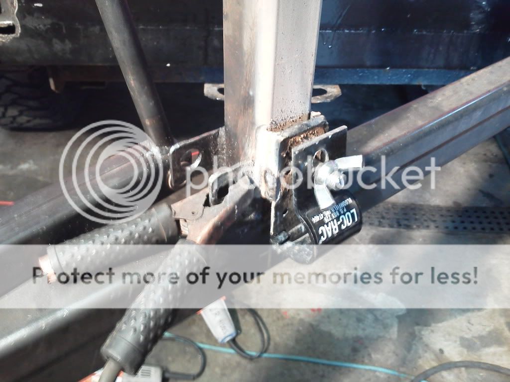

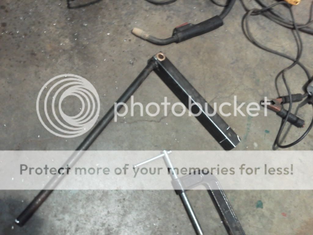

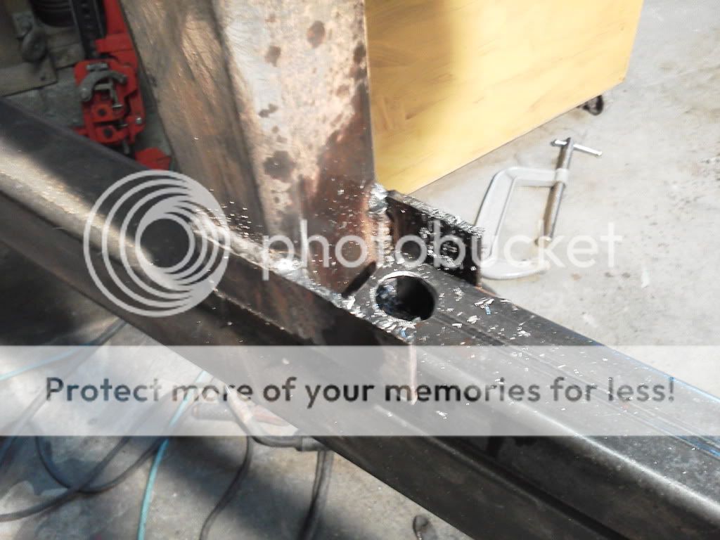

Just taking a lunch break from this. It will take some time to break in but the latch is working as planned.
Arm I made for the lever. Just 3/4 round solid stock.
Hole I drilled for it, wanted to weld it on both sides.
All welded together.
Drilled the holes and pushed in the bushings.
Starting to look like something now!
Bolt holes drilled out. This turned out to be quite the *****, I forgot I made the lever have about .10 camber towards the left side so I drilled the hole straight. Just needed some reaming.
Assembled. Turned out PERFECT. The lever is very hidden but easily accessible and operate. Once I have the high lift mounted over the mechanism nobody will know how it operates. Last pic is a vid on it in use.
VIDEO VVV

How much shake/vibration is there at the connection? How tight is it? Say if you were to start yarning on the tire, like when you offroad/drive the Jeep.

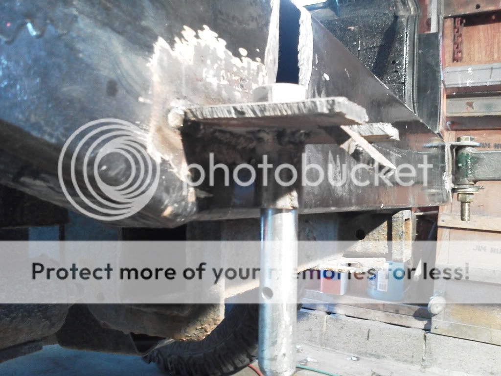

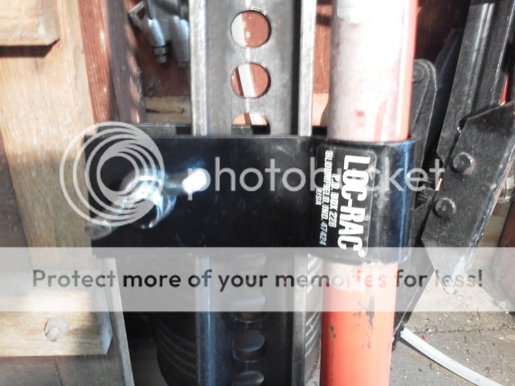

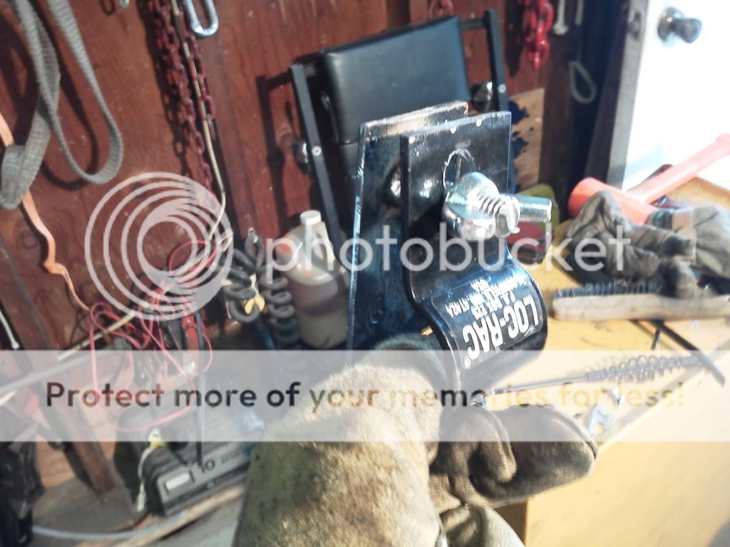

post #44 of 251 Old 02-27-2012, 06:40 PM Thread Starter
Hussler
1992 XJ Cherokee
Posts: 5,292
Originally Posted by XJ-Tim View Post
hey Hussler, suck on this!
good luck with the build ill be following closely!

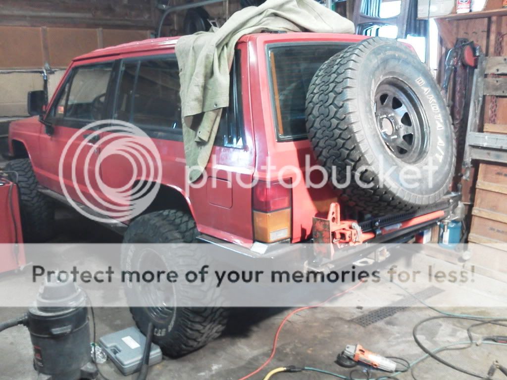

I see your done carrier and raise you one hi-lift jack.
Spacer.
Stupid jack lock. Had to modify it because stock doesnt make any sense.
Had to make my hi-lift a mid-lift
There will be another bracket at the end, just ran out of time for tonight.

Zero vibration/movement. I will be putting in bump stops because eventually it will have some play, it is inevitable.
