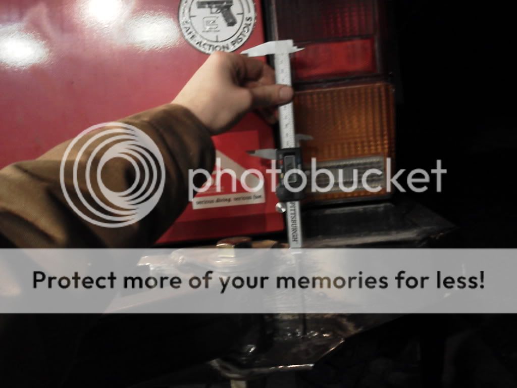

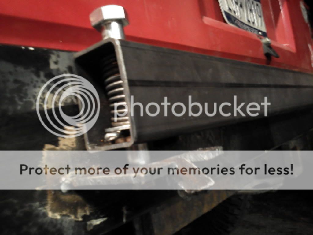

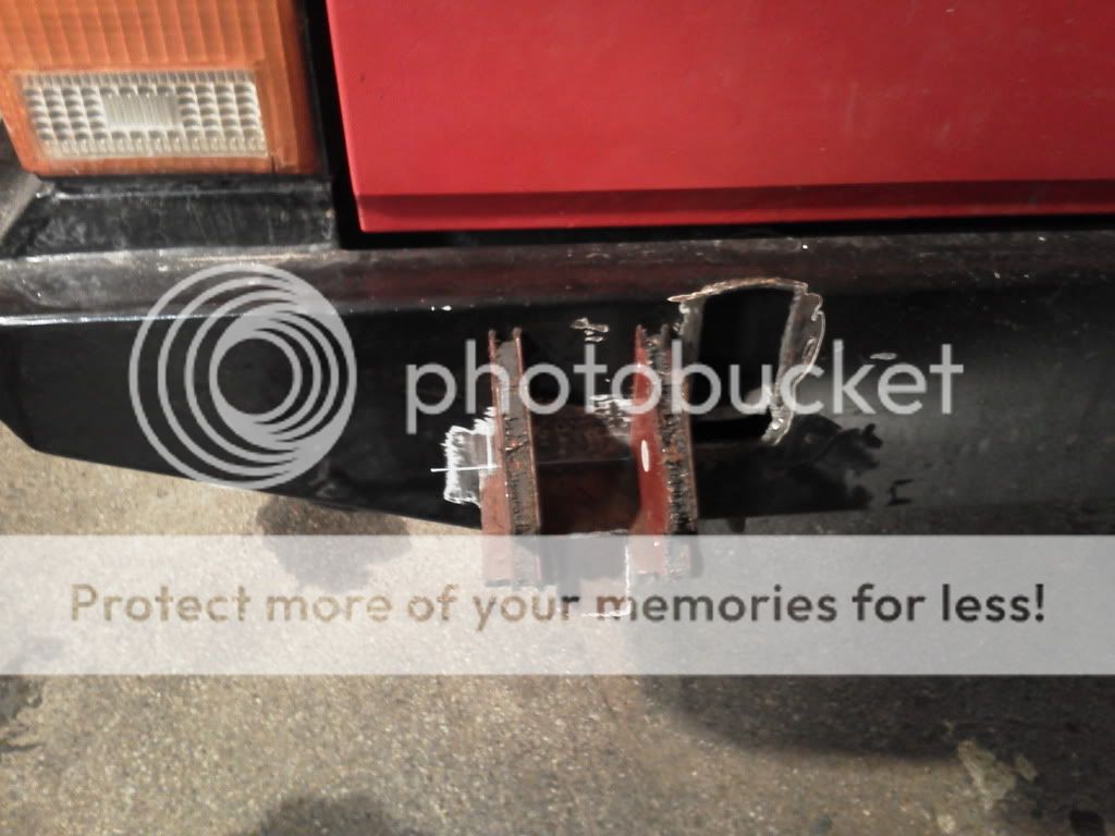

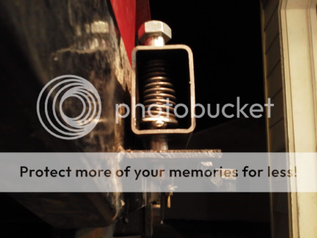

Got some more done

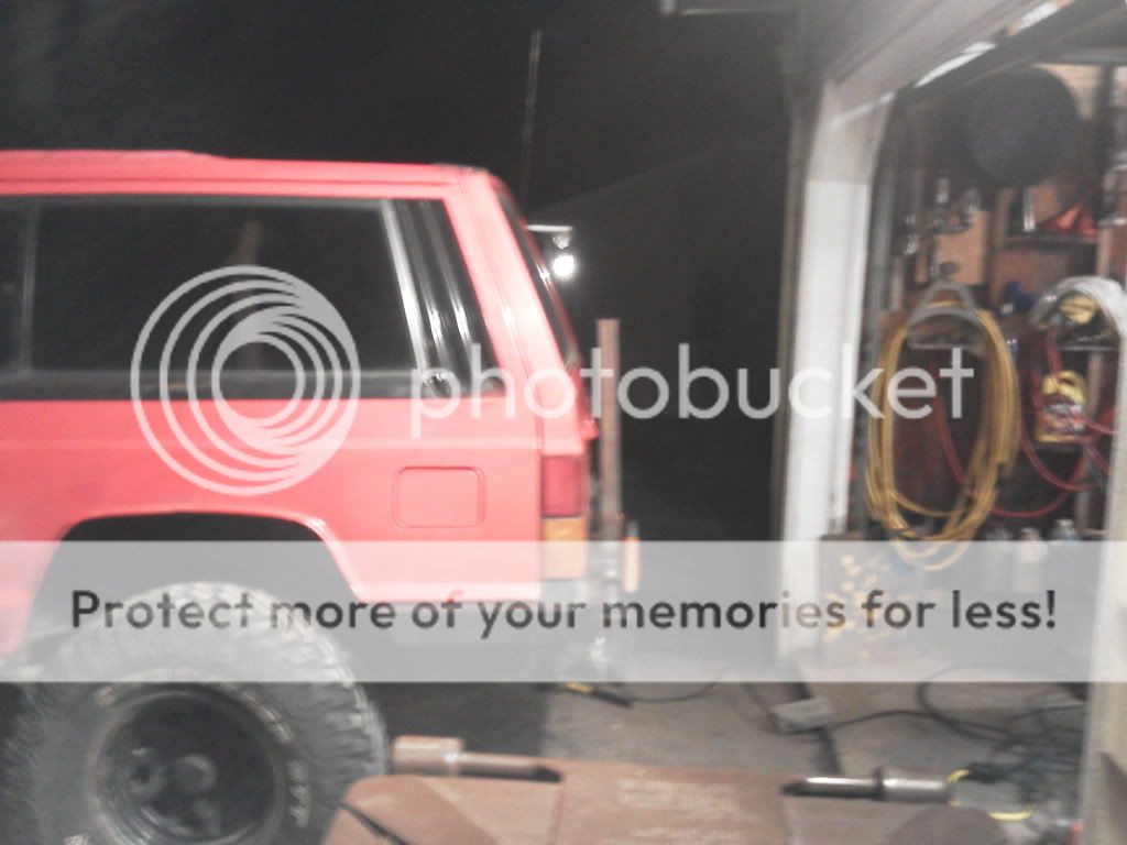

Making the receiver plate
Making sure the swingarm will sit level when its in the receiver
Welding the receiver

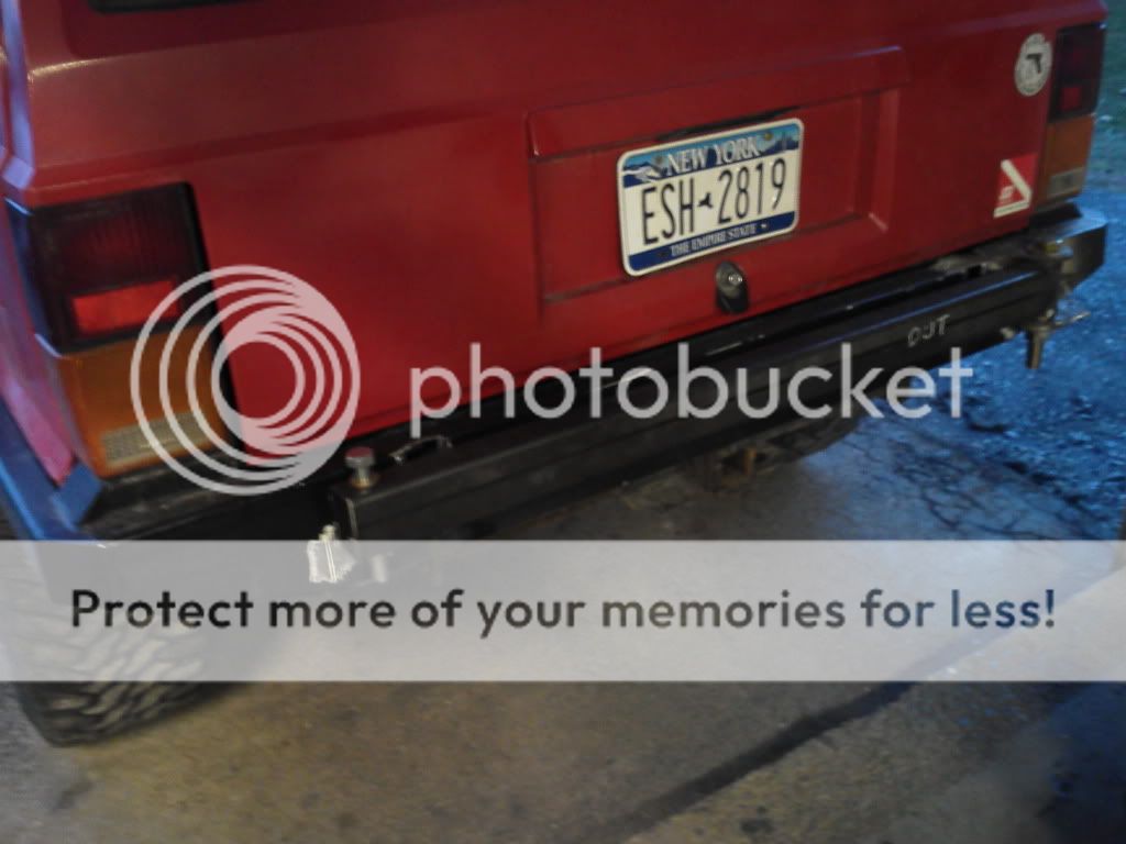

post #19 of 251 Old 02-25-2012, 02:11 PM Thread Starter
Hussler
1992 XJ Cherokee
Location: utica, new york
Posts: 5,292

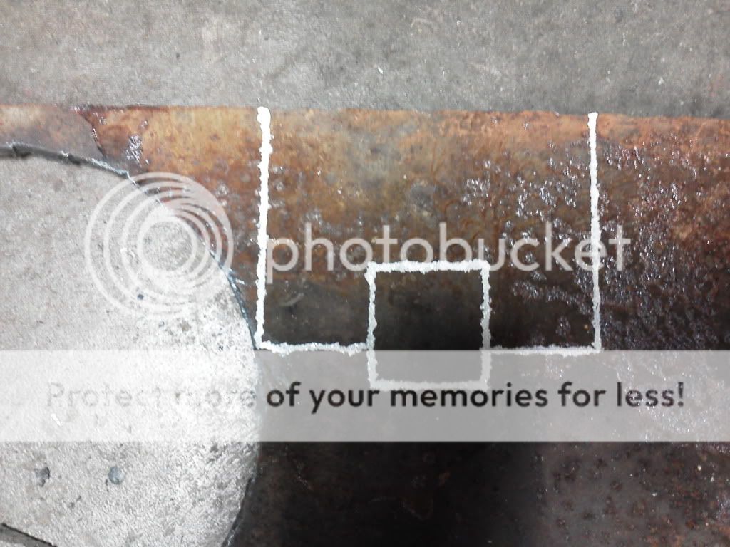

Hole drilled, receiver fits nice!

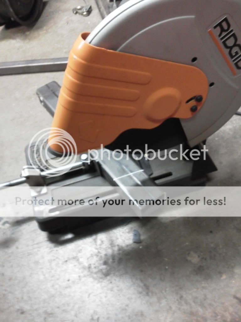

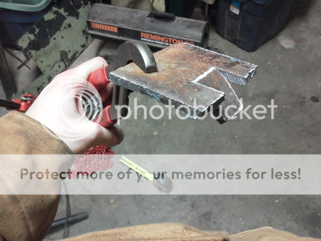

post #20 of 251 Old 02-25-2012, 02:14 PM Thread Starter
Hussler
1992 XJ Cherokee
Posts: 5,292

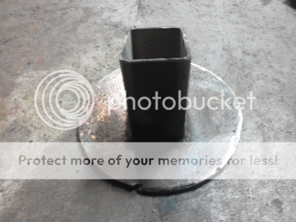

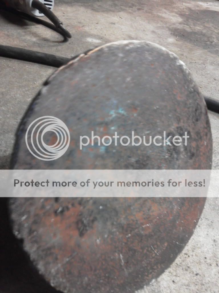

Rough cut tire arm, not quite sure where the tire will end up sitting.
Cut the tire mount section and welded to the plate
I welded both inside and outside the tube. It got so hot the plate turned a goldish color.

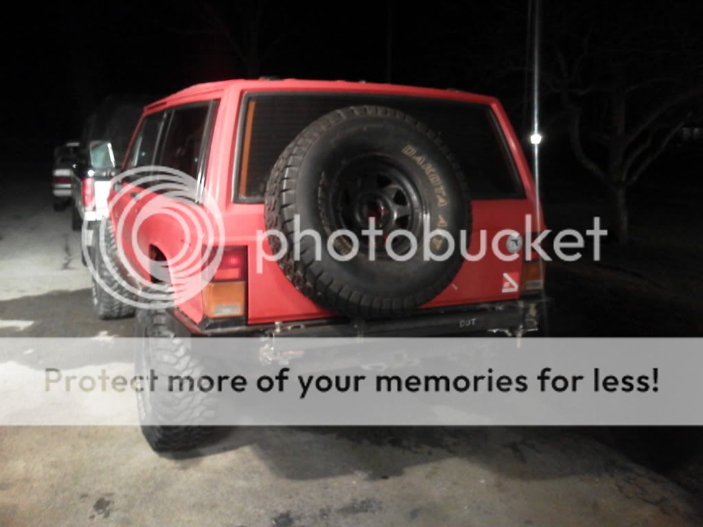

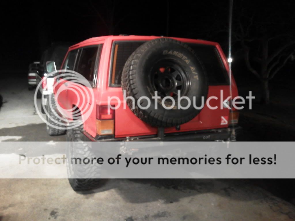

Figuring out how high I want the tire, what do you guys think?

post #22 of 251 Old 02-25-2012, 04:41 PM
cascadesdreamin
Location: Waynesboro
Posts: 110
Exactly between those two positions. Centered from top to bottom using the hatch as the background (not including the bumper)
Imagine the back window and molding is red...same amount of red showing on top as is showing on bottom.
cascadesdreamin is offline
post #23 of 251 Old 02-25-2012, 04:42 PM
DoctorTim
Location: Huntington Beach
Posts: 2,457
first one looks better.
96 XJ, geared, 8.8, 5", 33s, dash
DoctorTim is offline
post #24 of 251 Old 02-25-2012, 04:44 PM
DoctorTim
Posts: 2,457
hold on.... why dont you have a full size spare??....
post #25 of 251 Old 02-25-2012, 04:48 PM
Anticanman
RIP one good jeeper
Anticanman's Avatar
Location: Ripon
Posts: 20,368
I vote lower. If you care what a former xj owner thinks.
Luck Favours The Prepared
Anticanman is offline
post #26 of 251 Old 02-25-2012, 05:39 PM Thread Starter
Hussler
1992 XJ Cherokee
Posts: 5,292
I think I'm going to mount it just about in between those two. I want it to be below the profile of the roof curve to reduce wind noise. Working on mounting the studs into the plate right now. Brb with pics
Originally Posted by chris87xj View Post
Sometimes a restoration project is a labor of love, at which point cost, time, and labor involved become irrelevant.
Originally Posted by BorderC View Post
I see you also twizzled your scart lead. Well done! :thumbsup:
92 XJ with ARB's, 5" lift, too much armor, 33's and some other garbage
Hussler is offline
post #27 of 251 Old 02-25-2012, 05:41 PM Thread Starter
Hussler
1992 XJ Cherokee
Posts: 5,292
Ha, its the same size just a different tread pattern. 31.8 across for the stts and that dakota
Hussler is offline

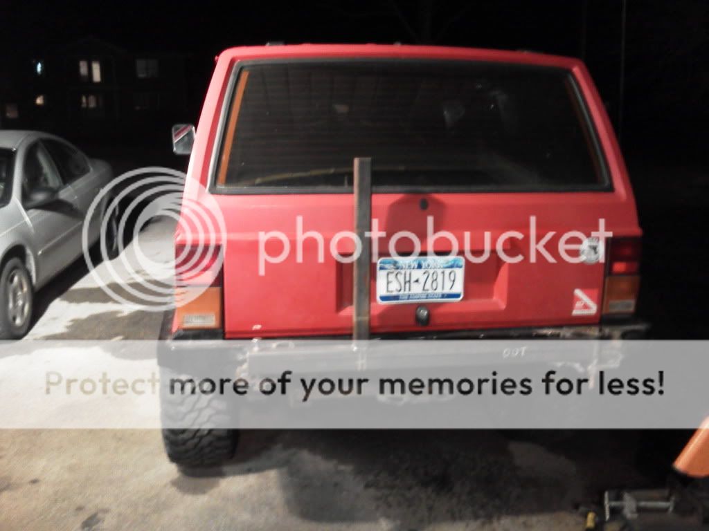

Does the hatch clear the tire when its open?
Yep, thats why the hinge is opposite the tire. This also allows the tire to be in your natural blind spot

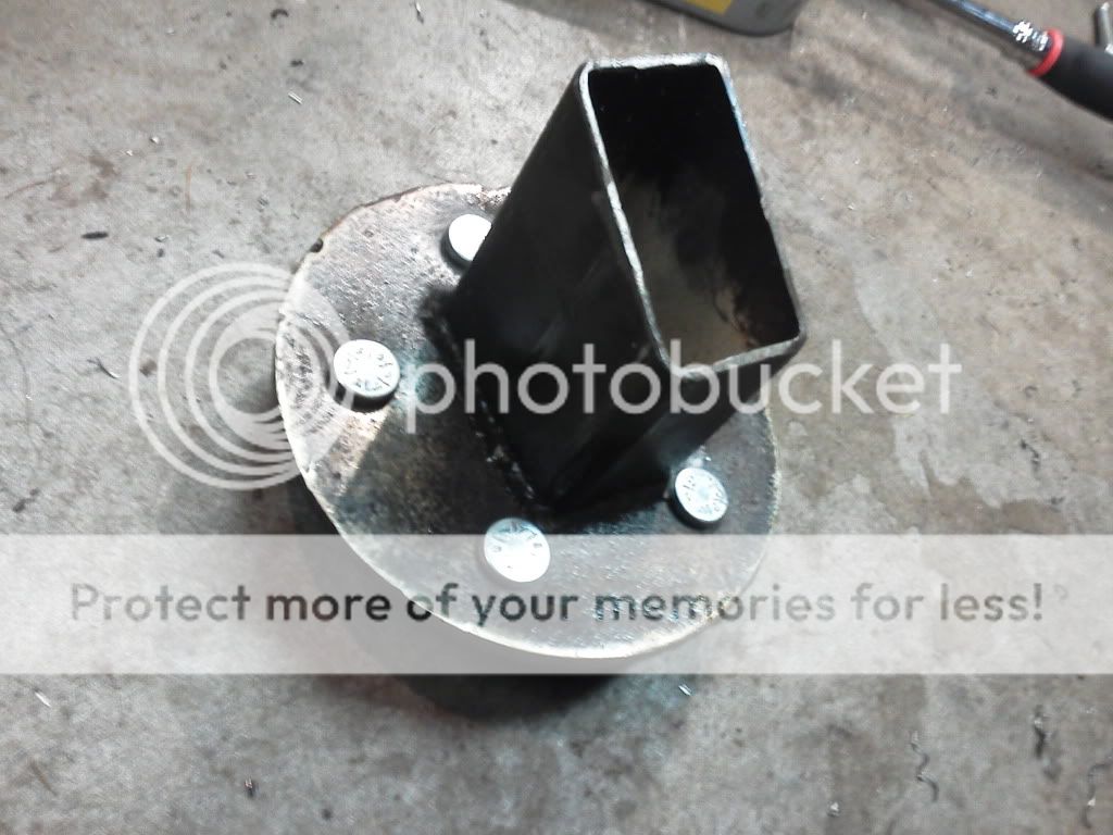

post #30 of 251 Old 02-25-2012, 09:48 PM Thread Starter
Hussler
1992 XJ Cherokee
Posts: 5,292

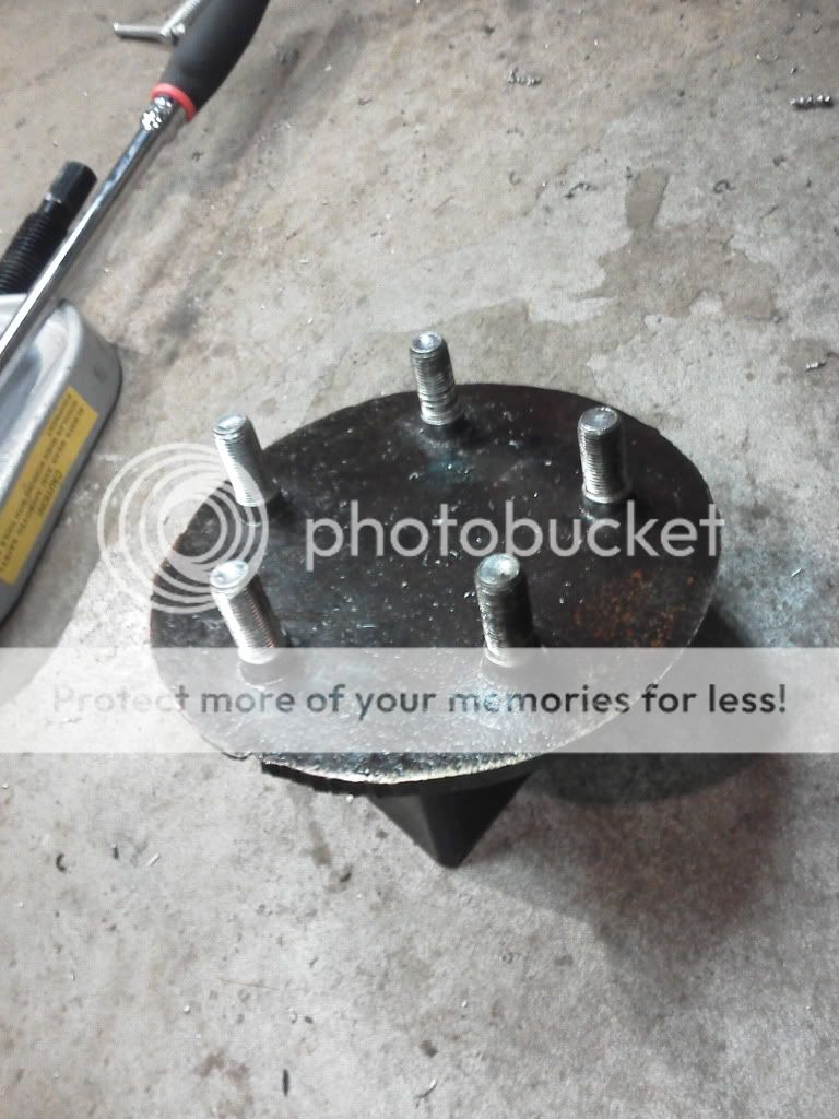

Heres the lugs pressed in, I'll weld it on tomorrow.
