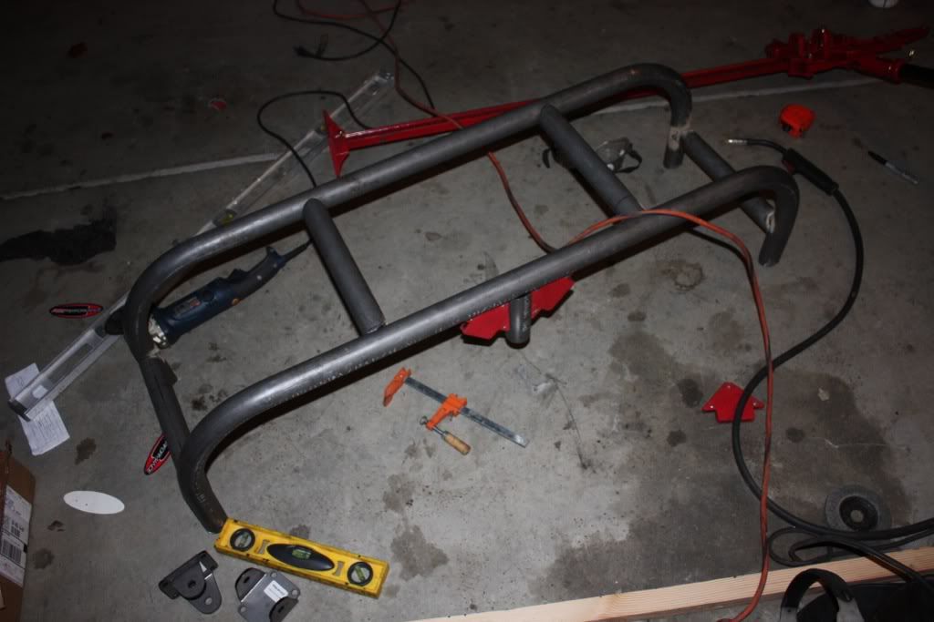

So, here is my version. I wanted to stay with tube, since when I bought my Jeep it already had tube bumpers and tubes on the rocker guards. I couldn't figure out how to get a spindle in the rear bumper, even after scowering through BESRKS threads! Got the idea from a tire carrier i saw on Genright... They want $800, I did mine for $250 (using DOM cause I had it, could have been less if I used ERW, or even pipe). Here is the progress...
Here are the parts. I used the cage tie in kit from synergy and the tire mount from A to Z...
I tried notching the tube with a hole saw, that didn't work so I borrowed a buddies notcher... So much easier!!!
My first iteration didn't work well because it is completely covering the lights!!!
I cut out the side bars and ended up with this...
This is where it stands now. I am in the process of adding a license plate frame in the middle. Maybe some gussets, and a hi-lift mount on the top tube.
... I guess I'm gonna have to fix that too…….

Thanks rinking! If you do, consider making the center straight part shorter and instead of going 90 degrees to the body make it like 75, you could probably add the side bars for added strength and still be able to see the lights. Also, I'd angle it up a few degrees.
Now I gotta find a couple Jerry cans, to see if they will fit along the sides of the tire.

I added some tabs for the plate and put a light from Genright on it…
I got all the stuff I need for a Hi Lift mount, but haven't had time to finish it up.

I thought I'd try to make a mount for the high lift… pretty simple, big bolts, some scrap from the notcher and a couple plates cut from my 2x4x.188 square tube…
Now just got to weld the notched pieces to the base plate, paint and coat with some rubber.

Hi-Lift done, for all intents and purposes… I may go back and cut the heads off the bolts and weld them in, but not for a while. I used a locking hitch pin to secure it. I was gonna us it on one of the ends, but it didn't provided enough clamping force to keep it from rattling.
