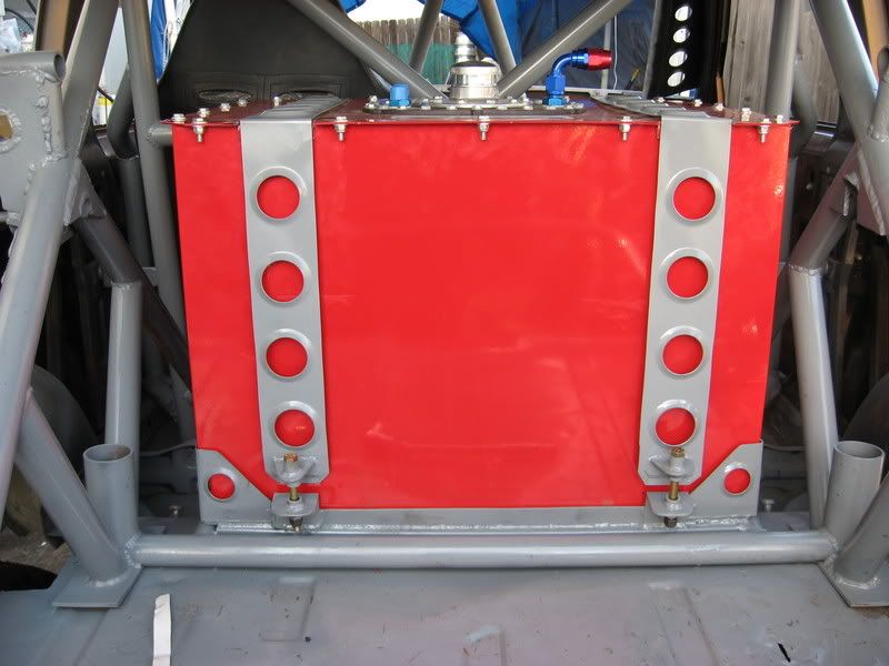

more rainy day fun this weekend, assembling all the fuel lines, pump and filter, and made the straps for the fuel cell, believe it or not those straps took me the good half of a day to make, 18-gauge cold roll.
Cheers

cell is in

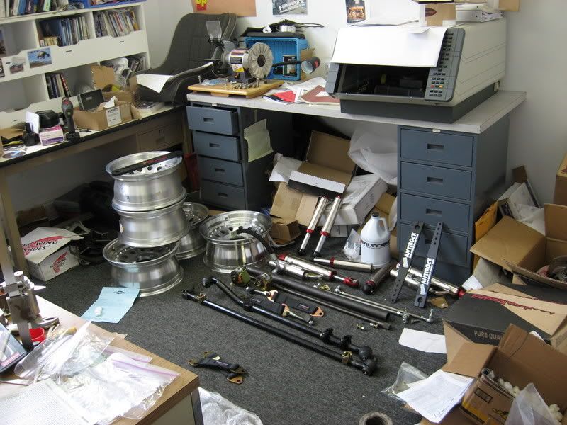

I'm working on it, really sucks having to work with all these parts cluttering up my office begging to be installed. broke a part of my tube bender this las weekend so i got the new part and am going in head first this coming weekend, gotta prepare for my 6 brand new Maxxis Bighorns to show up on the 9th, had to remove the front end and fab up some shock mounts, tons of small details to address:
doesn't really look like $4k+ worth of parts does it?
I wish my office looked like that!!!
