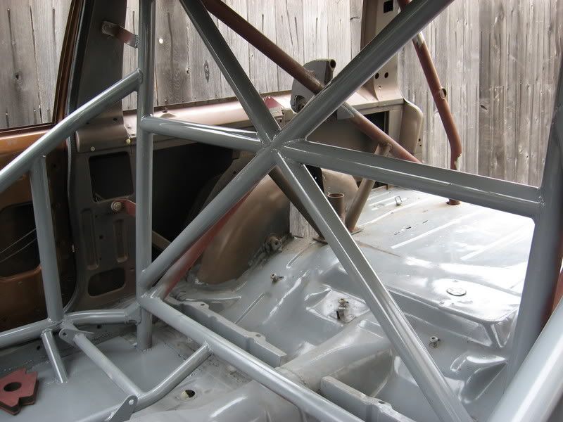

got the harness bars in and painted:
You need more triangulation...
I will feel pretty safe, although after hearing of the recent crash in Baja where a race truck tumbled at least 15 times end-over-end down a 700+ foot cliff and nobody was hurt, maybe I'll be taking a bit closer look at that cage design, even though the truck was not recoverable, the cage did it's job.
Your cages looks extremely stout, id feel plenty safe in that.. keep it up.

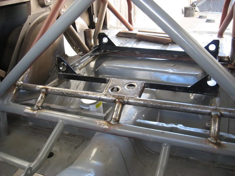

Thanks guys, For seats I have the Beard/Redart Ultra highback suspension seats, and for harnesses, RJS 5-points, and yes we will have a couple of easily accessible fire extinguishers and are looking into self contained halon suppression systems, we will also have some shears taped to the door bars to cut the window nets if they become to entangled to exit safely.
Got the fuel cell mount done this weekend, what a major pain, at least until I figured out a good way to attach it to the cage, I don't want anything in the cab that is not directly tied to the cage as there should be some movement between the cage and the cab portion, at least until I can gauge just how much relative movement there is:

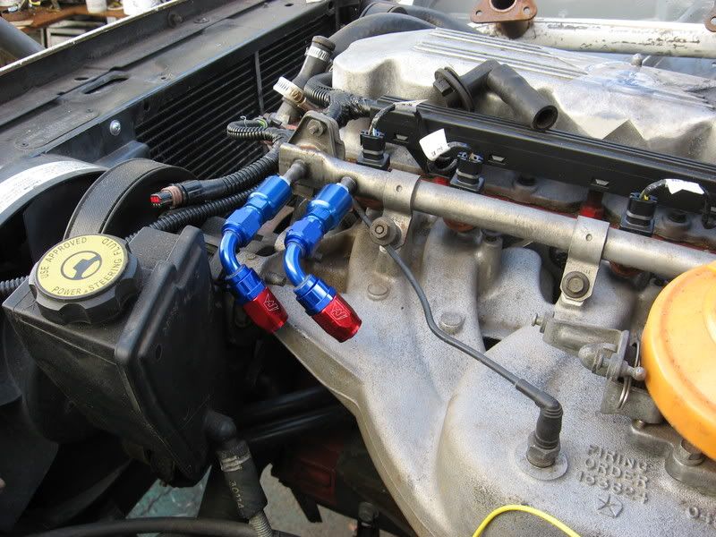

no spectacular updates as it has been rainy here, mostly cleaning out my garage at home so I can yank it over there and start installing all the high buck parts that are currently sitting on my office floor. I have a few hundred bucks worth of -AN fittings and stainless flex line etc for the fuel, waiting on the pump right now and working on plumbing the brakes, most of the metal fab is done until I can get the fresh air pumpers, oil/tranny/power steering coolers in there and build in the dual spare tire mounts, until then it is all wiring the gauges, the dual battery stuff, shift linkage, getting the seats and harnesses in, and also waiting on my 5.29 gear set, 35-spline spool, and the install kit for the ford 9" so I can set up the gears and get the driveshafts made. Lots of details to address!

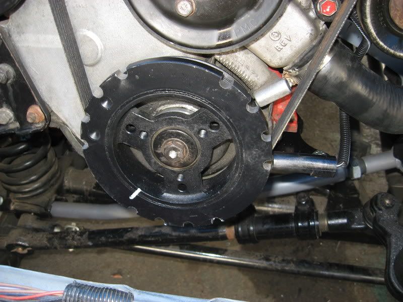

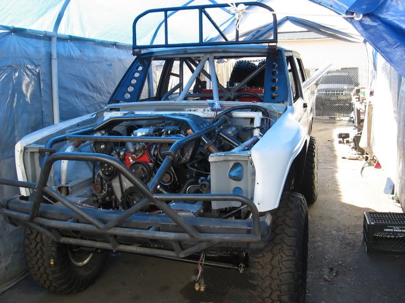

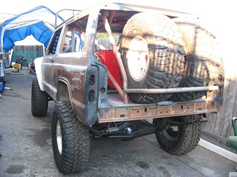

Got the radiator out and started the CPS relocation, it moves the sensor from the bellhousing to the harmonic balancer, looks pretty slick and should make life a bit easier, also started on the dual spare mounts and got the cell in and starting to route the hardlines for the fuel and the brakeline stuff should be here soon:
