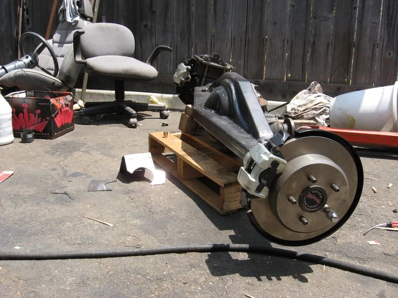

trussed the 35-spline 9" more and got the brakes on:

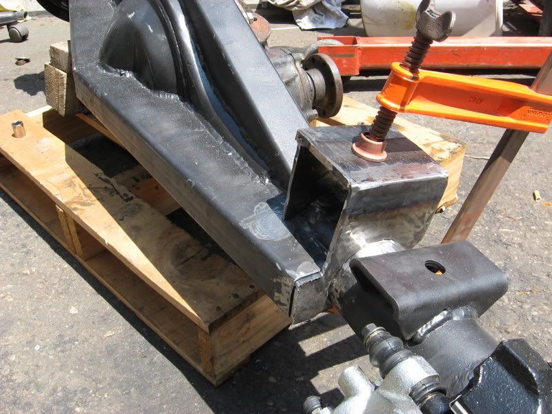

gusseted and burned on:

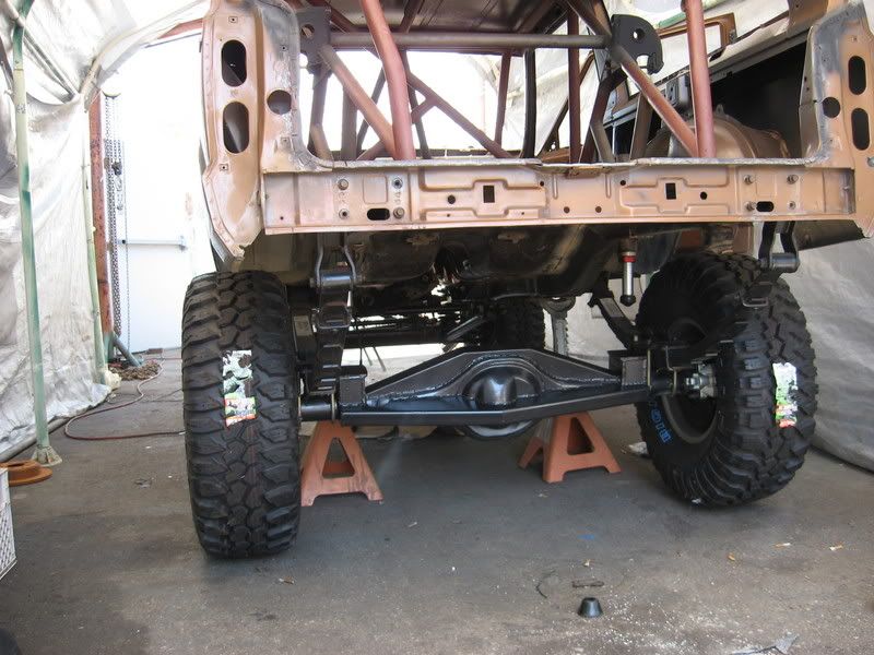

and its in:
close to full droop:
unweighted, will have two spares, two batteries, a floor jack, bag of tools and spare steering and driveshaft stuff, and around 32 gal of fuel to load it down a bit more.

Umm, maybe im missing something but did you weld that diff closed? I see no way into it. If so I hope you got the right gears in there and gave them a good testing . OR Maybe I have just been grinding too long today?
Scotch740 is offline   Reply With Quote
Old 08-06-2007, 09:03 PM   #69
Bigbob
Bigbob's Avatar
Join Date: Jul 2005
Location: Bakersfield
Posts: 3,196
It's a Ford 9". LOL Those come sealed and welded from the factory.
Hint, ya gotta look at the other side! Now, get back to grinding.
HAHA, ok. Makes more sense now. I didn't think someone would weld up an axle but I have never seen a 9" in person before.
