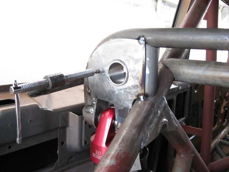

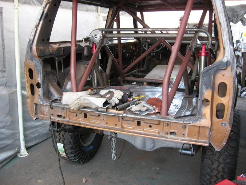

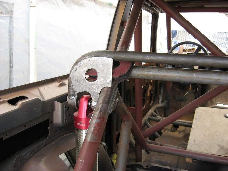

got a little done but not happy with any of it, still figuring things out, a few of my ideas, i keep thinking i am making this way to complicated but don't want to skimp on anything, suggestions?

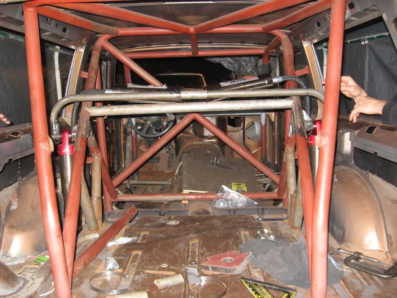

updated shock mounts, finally done:
front clip and rad/support done:

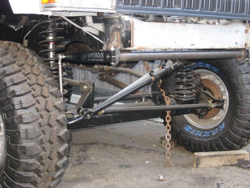

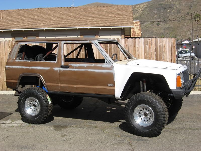

got the anti-rock mounted up, back to work:

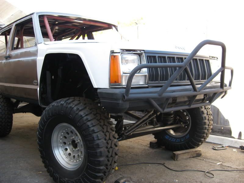

one more:

How do you guys mount the front bumper additions?
"'Did you ever wonder why we had to run for shelter when the promise of a brave new world unfurled beneath a clear blue sky? "
Roger Waters
Matt Gertsch is offline   Reply With Quote
Old 07-02-2007, 11:54 AM   #57
skullver
Tarpitz
1991 XJ Cherokee
Join Date: Jan 2007
Location: Ventura, Carp, La Conchita, CA
Posts: 973
the front clip is completely boxed with 3/16" plate, i then welded the bumper in 3 places to the front clip using 1.5"x.120" dom tubing and some 1/8" plate with holes for rosettes, it is going to have a small skid to protect my steering and sway bar that will tie into the stock sway bar mount, it will then be welded to the front engine cage by the steering box bolts, and finally it will be connected to the mid hoop in the engine bay with more removable flanges making the center engine cage removable, and with some work, the bumper itself. jeepspeed rules say you have to have the stock bumper in there somewhere, or a readily available aftermarket bumper which there is no way I will pay for.

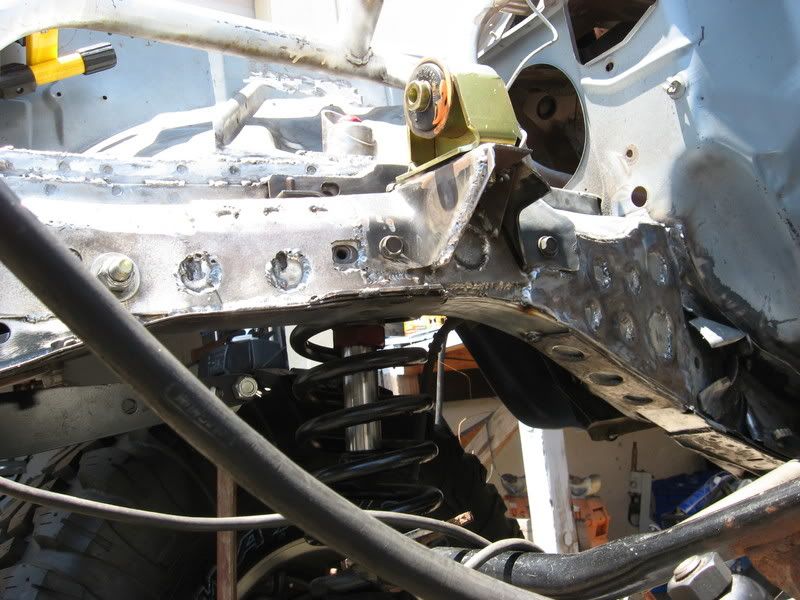

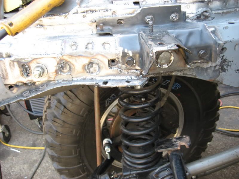

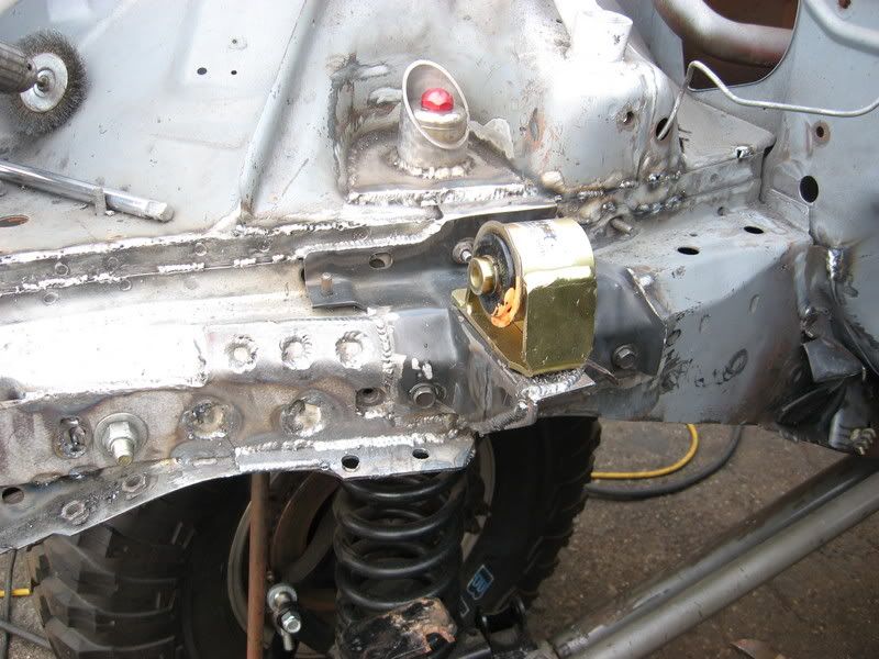

got some of the motor mount area done, got a bit more to do before final placement of the motor:

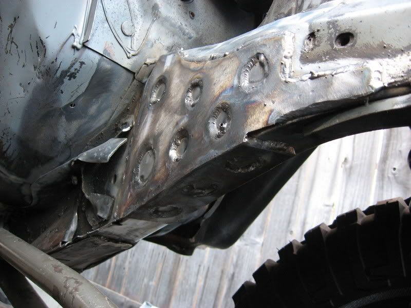

some more plating:

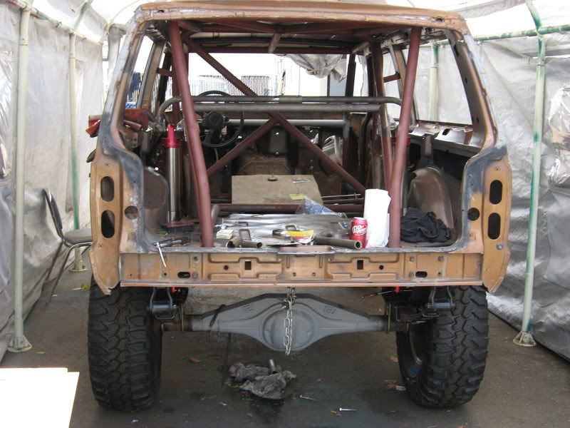

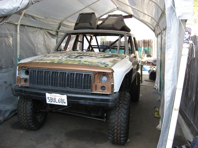

almost done:
