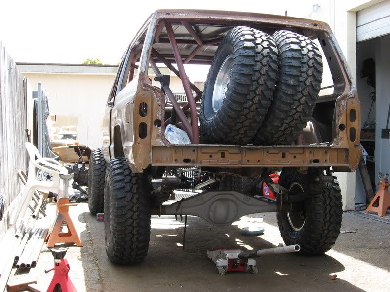

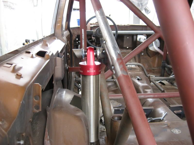

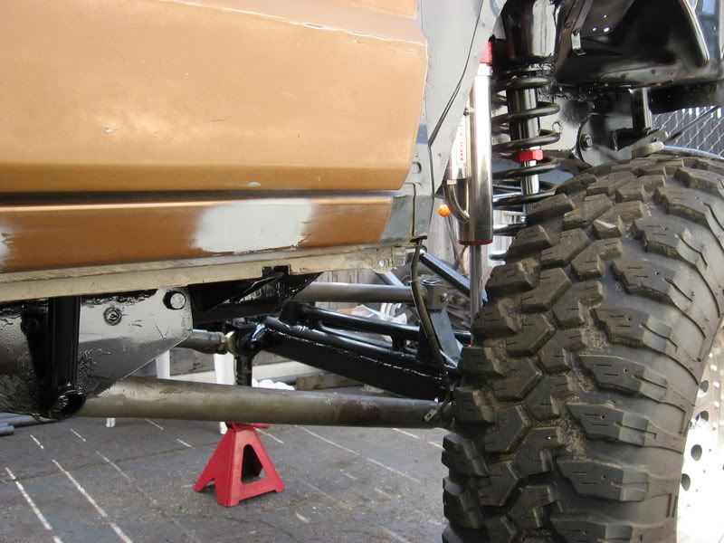

got a little done, had a hell of a time with the bumpstops, had to get a cylinder hone to bore the cans out after they shrunk...again, shock mounts were a pain, limit strap mounts/swaybar mounts, tons of little details, still got a bunch of tuning/cycling to do for limit straps and front lower bumpstops:

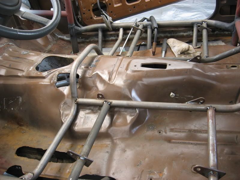

Thanks guys, almost cut this thing into a million pieces out of frustration, too many three handed jobs and usually only my one free hand, what a major PITFA, most of my time was spent creatively stacking blocks and shims so I could test fit the seat placement in the horiz/vertical, and adjust the rake front to back, bending tubes of different sizes and configurations trying to get the seat in a decent place with the transfer case hump impeding massively into the driver side seat area, $75 wasted tubing, multiple burns and abrasions, a million cuss words and a few childish temper tantrums later got half of a seat in, the rest of the seat mounts will be a piece of cake now, my project and I are not speaking for a few days though, taking a break before I burn out completely.

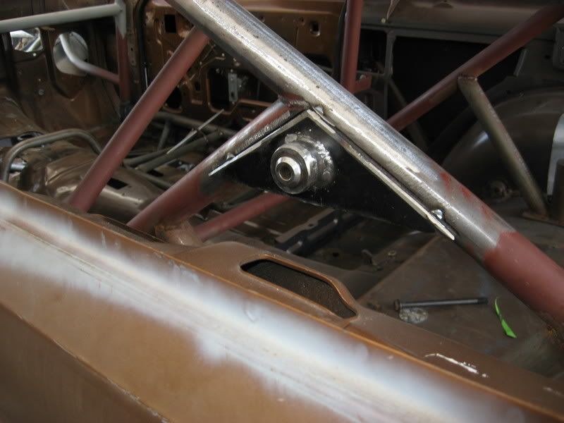

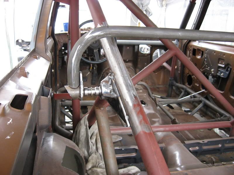

after a lot of thinking I decided to shine going to C.O.R.R race and locked myself in the shop, got one half of a shock mount almost done:shaking:, no helpers so everything took twice as long, not to mention a whole bunch of head scratching and ideas that didn't pan out, I'm pretty happy with how they are turning out, gotta go make sure I am still married

looks great, are you planning on putting another support on the top of the mount to make it a double sheer as opposed to single sheer?

Thanks a bunch, definitely double shear, I bent up a piece of 1.25"x.120 dom in a 180*and will add two pieces for the outer mount and then plate in the whole shebang, may do some trick dimple die plating but we'll see.

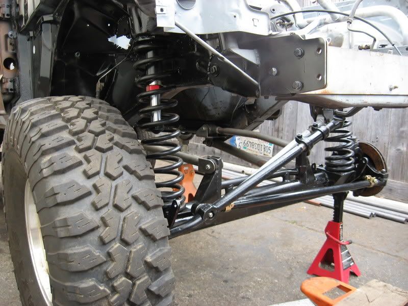

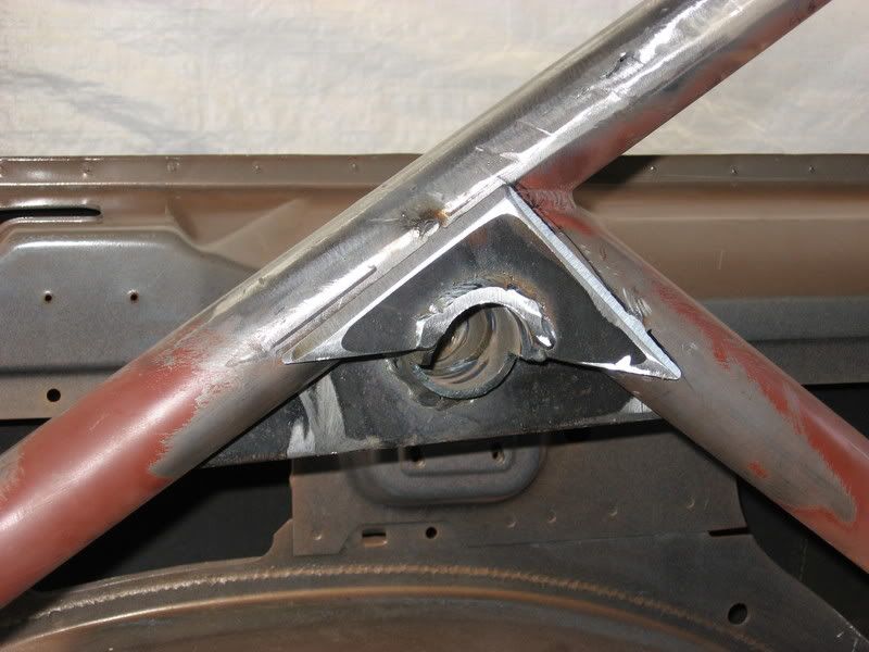

start of the outer mounts:
