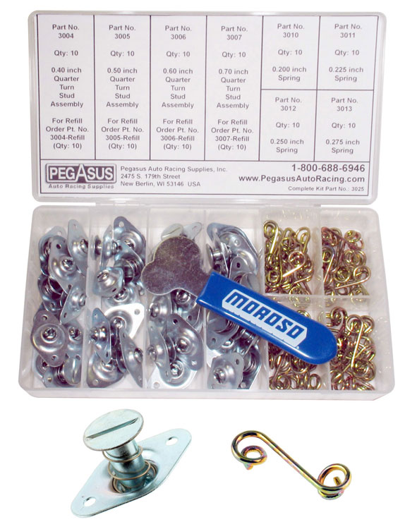

Either way for access through your panels, I would say either hinge one side and use Dzus fasterners on teh other side, or Dzus all teh way around...
This is a dzus btw... and you can open them with a flat-tip, or quarter, or anything else wide and flat... That is what is used to hold Sprint Car bodies onto the frame becuase they hold tight, even with massive vibrations, and are super quick to get on/off...
