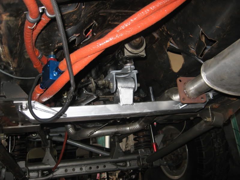

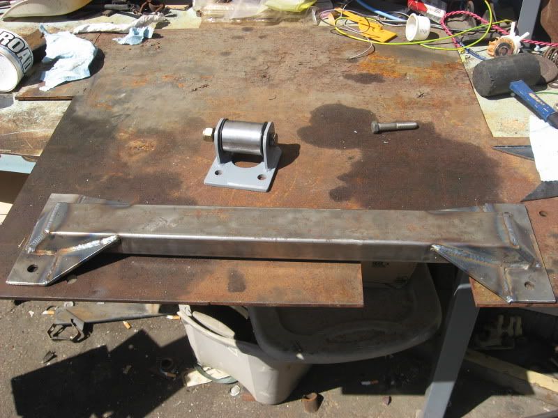

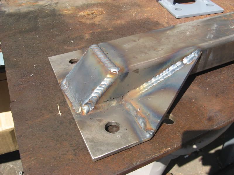

4wd would entail me matching the gear ratio in the 9" rear, so the hpd30 had to go as you can only go as deep as 4.88, and that is not enough. I am hopefully picking up a d44 next weekend to start working on, so then we will be able to run 4wd. It does add a bit more weight and really would only be necessary on a few of the courses, the majority would be ran in 2wd.
After pulling the aw4/231 and putting in the 904, I am amazed at the weight difference. I can lift the tf904 myself, while the aw4/231 is way hard to lift with even two guys, I'll see if I can weight them one day for reference but it is WAY lighter. The VSS from the AW4 popped right in and the gears even mesh for the speed sensor...something I wasn't expecting. Next thing is take apart the rear spring packs again and cycle it really well so we can get a new driveshaft, resecure all the fluid lines, then we are off!
new crossmember:
