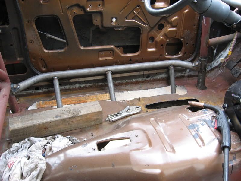

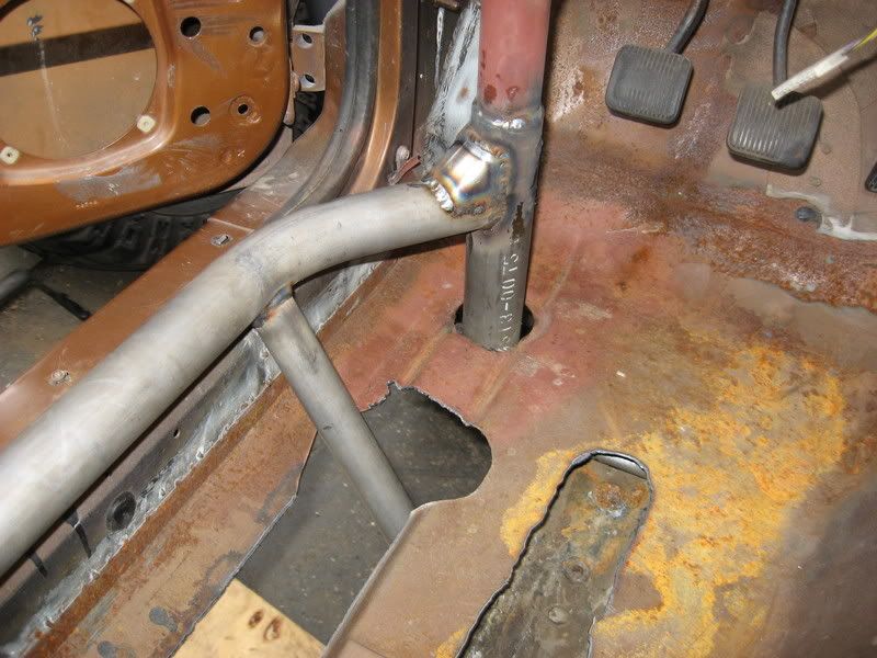

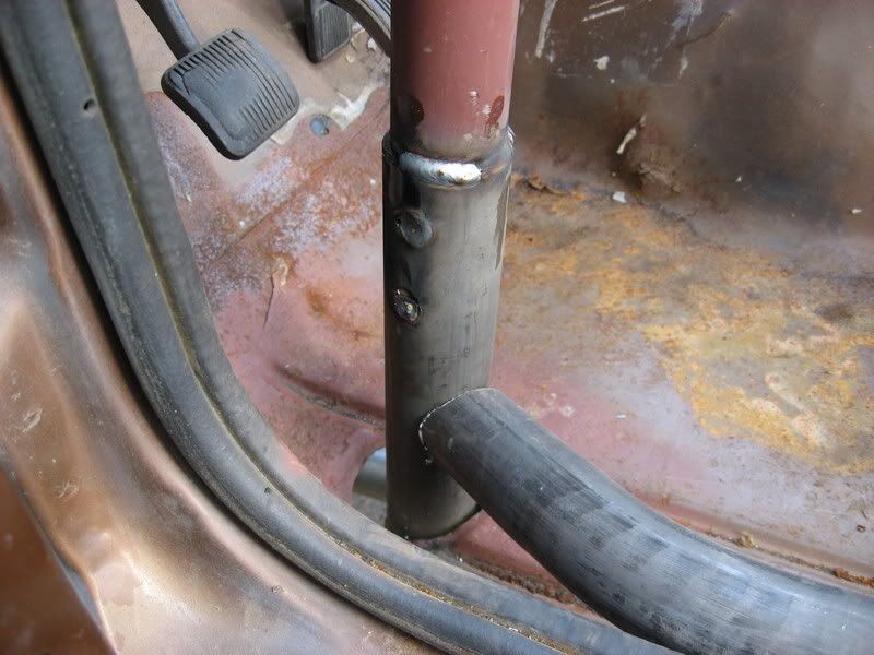

Well this part has been "bugging" me for a while and I finally dove in head first, we originally had the cage built long ago when we had no idea what suspension we would end up with so the original tie-ins had to be relocated slightly, sleeved with 2"/.120 DOM:
seat mounting, psnger/driver shell starting:
a little extra gusseting, had to plasma a bunch of access panels to relocate the xmember as it used to be a 2.5L and they did not line up with the tranny:
still going to add more triangulation possibly, and some strategic plating, I am starting to think I may be overbuilding this thing, may be really heavy but we'll see I guess:

clickity click - great build up man and i dont believe you can OVER build a rig haha
