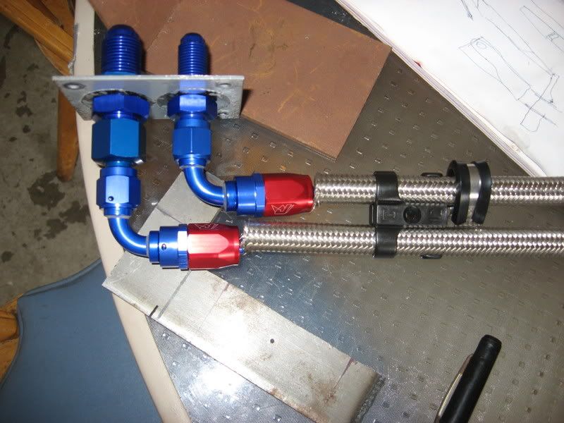

sorry about that, lots of small non-photogenic stuff going on, the laborious task of putting it all back together and triple checking clearances, decided I hated the hard line in the fuel system and went to all -an fittings and stainless braided(just have to assemble the hoses). Also finished up my removable track bar brace and the center console is taking shape, I still have to add tabs to make it removable and make a hole for the battery selector switch and emergency power off. Should get lots done this weekend as I'll have a few helpers.
cheers
bulkhead and fittings for the floor, 90* go to motor

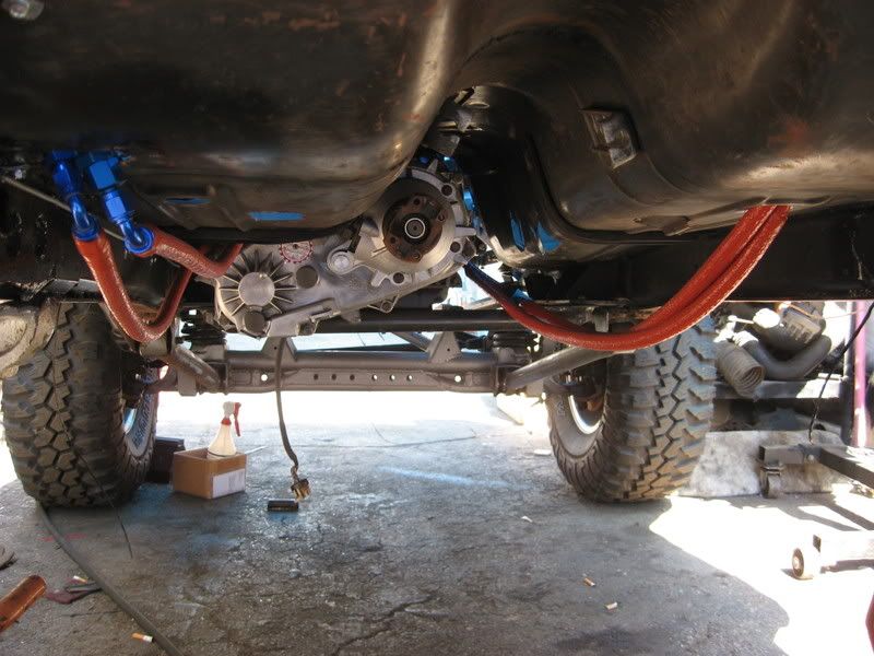

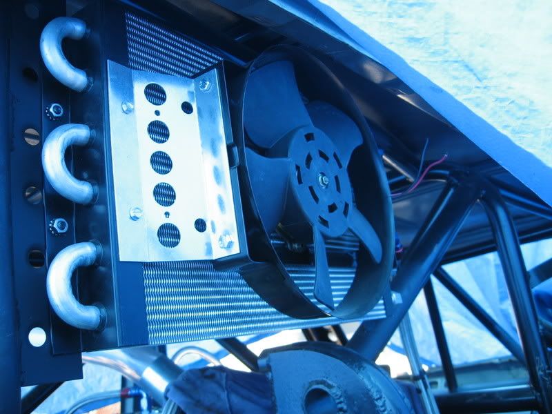

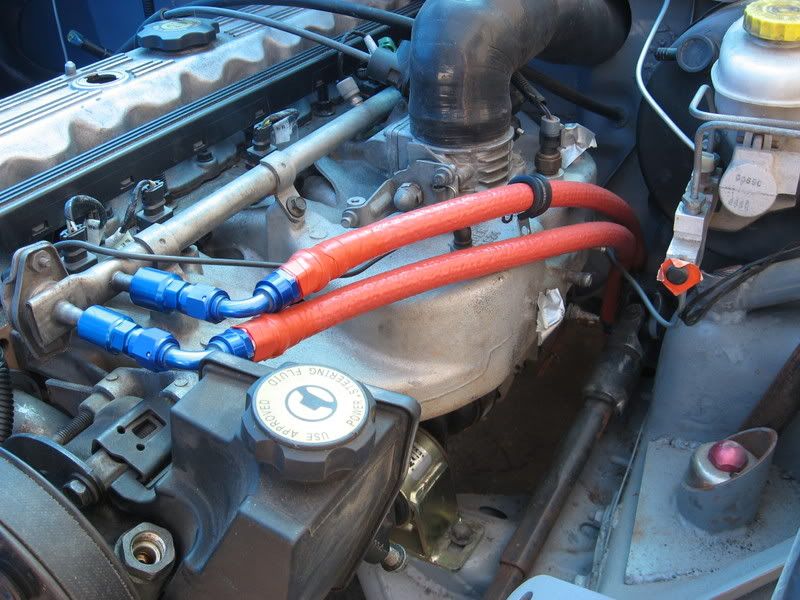

Thanks guys! Been working 6 full days a week for a while now so the jeepspeed is very neglected right now, had a chance yesterday to do some more plumbing, firesleeving, mounted and plumbed the trans cooler(sorry for the crappy pic, I have a tarp over the truck right now). I got the driveshaft and hopefully won't have to work this Sat so I can actually put in a full day on the truck. I swear if I had one complete week to work on the truck it would be done, but with my family and work schedule 7 days of working on the truck means 7-weeks for me
On to the pics:
still have to secure them obviously
fire sleeving;
cooler:
some shaft:
