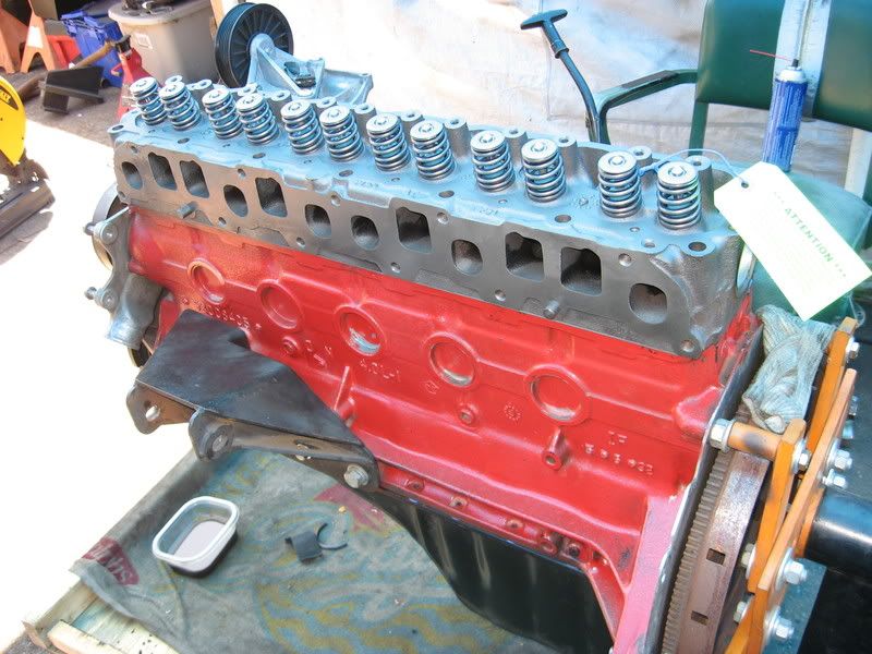

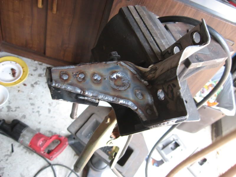

Been really busy with work but found some time to knock some stuff out. The motor is all apart and getting disassembled right now, just waiting on a cylinder head, thing is going to run like new or better. It will be running very soon!!!

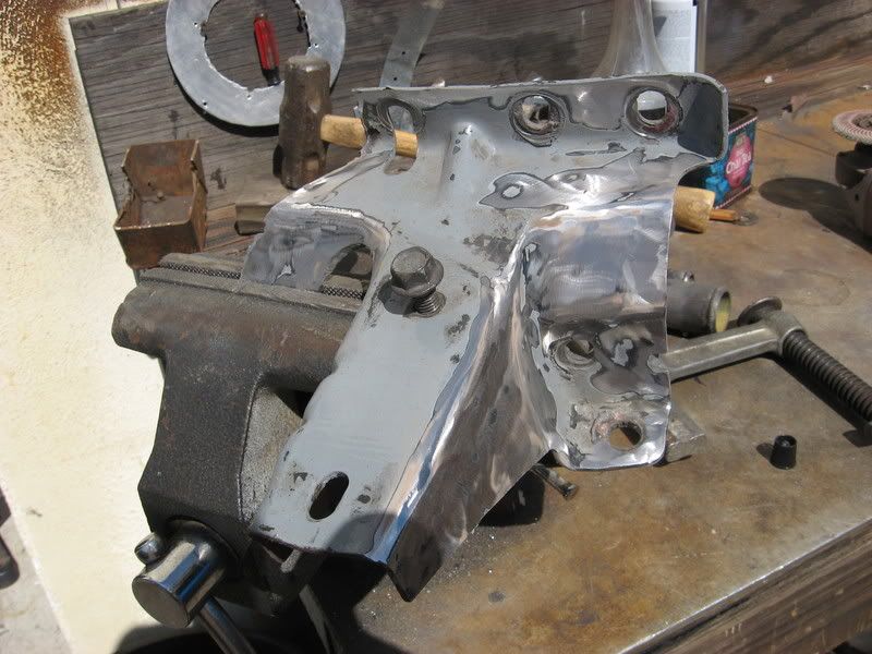

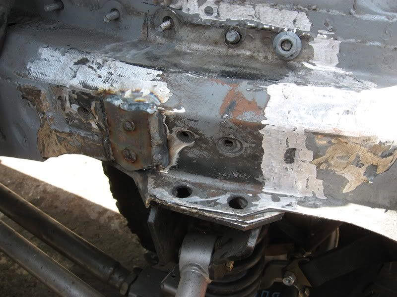

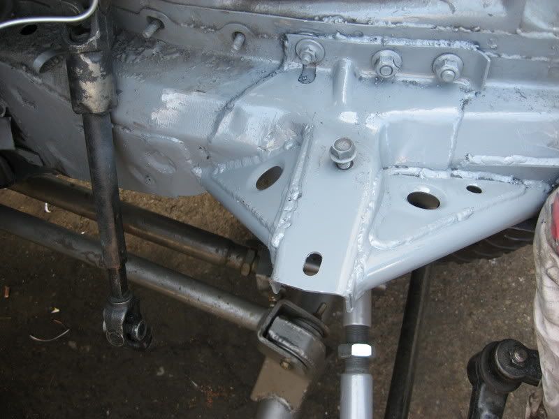

Finally tackled the driver side motor mount, it took me two days to think about it, cut out little pieces to box everything etc etc. That side is most likely to fail from the loading conditions as the trackbar mount is attached to the motor mount, as the trackbar pushes the uni-rails out the motor mount stretches and being as there is a dimple right at the most stressed portion to allow for clearance of the steering shaft, it is almost guaranteed to fail at one point or another if not addressed, I don't think I will ever have a problem with that anymore.

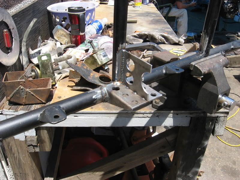

Thanks much! lots of practice, all different positions/thickness...and most important meticulous prep, the cleaner it is and the better the fit, the easier to weld..generally. Sometimes it is just so hard to get comfortable in certain circumstances, I have tons of scars all over from slag while upside down, falling everywhere, yes, everywhere you can imagine! I have finally learned to just keep welding through it, of course having a buddy ready with a fire extinguisher and wet towels is a must

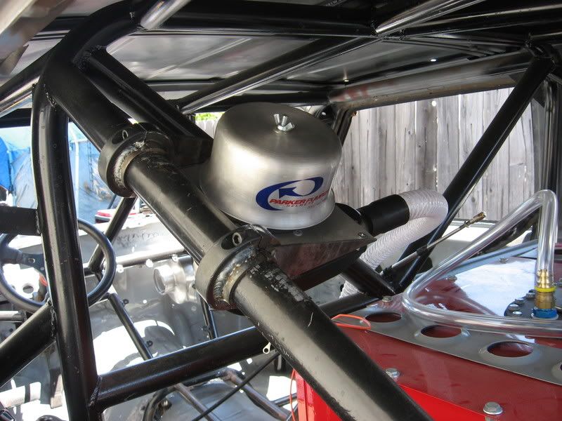

Got the mounts done for the driver side fresh air pumper and moving on to the trans cooler, may mount it on the ceiling and cut a duct, or maybe the side windows but we'll see how it turns out. Brand new cylinder head showed up and it should be back together by monday

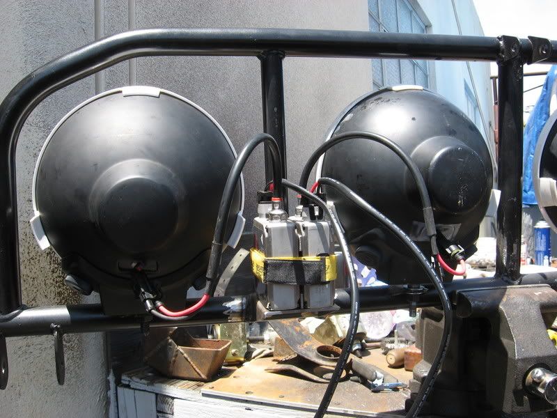

a few more pics:
buttoning up small details like ballast mounts for the (4) 9" Hella 4000 HIDS

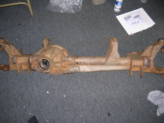

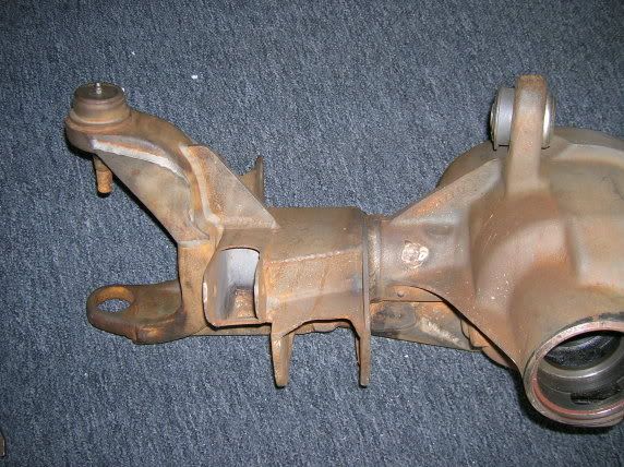

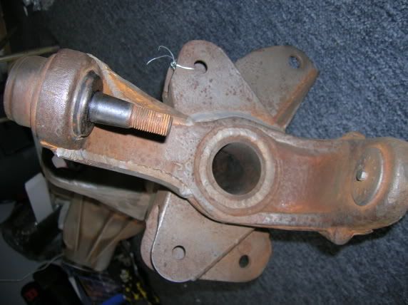

Oh we have a 4wd front end all right, completely chromolly and heli-arc welded throughout, built by famous fabricator/racer Kurt LeDuc, should be some pics of it earlier in the thread.
edit, here you go:
