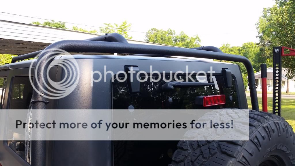

Well after going back and forth for almost a year I finally broke down and got a rack. It was between Gobi, Garvin or Rugged Ridge Shepard. I though I liked Gobi till I looked at it on a few different Jeeps and was really turned off I know it is a quality product but not of my liking. The Garvin Expedition rack was another great option, my father had one on his TJ and it was nice but the square tubing just would not look right with the accessories I already have. So I took a chance and got the Rugged Ridge rack, primary reason was I like the windshield mount, the majority of people who had it like it and I want a one of a kind rack no one had any really good option for building one from scratch so I figured buy a sturdy frame and have a custom basket built.

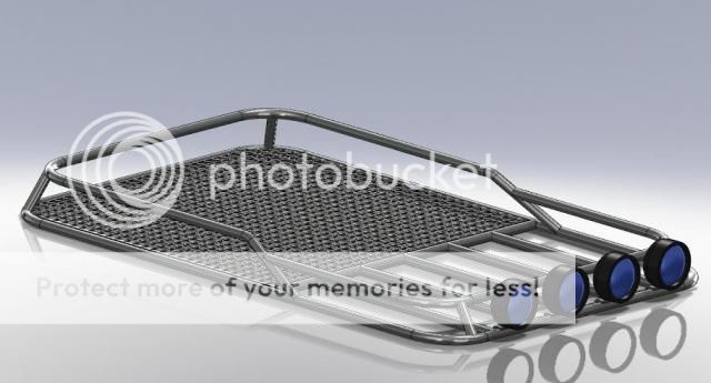

Got a basic design drawn up. Most likely it will change but here is some of what I am looking at building. For weight reduction I am going to try and have this build from aluminum. End goal for the rack is to be primarily for expedition runs.
Over all concept will be a tubular basket frame, same diameter as the rack itself I might go a bit smaller just have to see what is available for materials.
The basket will use the current load bars that is on the rack, plan is for the load bars to run as shown with the floor of the basket attached to them.
The license plate will be counter sank into the frame by about 1/2".
The frame.
Load bar is at a little bit of an angle, the header bad mount was not welded properly Rugged Ridge is sending me another one.
From Rugged Ridge web site.
Overall I really like the design of this rack, it is a little more sturdy than I expected, I think if I can have the basket built from aluminum it will be fine.

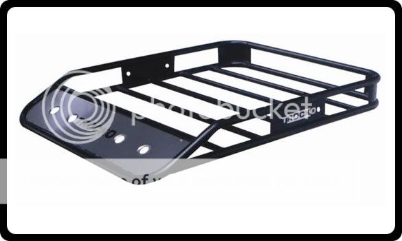

I stole these pictures from random google searches but something like this..
I like the first photo better as the base of the rack is wider than the top. If I was to go with this design I would do away with the load bearing bars. Load bearing bars are the bars that run front to rear.
I would have the basket attacked directly to the rear bar:
and just use the pre existing mounts on the windshield mount.
But like I said the air gap you see between the load bars and the hard top is 4" with a soft top it is only 1". So I can go any lower than the bottom of the load bar. However I plan on the basket being wider at the base than the roof of the Jeep. Kind of like the first basket pictured, but bring the sides down where it is wider than the Jeep to hide the air gap but still allowing for use with both top and not interfering with any thing like doors. This would also act as a light weight slider for the roof should I tip over into a tree again...

Little more done.. Got good start anyway.

Close to done got to change the angle of the front so an Air Dam will fit on it and all sat.
