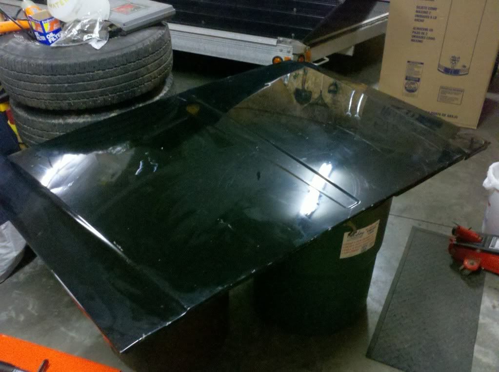

started with a stock hood
did a straight cut a foot on each side, then a cut following the body line.

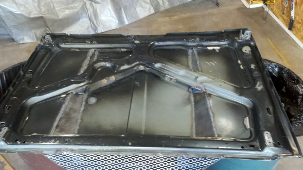

tacked in some metal after a spacer the was 3 inches high and made a cardboard template
welded in some supports

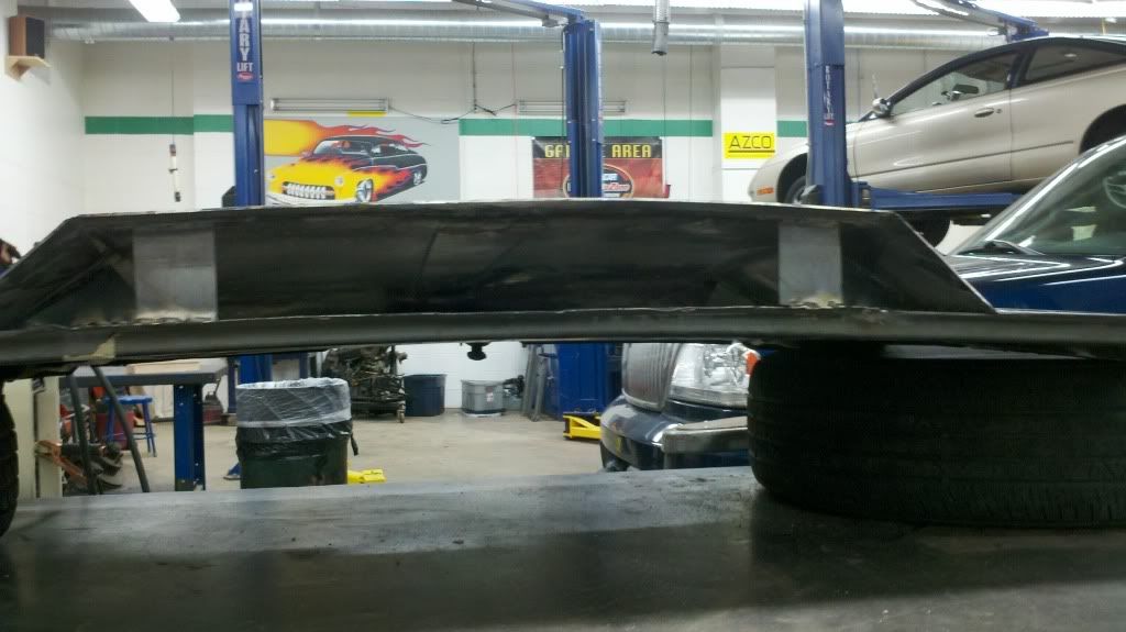

added in an inch and a half piece of metal on the back of the cowl

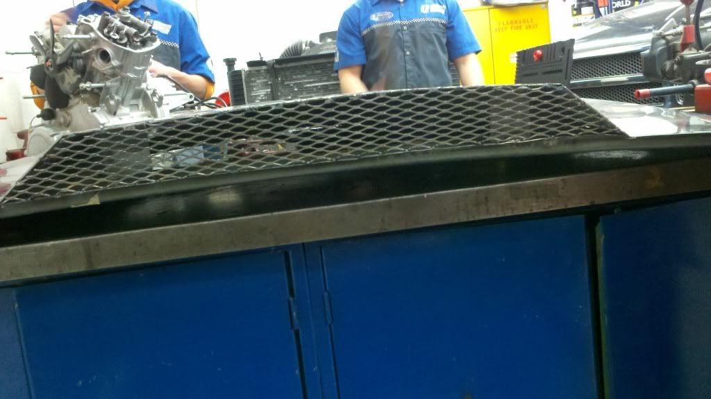

added in some metal grating to keep crap from falling in my hood.

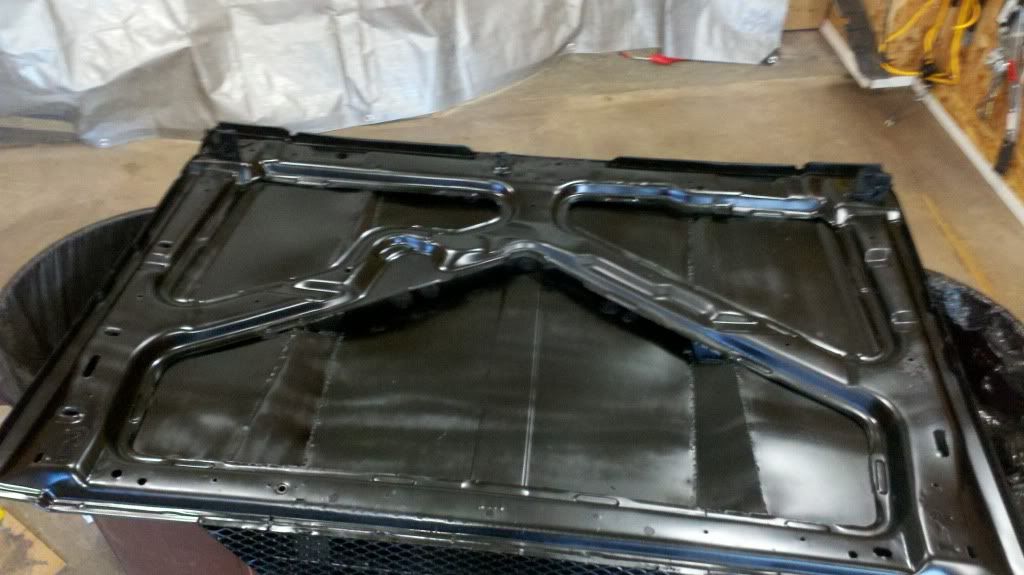

primed and painted the underside to protect the welds and to make it look nicer
now im just filling in some of the heat warping, stay tuned, should be done soon

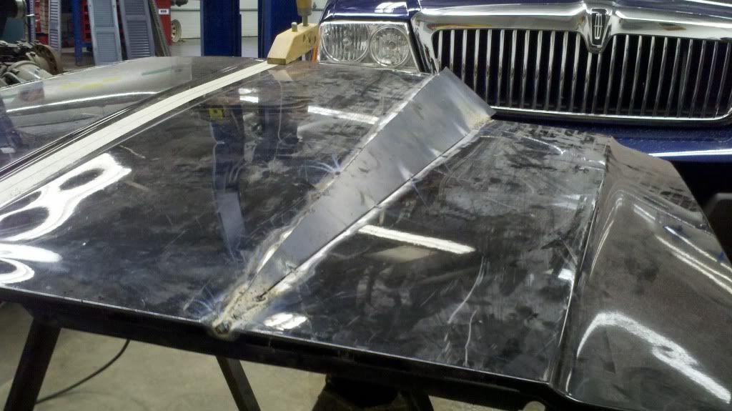

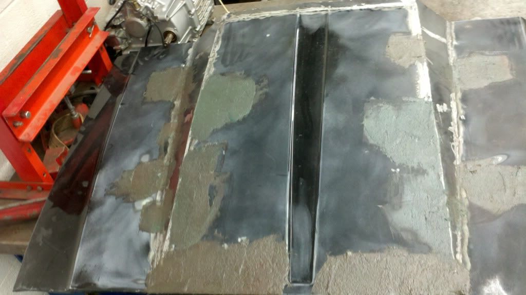

More everglass and bondo
2012 Response vehicle
burtha95xj is offline
post #10 of 28 Old 04-29-2012, 03:23 PM Thread Starter
burtha95xj
Location: menasha
Posts: 220
6 coats of bondo and sanding later, ready for some glazing puddy, should be sending it off to get painted some time this week

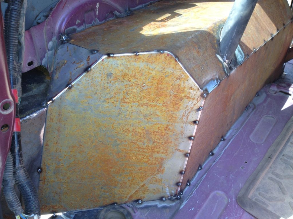

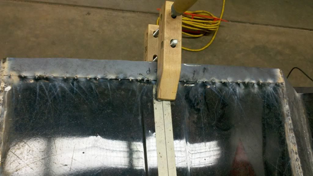

Here's a tip for warping, when doing a project like this, place tack welds an inch or so apart. Then on the opposite side place a tack between each on the other side. Grind them smooth and bondo the seam.
The entire seam doesn't need to be welded. You can but you need to do small tack welds while jumping around. Basically dont weld next to a tack/area that's not completely cooled.
Here's an example of the tack welds (note, a few more still need to be added.)
My work, http://www.virtualjeepclub.com/showthread.php?70963-JW-Fabrication&highlight=Jwfabrication
