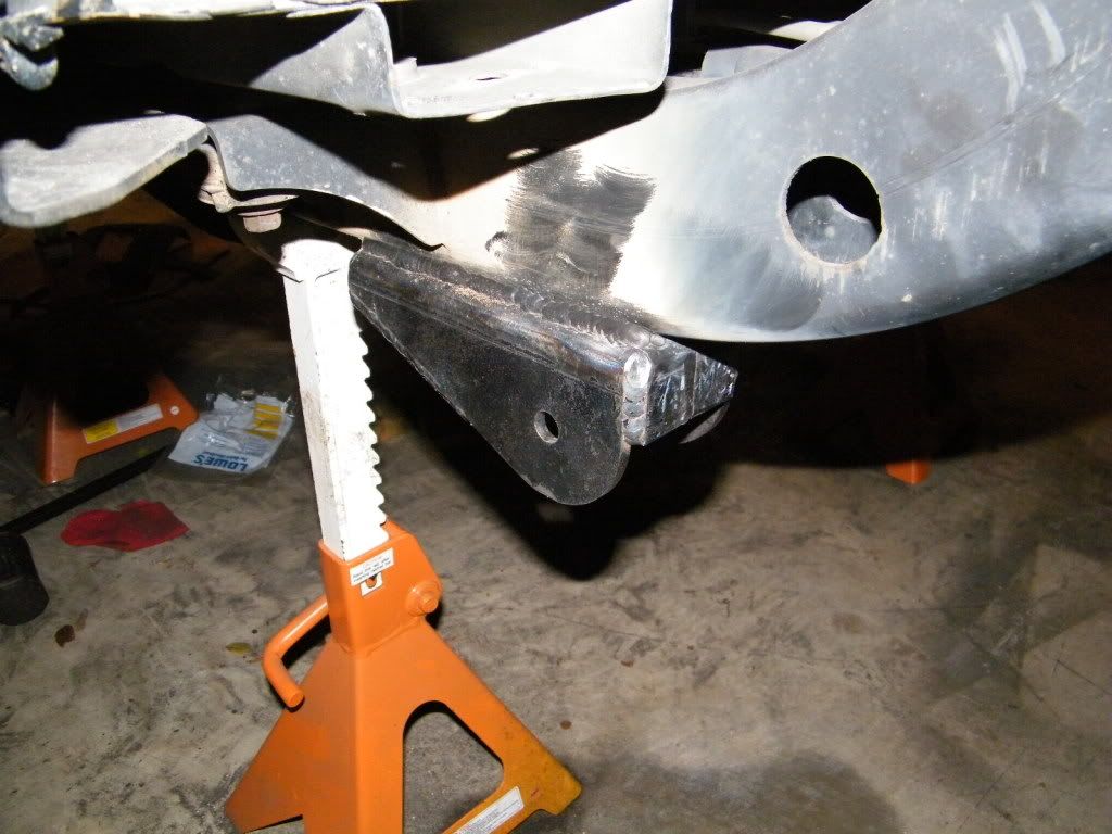

I built this with my HH140 on 0.035" flux core wire:
Those spring perches you speak of were used on the rear of my Jeep. Turn the heat all the way up, play with wire speed and go slowly. Make a second or even third pass if you want to make sure it's not going anywhere.
