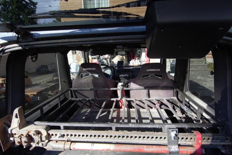

Like this?

I thought you asked about ideas for a cargo rack for the back seat area. I'm really surprised it didn't turn up with a forum title search for "cargo rack", "back seat rack", or "cargo area", since all those words are in the thread title. And this is only offered as an idea for you, to be used, modified, or discarded. Your choice.
It works great. Cheap, clean, simple, and stores away with a minimum of fuss. Could easily be made with your 1x1 square tube. U-bolts through the tube on the side, plywood and cross-tubes bolted through the top/bottom. Got access to a welder? Even simpler, as the tubes could all welded together on 90 angles and provide a flat 360 surface to mount the plywood.
