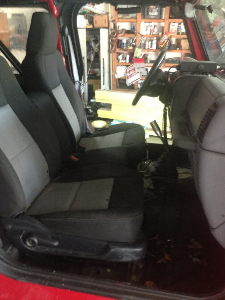

Just a few pics from the test fit.
Ill snap a few pics in the morning of the actually mounted. I got red and black seat covers for them.
