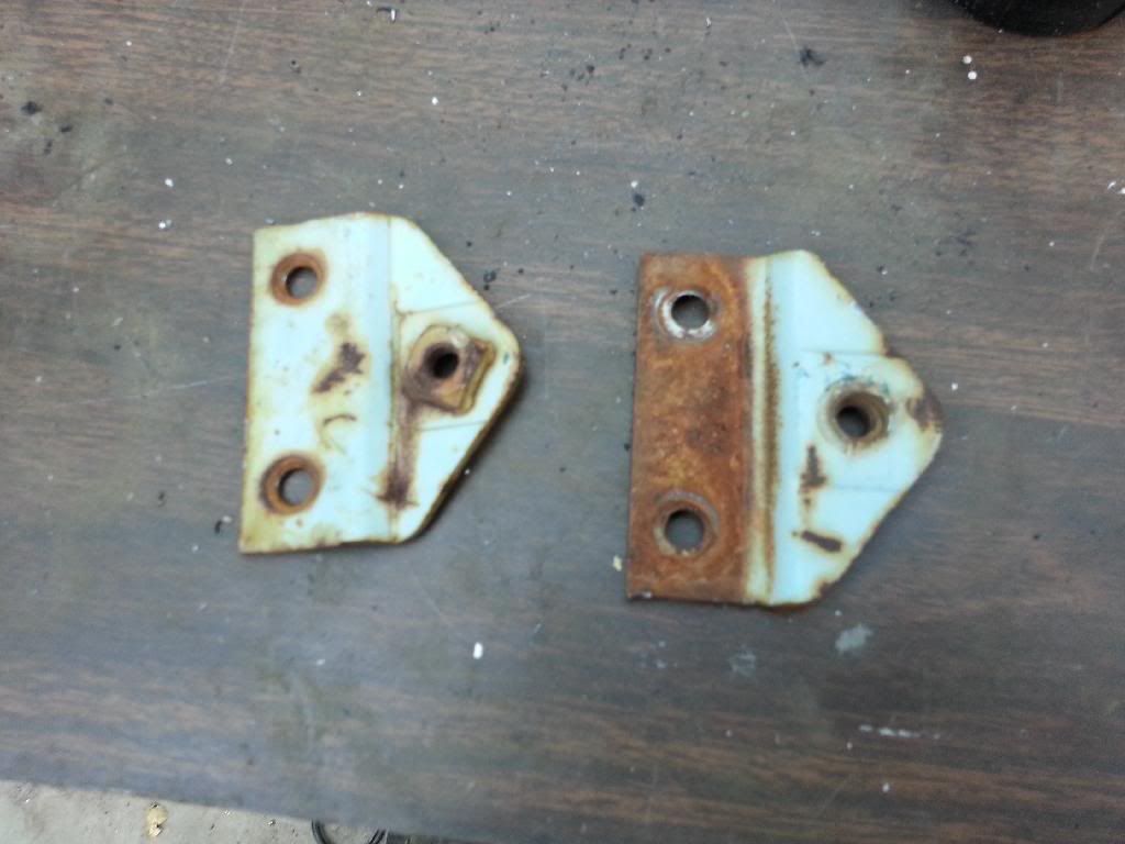

i got my cj tailgate cable brackets
planning on mounting them like this guy
does anyone see any problem doing this? I figured cjs came like this and many truck beds are attatched on the side like this so i figured it would look pretty good. This guy just used self tapping screws but id like to use some nutserts that i already have laying around. Never used nutserts so it think ill give it a go. I might use them for the hinges as well instead of dropping the tailgate.
