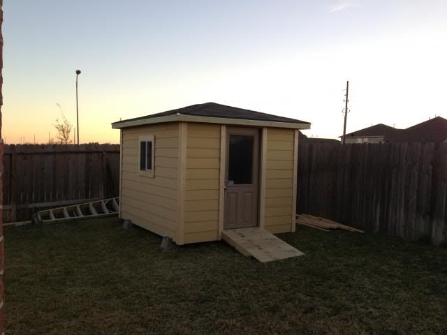

I had an 8x10 built. I went that route for the same reasons you mentioned....just didn't like anything anyone makes.
Ours was built on a small slope using concrete block to level it off the ground.
I actually wanted a concrete slab poured for it, but we could not because the easement was so large (14') that it would've put the shed in the middle of that section of yard.
The "hip style" roof was more difficult to build, but it looks nicer than a basic gable style.
We used the original back door from the house. My wife wanted a full glass back door, so it made it easy to do both at the same time. I did not want a DIY plywood door on the shed. They start off nice, but never end that way. They will always sag. I didn't want the headache. Bottom line, I would definitely suggest buying a real exterior prehung door for your shed. An added benefit is that you can lock it using regular house keys.
Picture is before painting it to match the house. We built a flower bed along the front (window side) and door side to dress it up and hide the elevation change and concrete blocks.

Great idea on the door, I was thinking of using a door that slides to the side (think minivan) so that if i needed to I could park a lawn tractor or ATV in the shed when i wasn't using it.
Also-That roof is great.. do you think it was cheaper/less material to build vs a gable roof? I don't mind the extra work if mine comes out looking that cool and saves a few bucks.

I like your door idea. I just wanted something that sealed the best it possibly could. The widest thing I had to push in there was the push lawn mower, but a lawn tractor or ATV would definitely require something wider and custom.
I doubt it was any cheaper to build. I would say the materials required were similar to what would be needed for a gable, but it was more work to construct...not hard, just more work.
